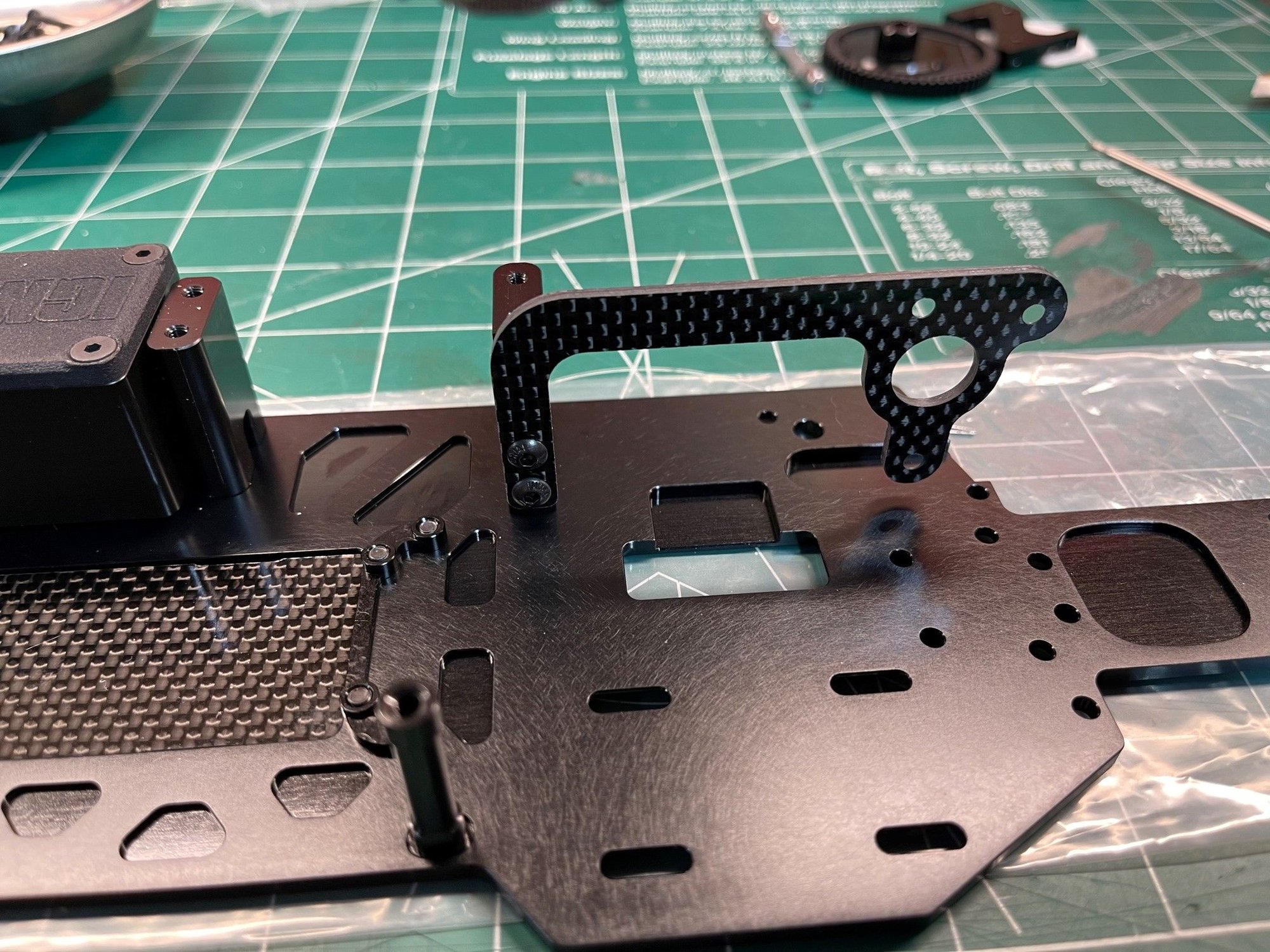

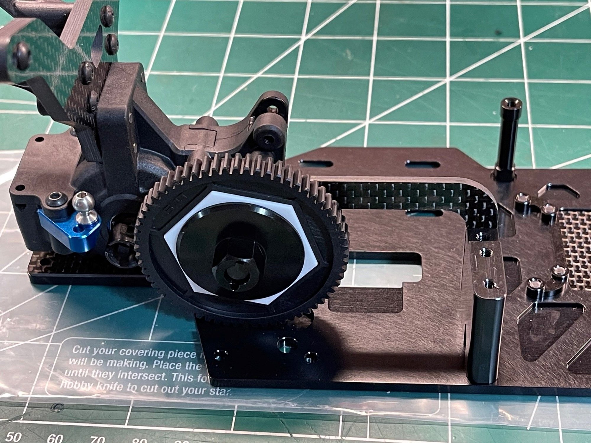

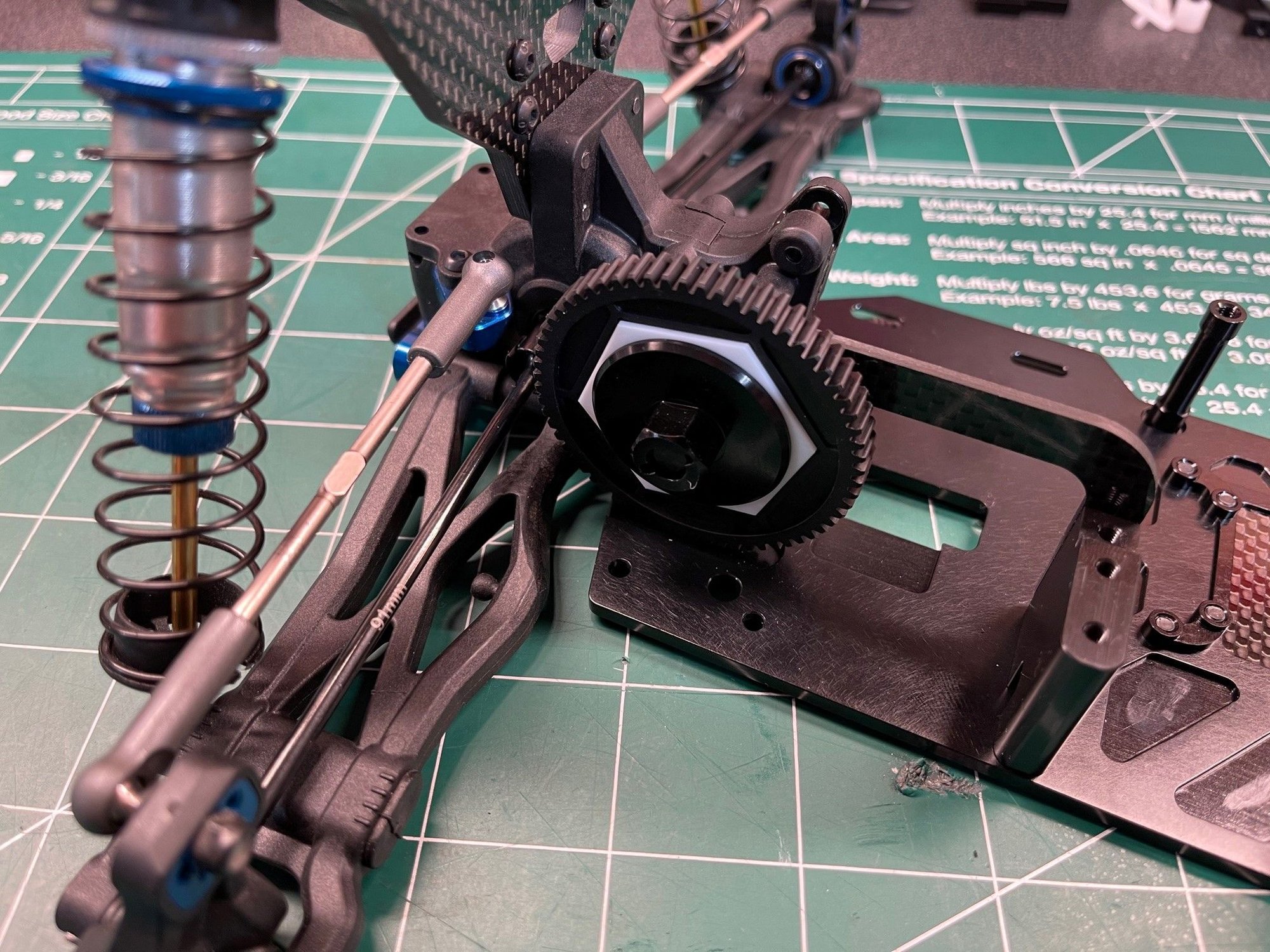

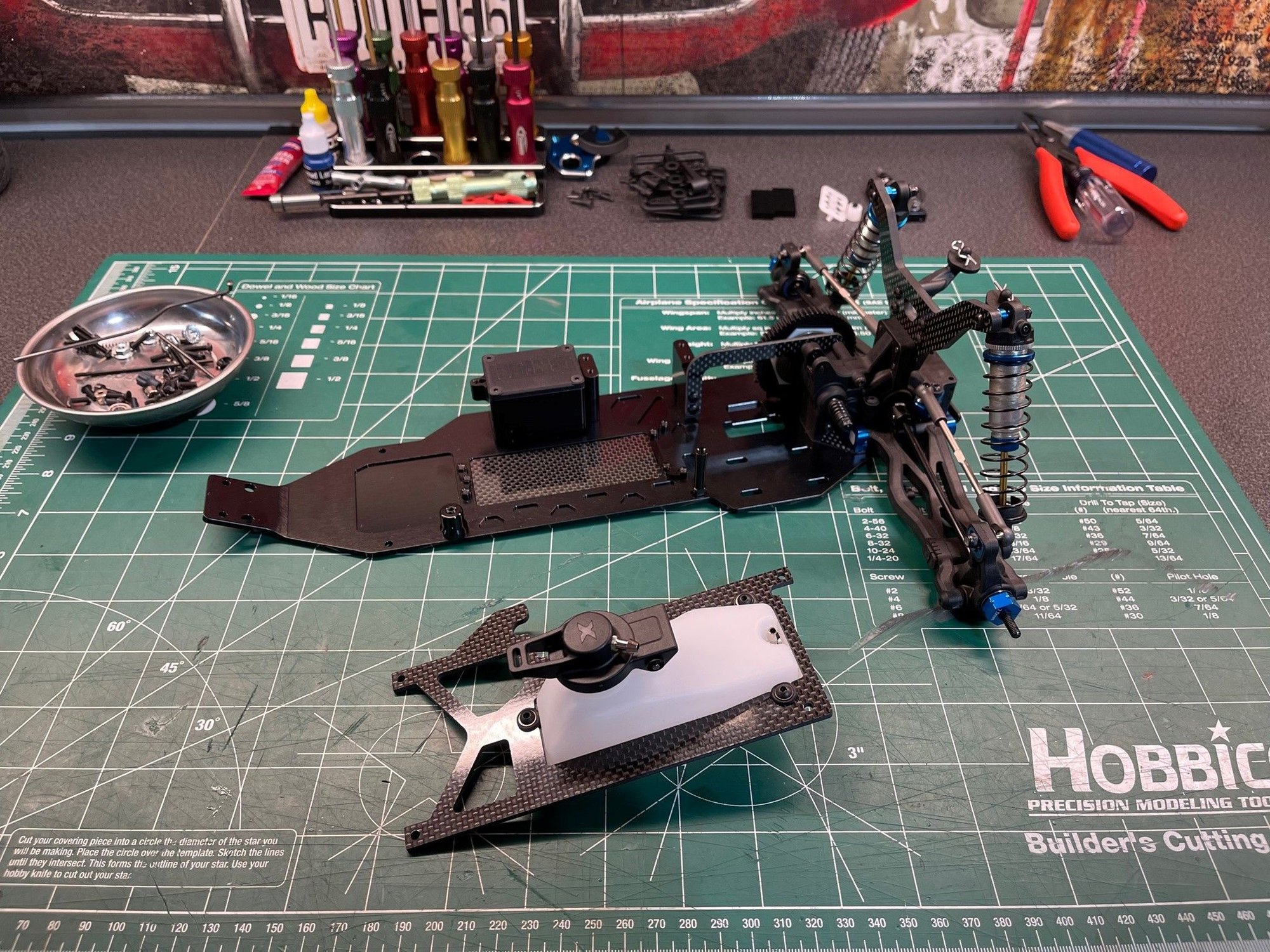

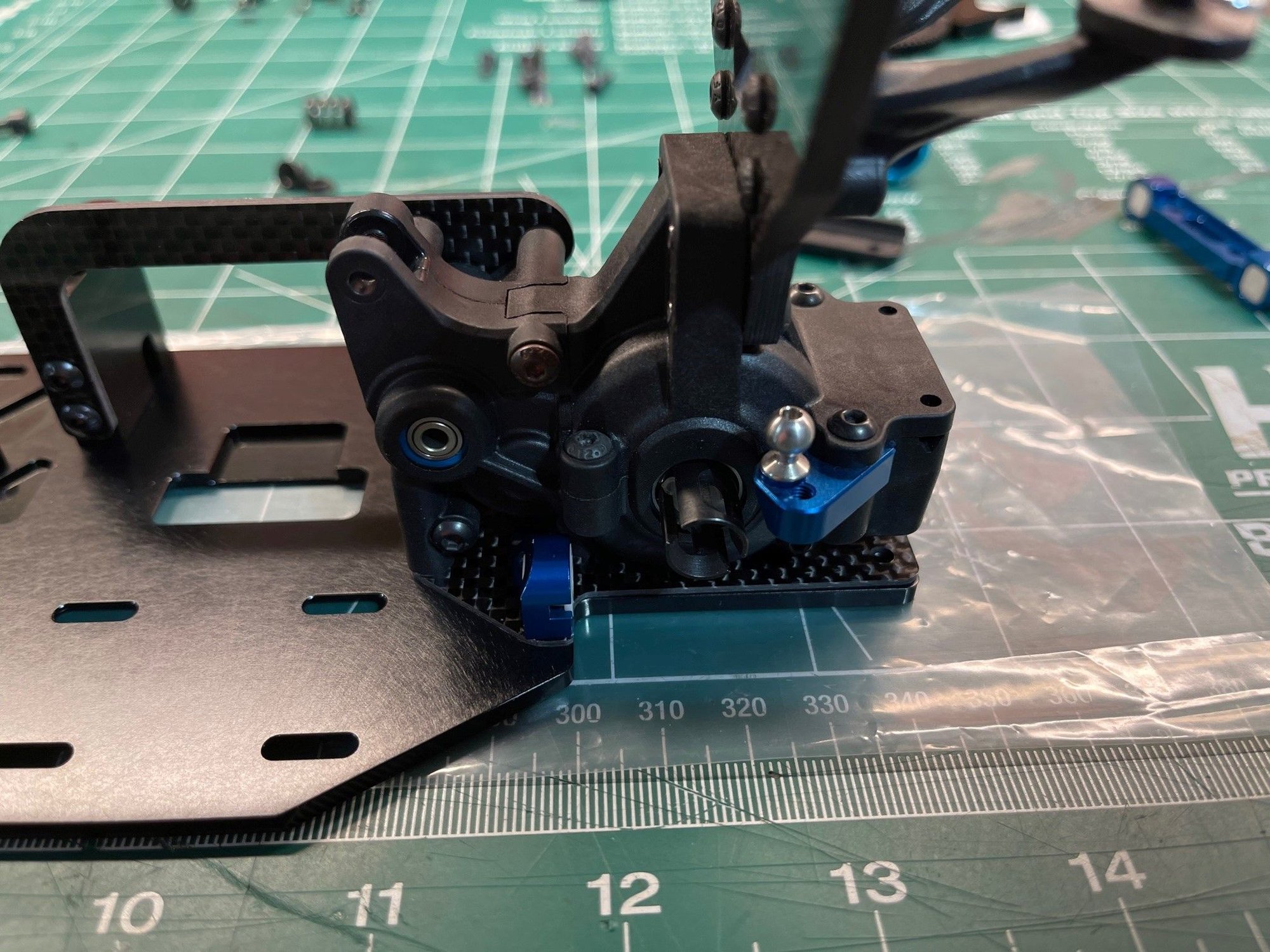

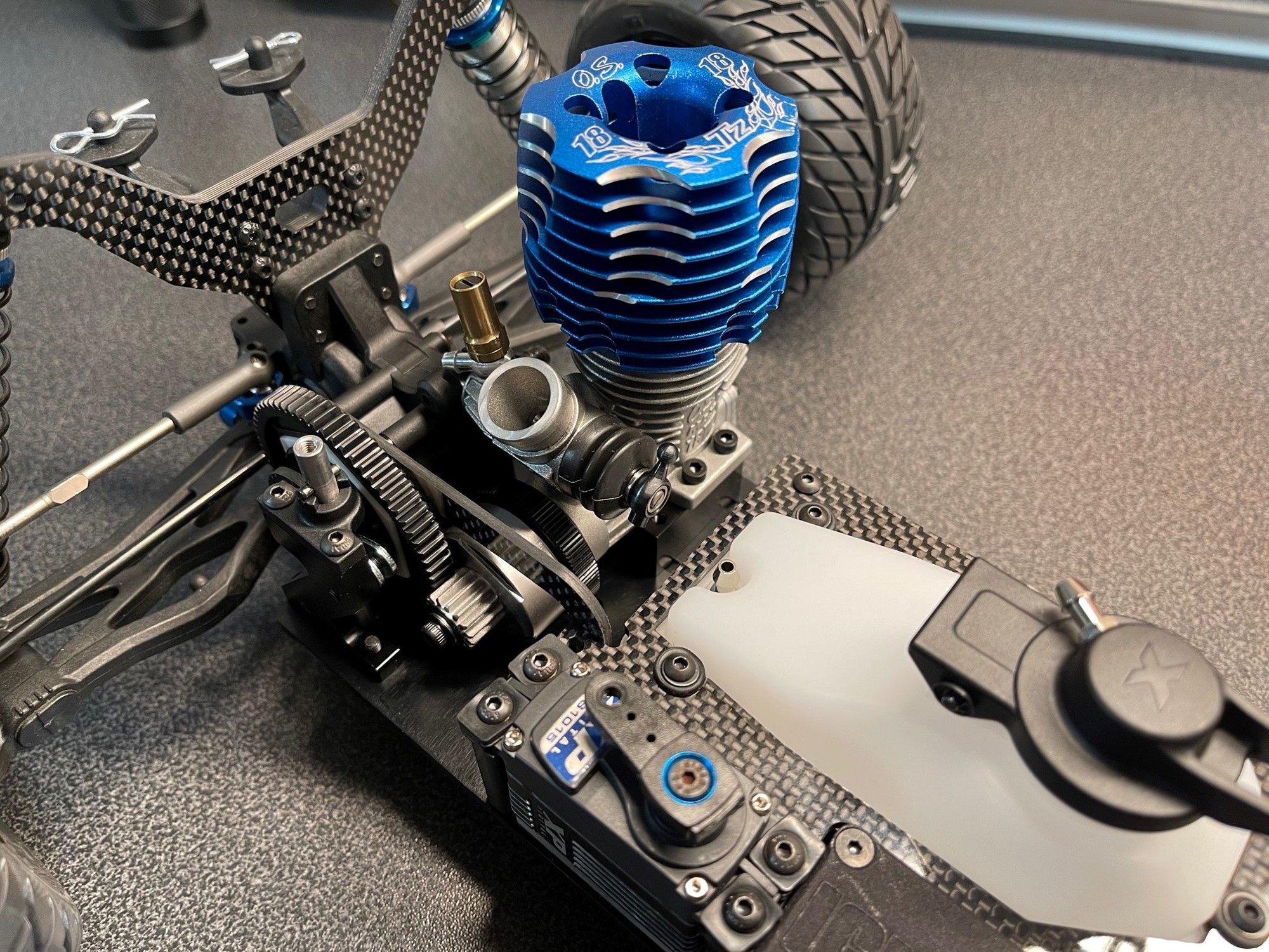

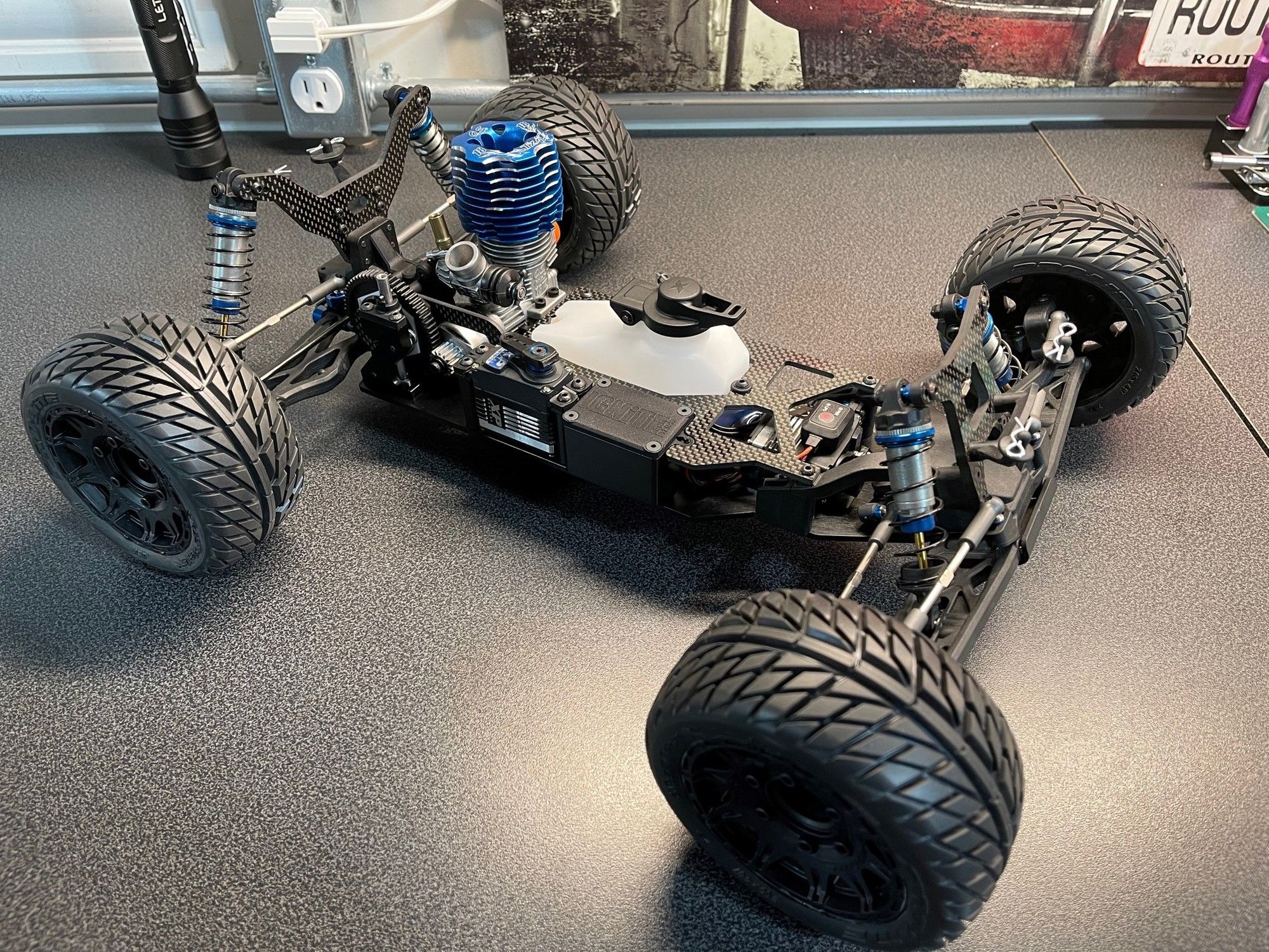

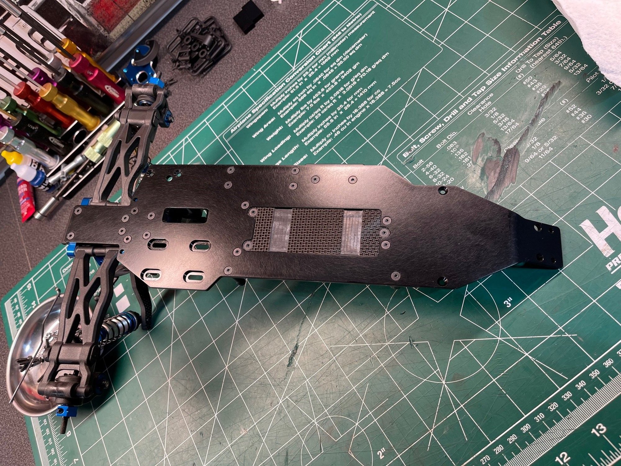

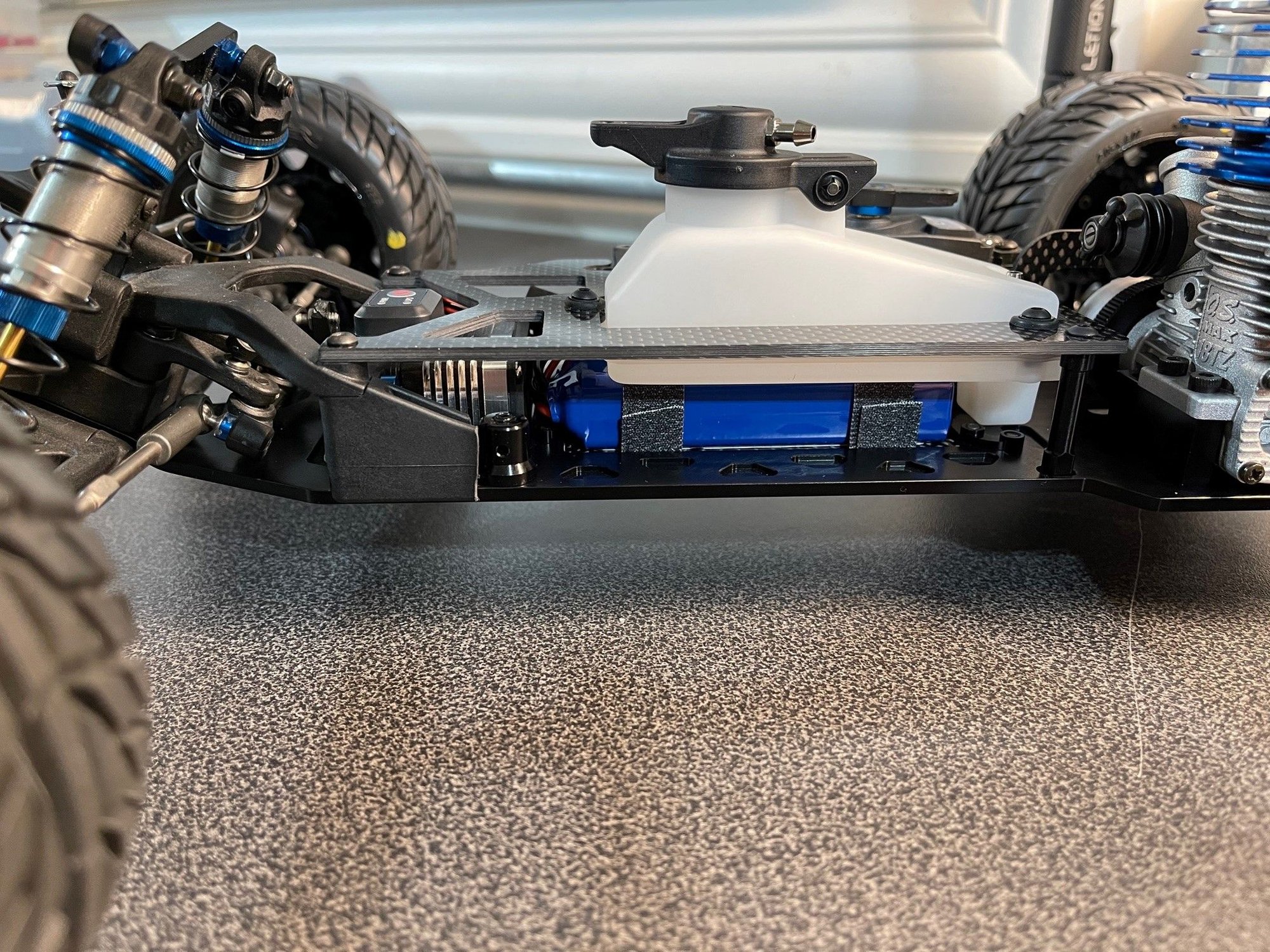

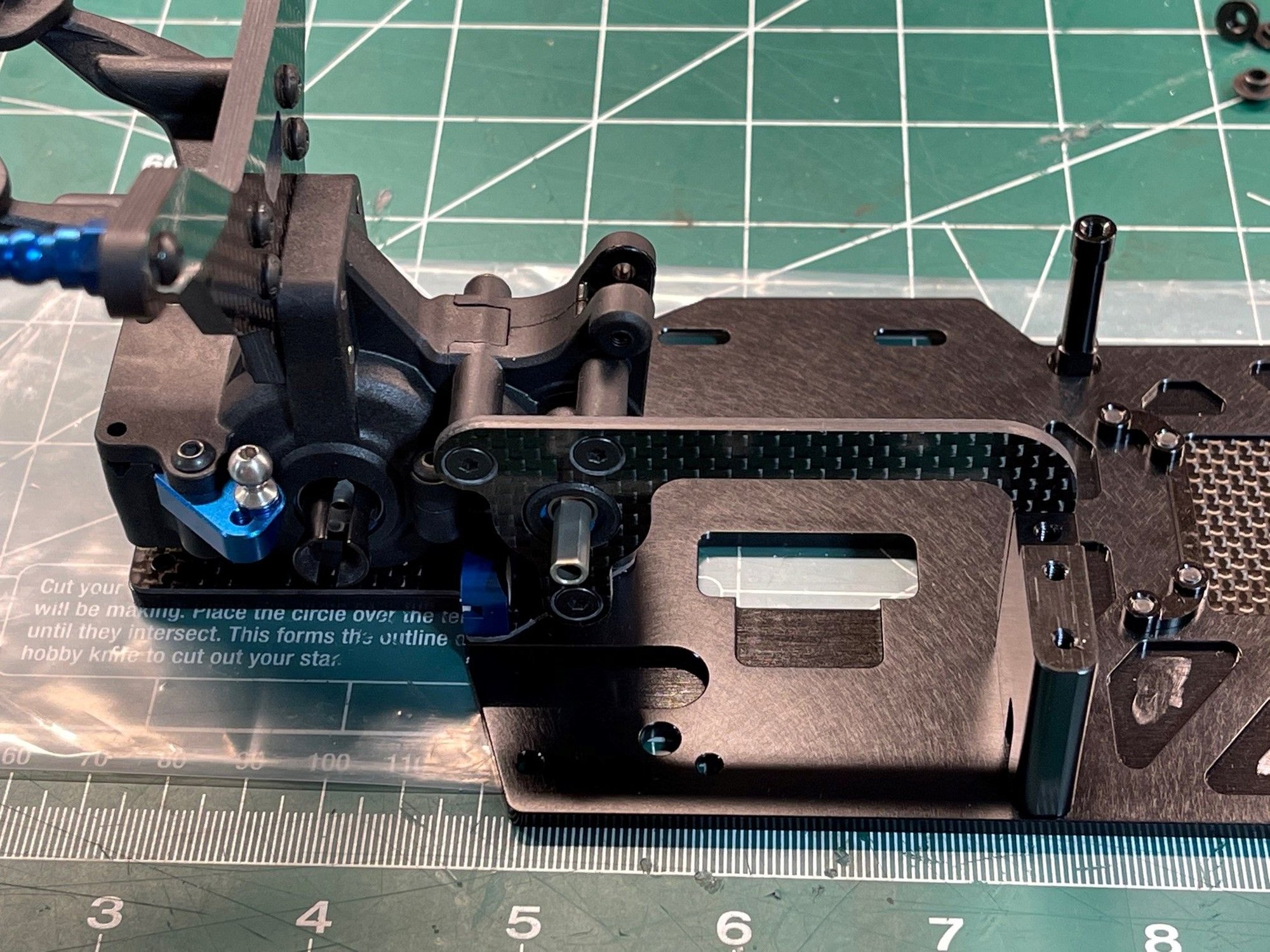

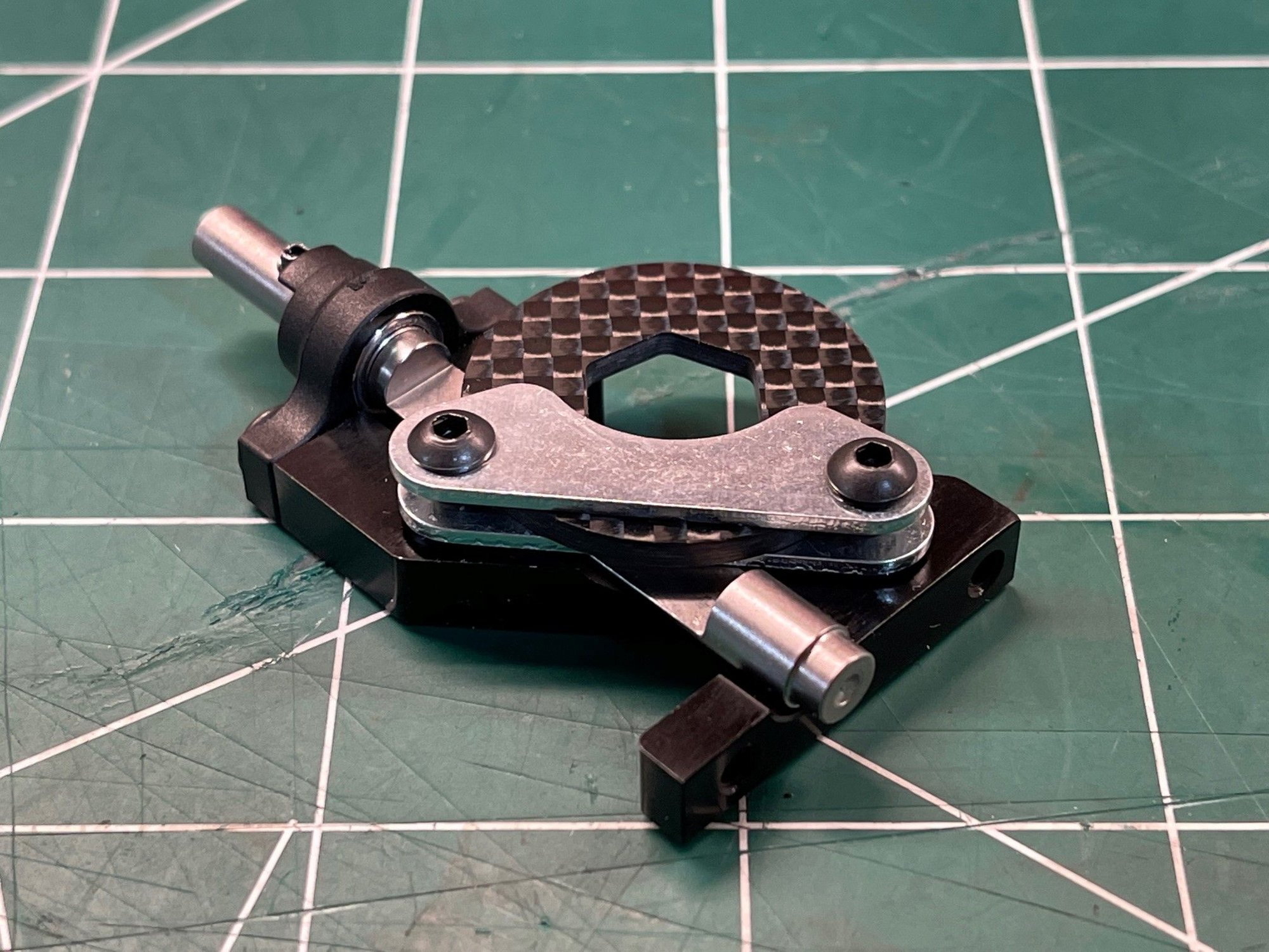

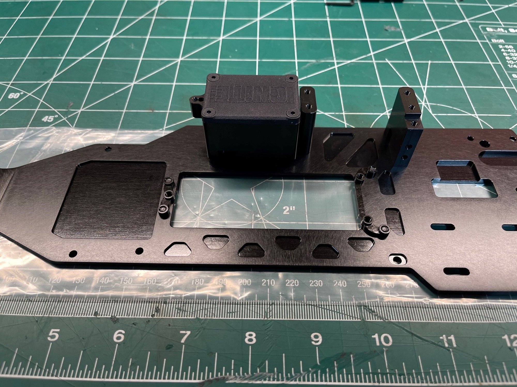

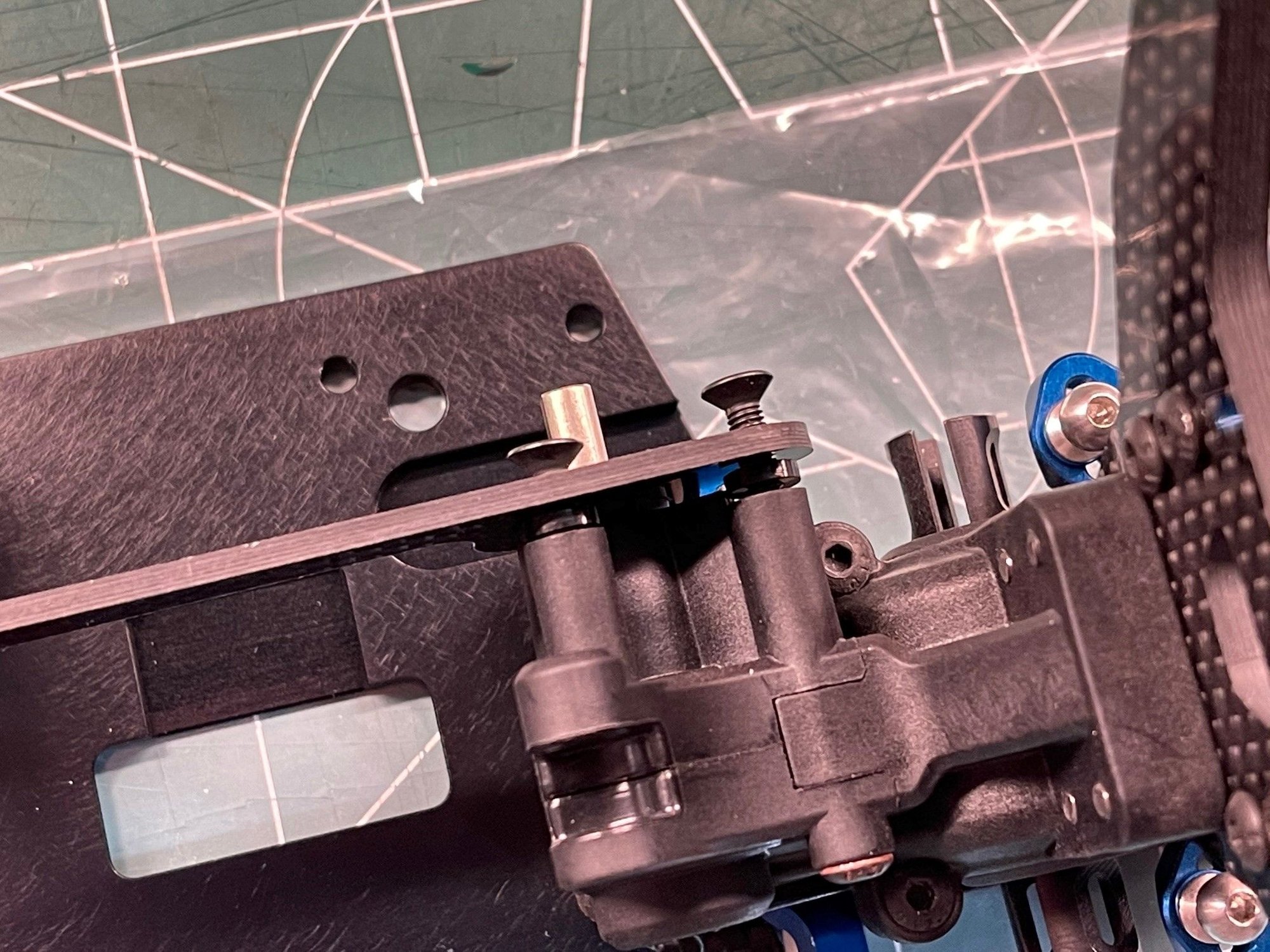

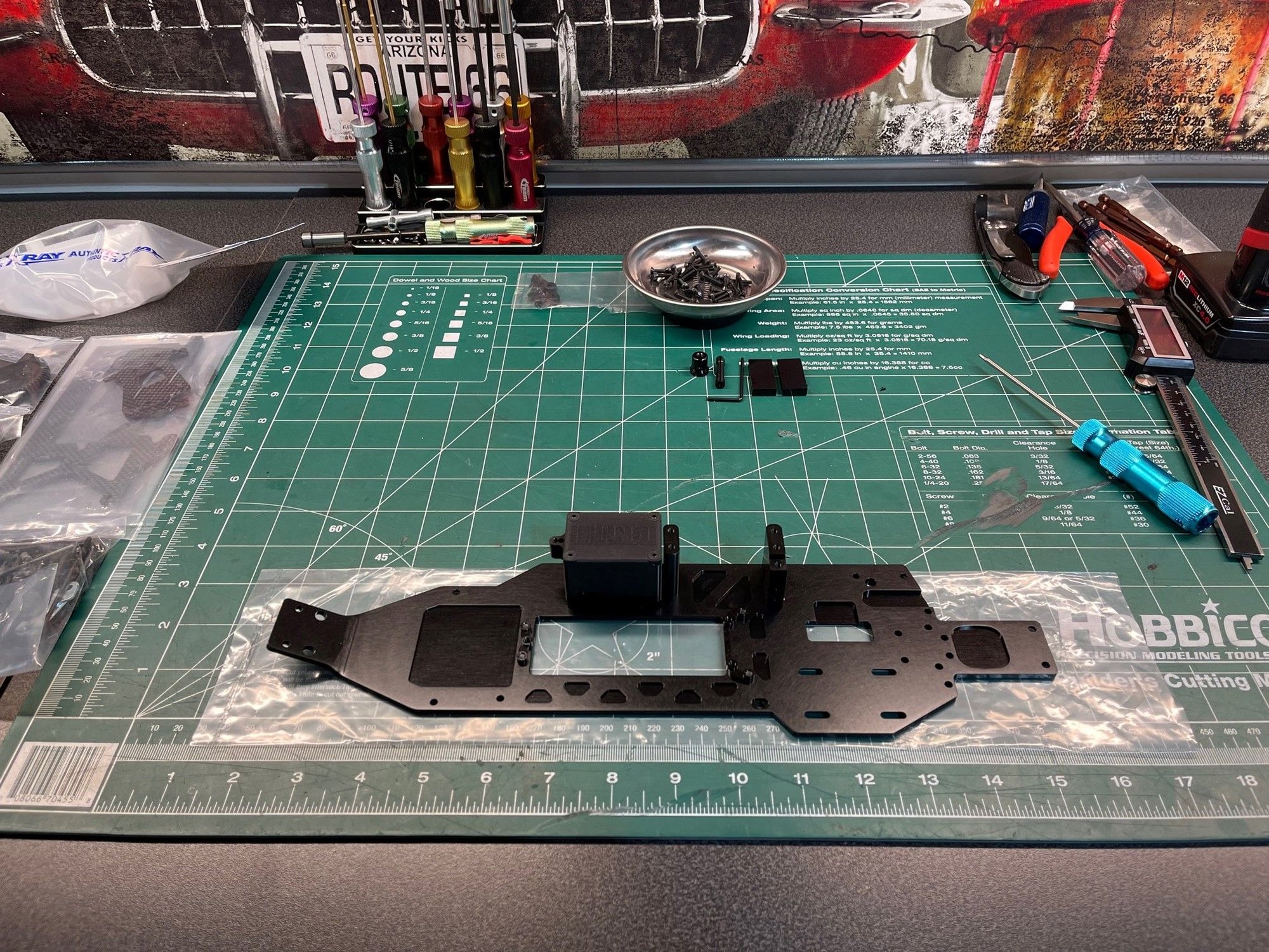

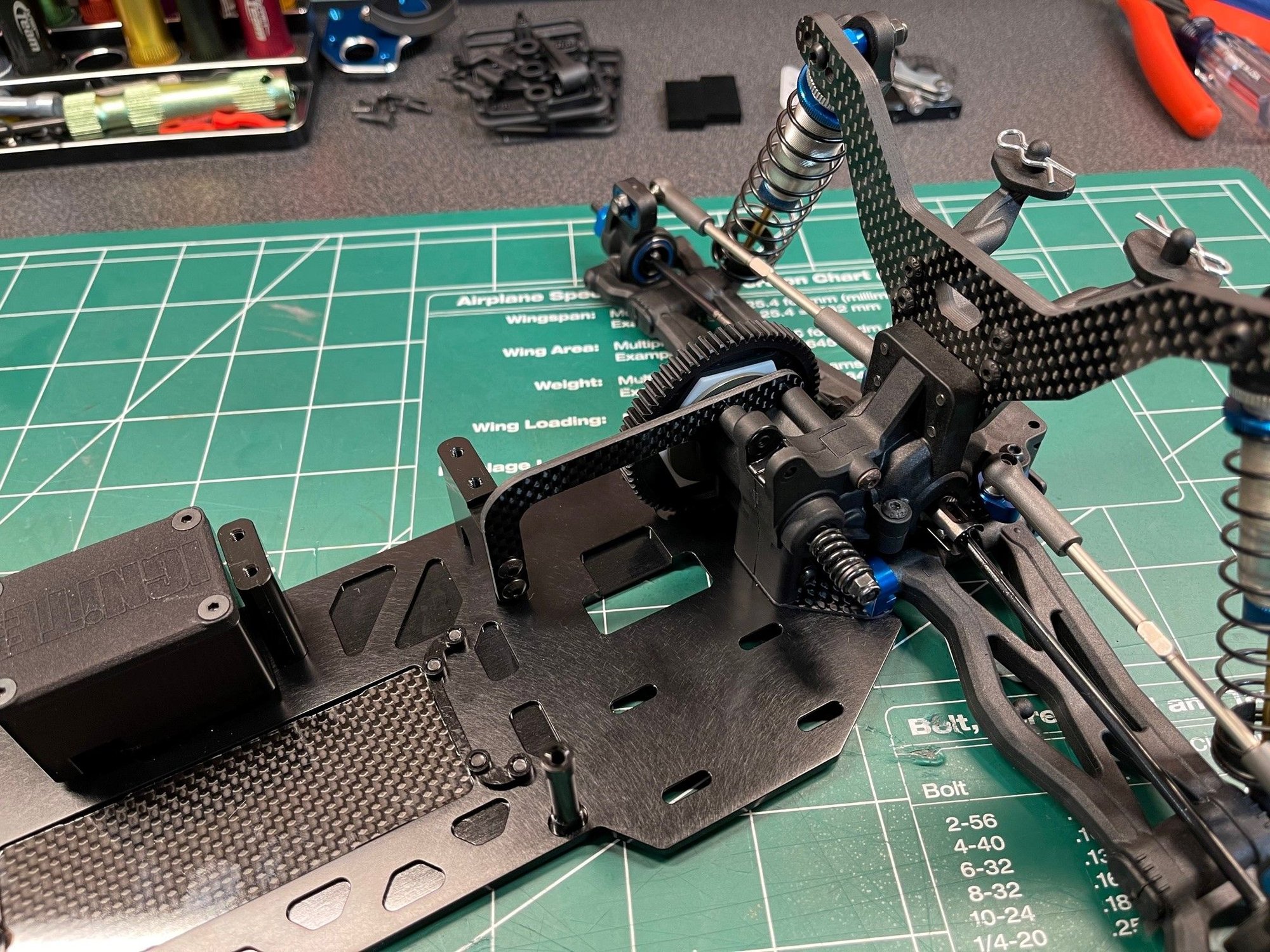

Alright, so lets add some build pics and thoughts and callouts if you're getting one of these kits so far
1. The receiver box is too small to fit any of the standard size Futaba receivers. Supposedlky Ignite is coming out with an extended box / top cover.
2. The Brake assembly is weird - the screw on the top hole of the brake caliper had to be filed down to not rub the slipper hub.
3. You must keep the side rails from the T6.1, cut them to become the servo mounts and standoffs on the front end of the chassis.
4. You can fit a reciever battery that fits the following dimensions - 85mm x 30mm x 16.5mm
5. Locktite everything
6. Don't forget to buy the (not included) AE clutch shim kit and Losi brass collet for the crankshaft.
7. You would likely want to get a small assortment of M3 screws as my kit seemed to have a few missing, but had the spares so worked out great.
8. You will need to remove quite a bit of material from the rear right suspension arm. Under compression, you'll see that it hits the spur gear. See my photos, I actually need to remove a bit more.
9. The spur gear bearing has a little play on the shaft, causing the gear to wobble a bit. It's possible to get it aligned but you'll need to set the mesh light enough to account for this or it will cause binding. This should realistically just be a bushing and not a bearing, with a tighter tolerance.
10. The parts quality of the kit is really great overall, and as it's a new home built kit it's to be expected that some tweaks are needed.
What you see in the photos below is a few nights of work. I need to get a pipe and manifold still and set up the throttle / brake linkage and I will be done. The cleaner the T6.1 / T6.1 you start from, the easier this will be. You will have the chassis, slipper front plate, spur and pads, battery strap / mounts and the motor plate leftover from your donor kit that you can sell if desired.
Start of the chassis assembly - Ignite Designs RC truck conversion
Up Close - Ignite Designs RC truck conversion
Installation of the trans brace - Ignite Designs RC truck conversion
Trans and suspension mounts installed - Ignite Designs RC truck conversion
Trans and suspension mounts up close
Don't forget the aluminum spacers between the trans brace plate and the trans. They're the small black aluminum items. - Ignite Designs RC truck conversion
Other side of trans brace - Ignite Designs RC truck conversion
Slipper installed - Ignite Designs RC truck conversion
50% complete chassis and top plate - Ignite Designs RC truck conversion
Rear of the truck - Ignite Designs RC truck conversion
Bottom of the truck - Ignite Designs RC truck conversion
Completed brake assembly - Ignite Designs RC truck conversion
Engine installed, front end on and wheels / tires in. Also installed the steering servo. - Ignite Designs RC truck conversion
Os 18TZ should RIP! - Ignite Designs RC truck conversion
Electronic switch mounted under top plate and wires run into receiver box. - Ignite Designs RC truck conversion
Side view showing battery mounted under tank - Ignite Designs RC truck conversion

Nice review. I built mine and I noticed you didnít mention grinding the right rear suspension arm for spur gear clearance. I had to remove quite a lot of arm material for clearance at full up travel. Also, the receiver box is sized fine for Sanwa/Airtronics receivers. This is designed as a racerís kit IMO.
On the arm grinding, you're right. Should be visible in my photos but I will add to the itemized list. And as far as racer vs. basher etc, plenty of racers use Futaba (7px). There will barely be enough room for a small receiver and the additional wiring in the box.
