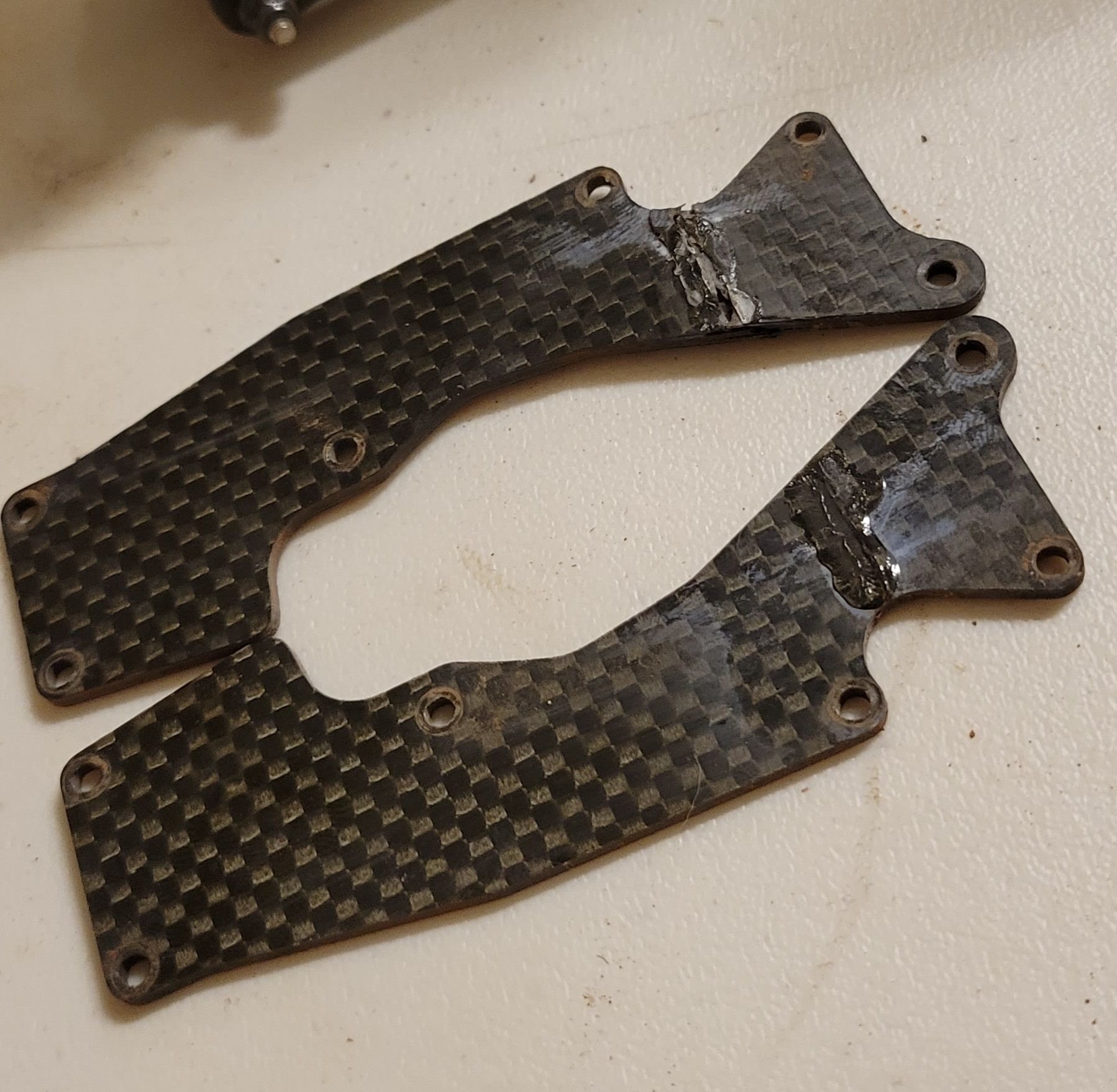

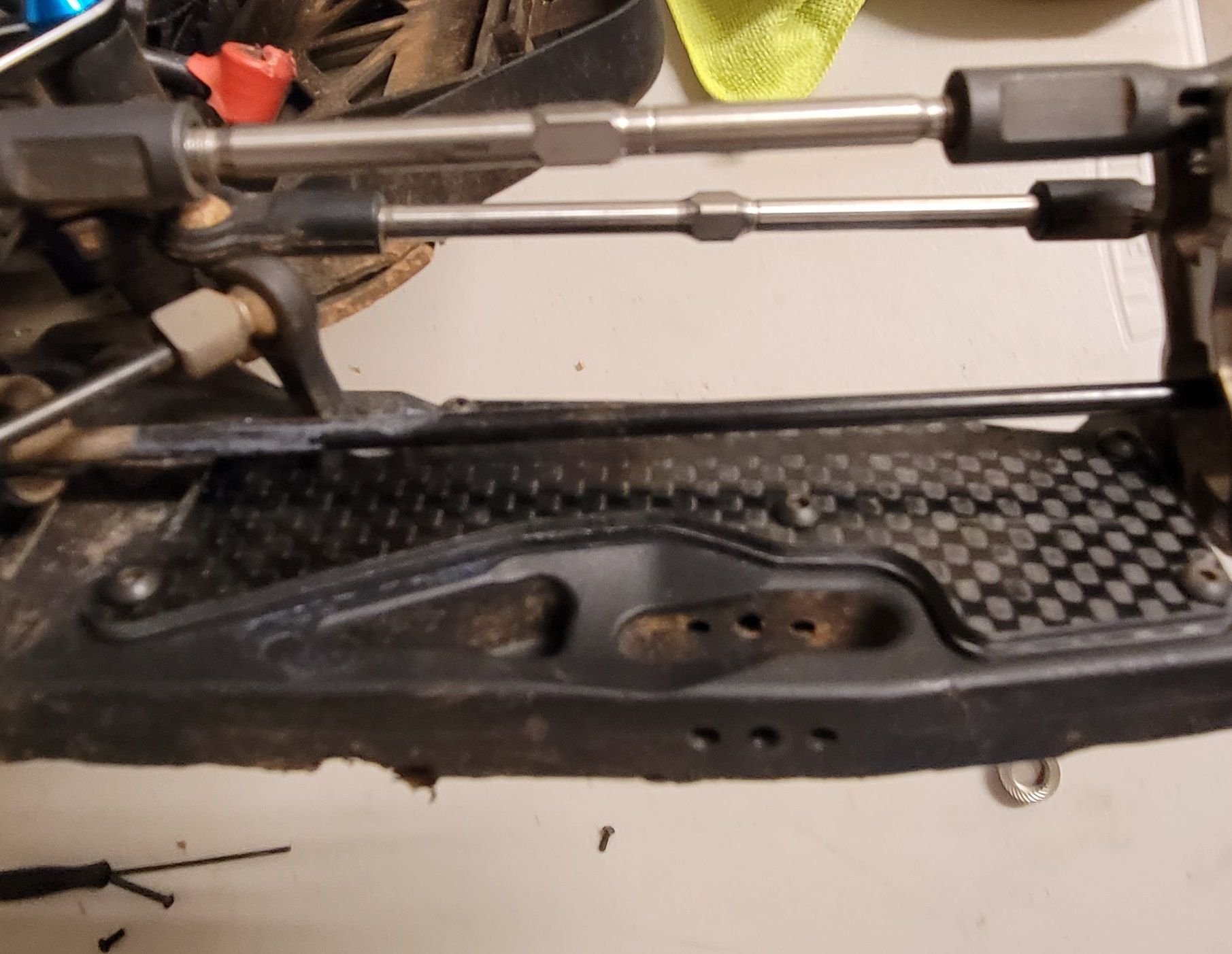

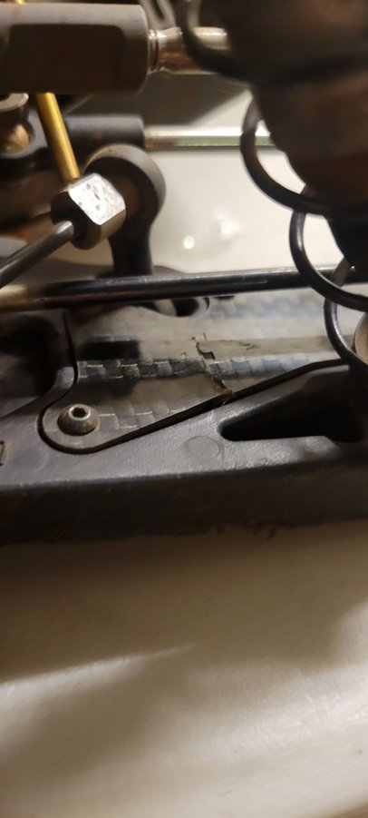

Anyone else run into this? Insert cracks both front arms in same spot. Assuming that's where the twisting load is (because swaybar) and it's just twist cracking the carbon inserts.
Plan b is to just run doubled up inserts. Thoughts?

Run double.

Thats the plan. I'll probably send one of the broken ones off and have some 3mm inserts milled.

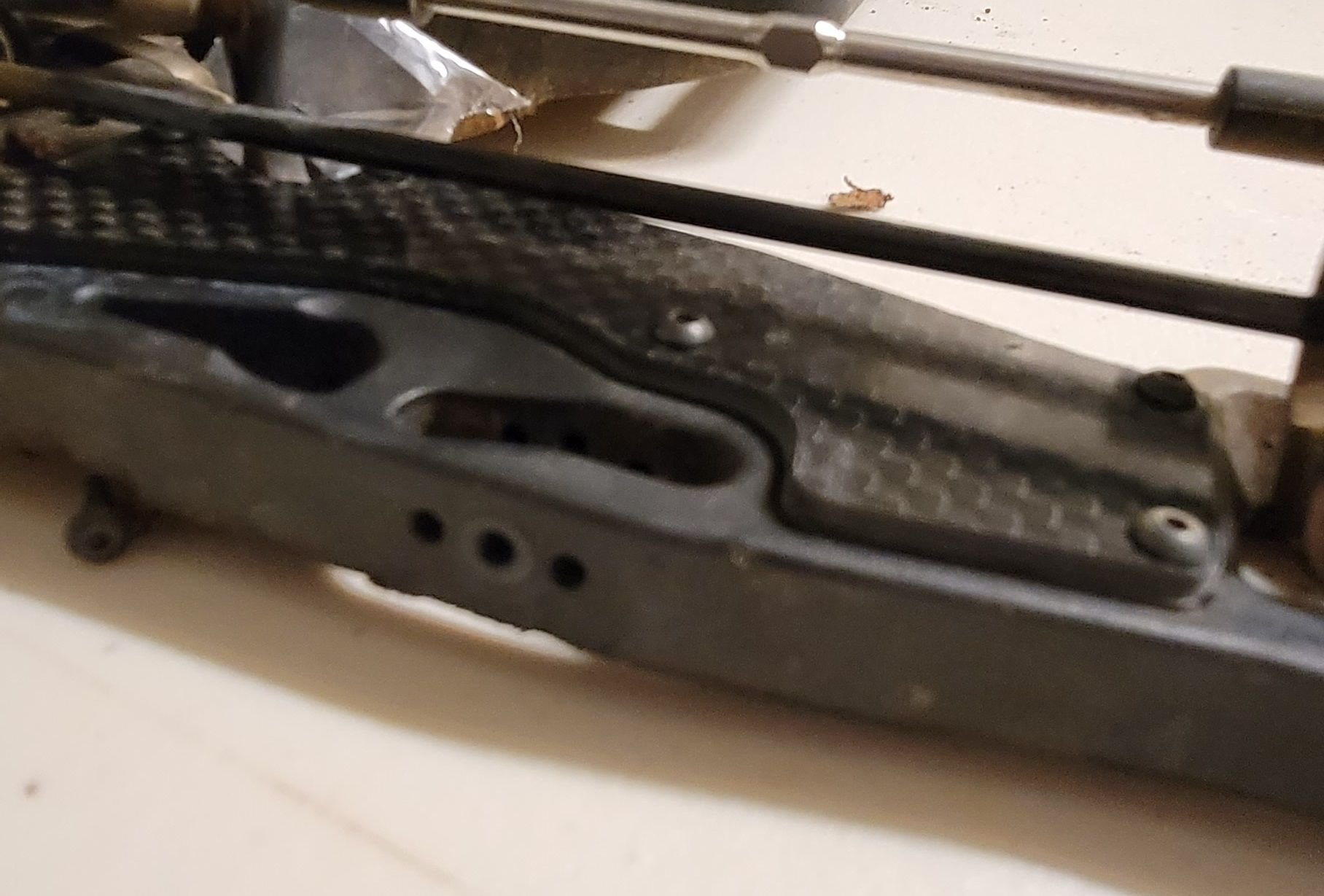

Sanded the middle of the two pieces and bonded them together with elastomer epoxy. Bolted down to cure. Need to get some 3mm longer screws for the extra thiccness. The originals more or less fell apart after removal at the crack, even with the super glue temp repair.
If these don't hold up I may epoxyfill the void in the arm below the insert to add stiffness in that spot, and try again.

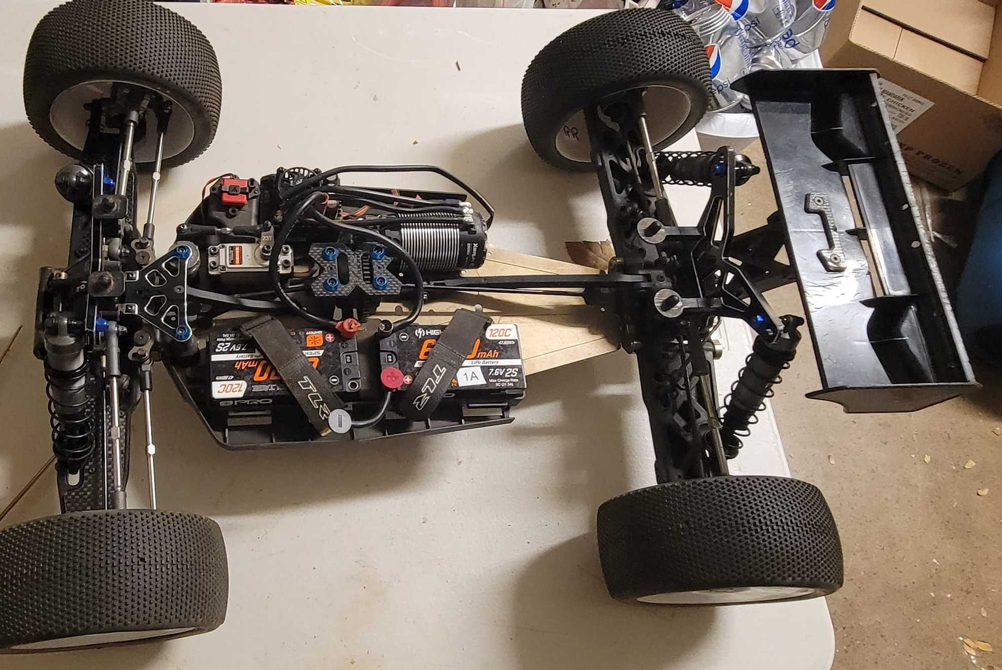

Originally Posted by Licklobster View Post
I am considering trying this. How is the balance with that set up? You essentially moved 120g from the left rear of the chassis to the right front of it. Batteries weigh in around 400g on the L side, the R side contains the motor 350g, esc 122g, servo 70g, & most of the center diff. Would make me think it's right side heavy? I guess if the new buggy is that way there must be something to it..
D1Rk is offline
Old 12-13-2022, 11:42 PM
  #180
Join Date: Jun 2022
Posts: 237
It's not. It made a great truck an extremely great truck. Lowering the cg just the smallest amount really helps it slide around and turn on power. It's the fastest truggy at my track. Try it.
P.S. crossweight matters more then l/r weight. This balances it almost perfectly on the scales.
D1Rk likes this.
