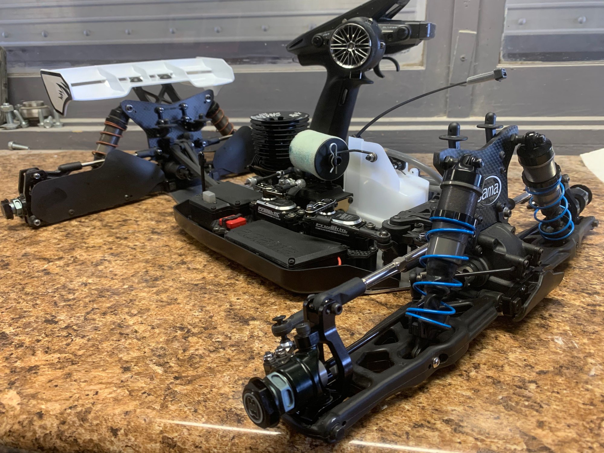

My latest truck build.... 😬

What towers are them?
