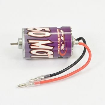

Replace mine with these ones, cheaps and goods.
fastrax Fast560-9 .
