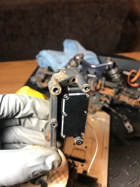

Just putting this out there since I didn't see it covered elsewhere. The ProTek 170SBL servo interferes with the steering servo mount (TKR9328) due to having a wiring plug on the servo body, rather than the usual wiring pigtail coming out of the case. I doubt it will cause problems to Dremel away some of the servo mount plastic for clearance since the lower post on the mount probably doesn't experience much loading anyway, and at only $14, I'm cool with giving it a shot.

Yeah I run the same servos. Had to do the same.

same thing using savox 1270s, just not enough clearance designed in...

For anyone wanting to know what servos will fit with zero modding, Tekin servos fit fine. So if you aren't a fan of dremeling, look for servo's with similar cases, I guess.

My SRT servos fits fine as well.

So do Savox, plenty of servos out there that will work great.
