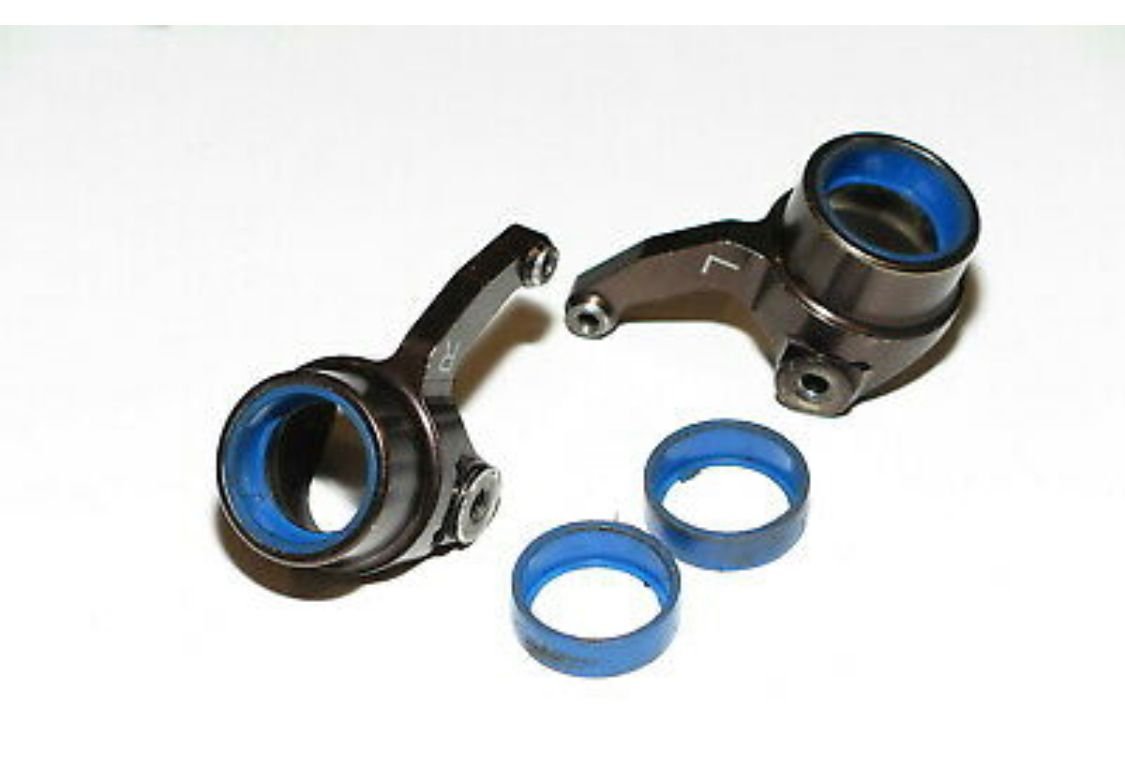

well...what I thought was the problem wasn't...I discovered the left knuckle arm was cracked when I was getting ready to replace the swingshaft. For the Readyset that is part IF275B. I ordered a replacement part for the kit TKi4, which is part IF419, and upon receiving it realized it's not a direct swap. The readyset knuckle uses smaller bearings, the kit larger. I don't see that a replacement part is carried with the readyset part number, any thoughts on what else I'd need to replace if I use the kit part? I'm thinking at least the wheel hub and bearings. Any thoughts?

Are you using the blue bearing holders??

yeah, I am now...I ordered just the left knuckle the first time and it didn't come with the bearing holders. Next set did. thanks for the reply though.
