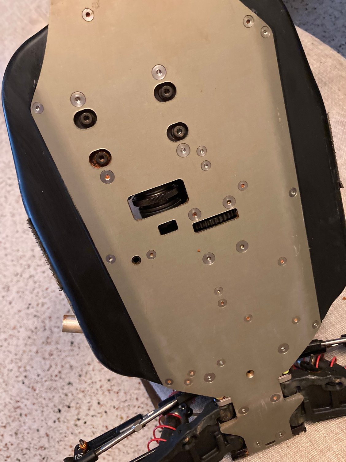

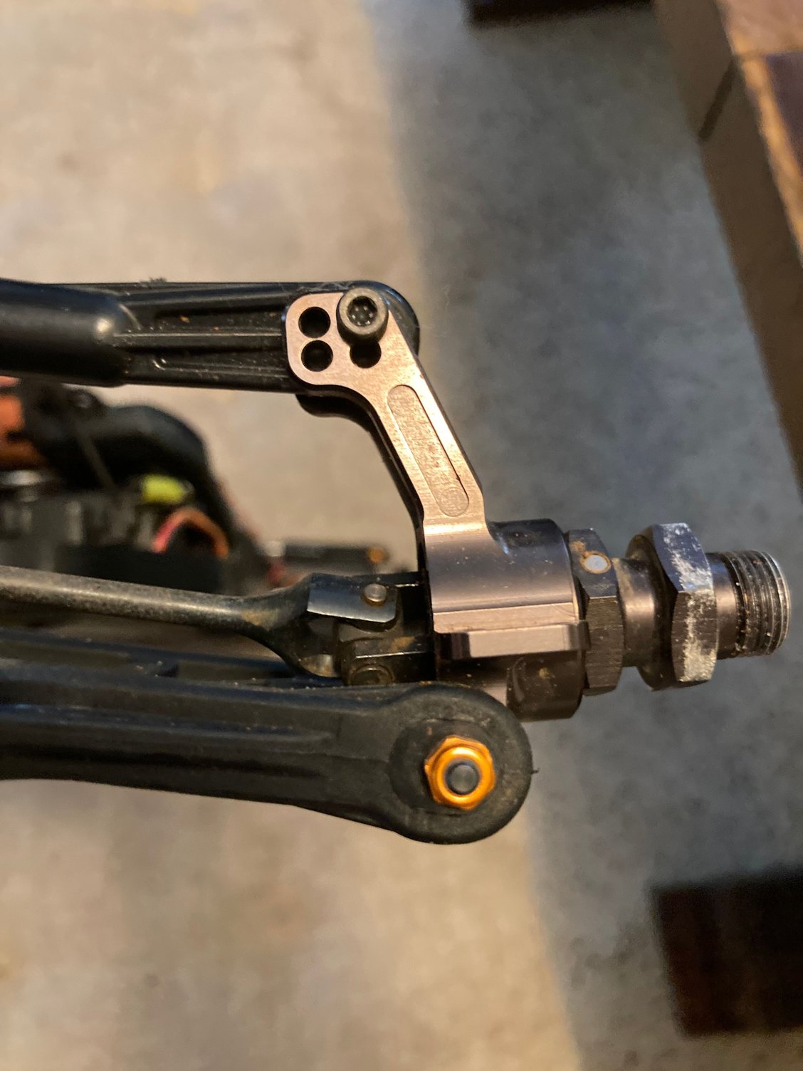

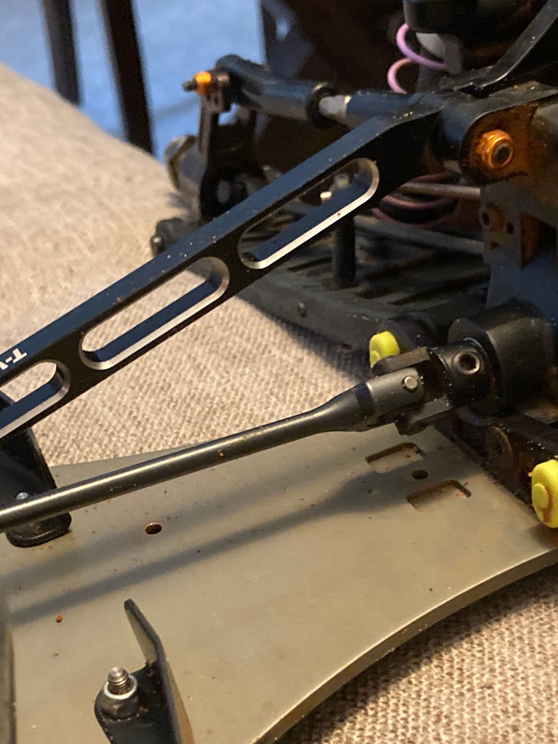

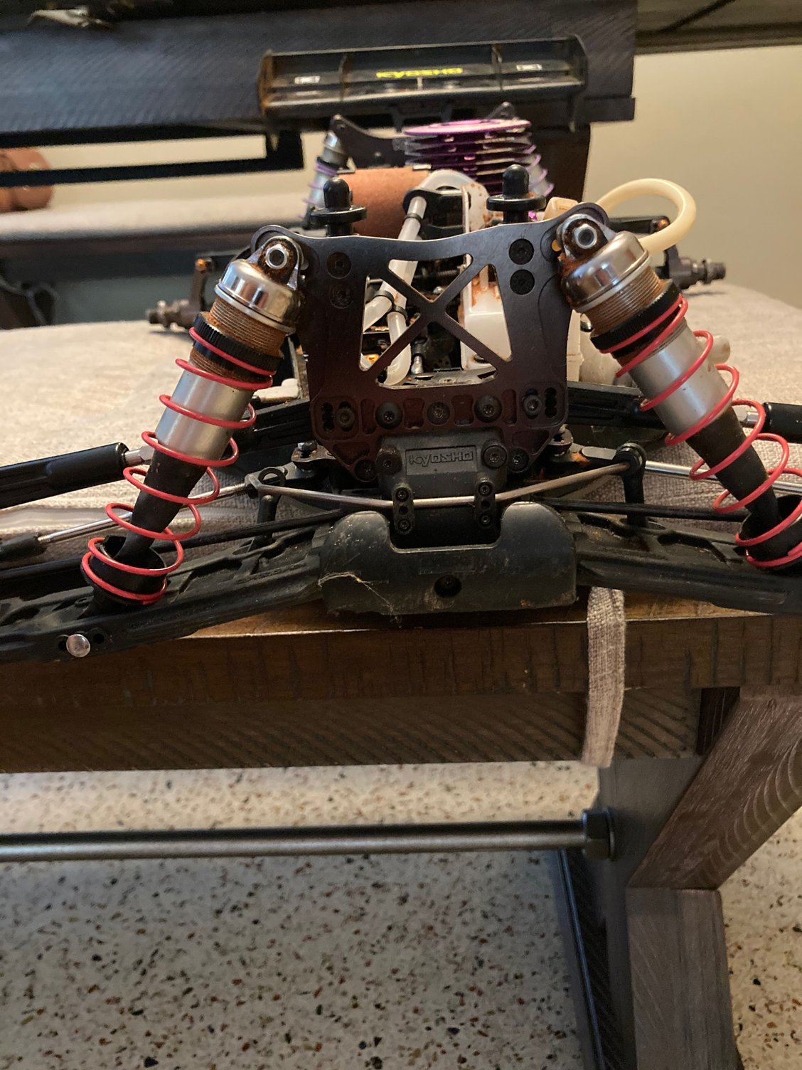

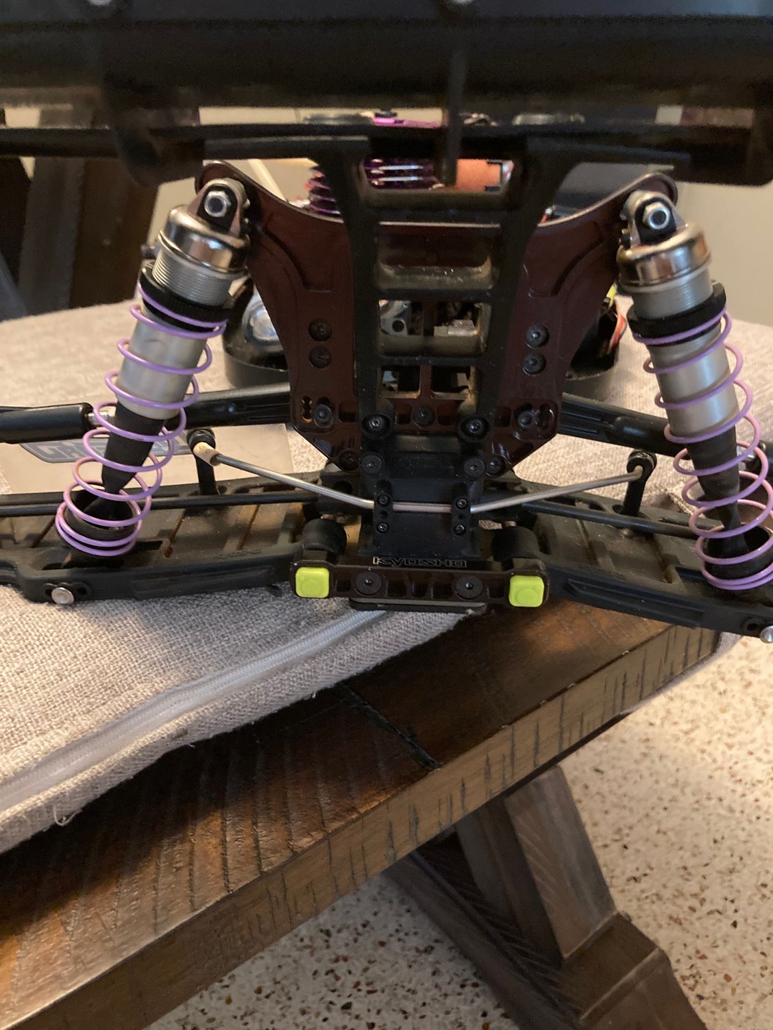

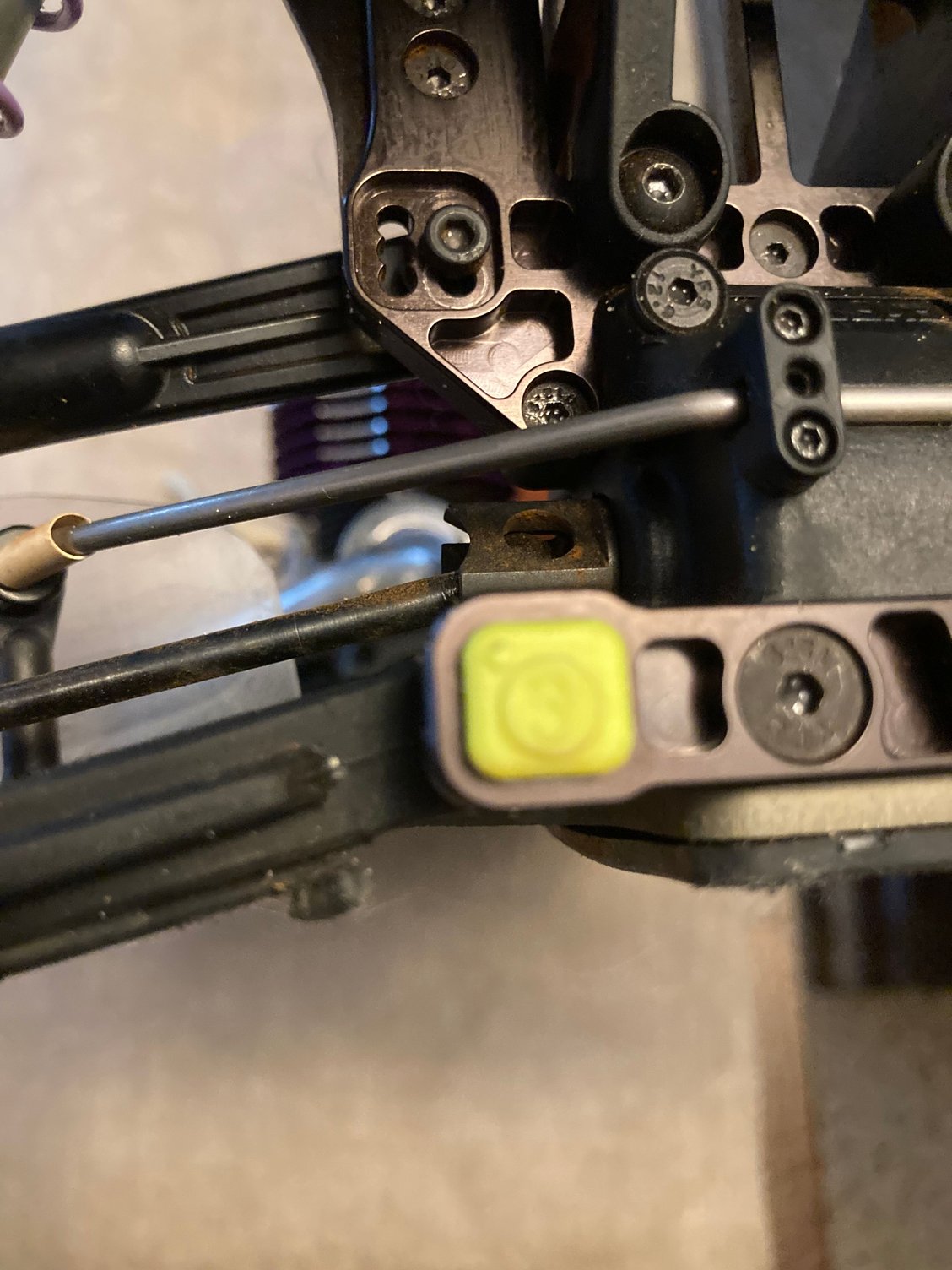

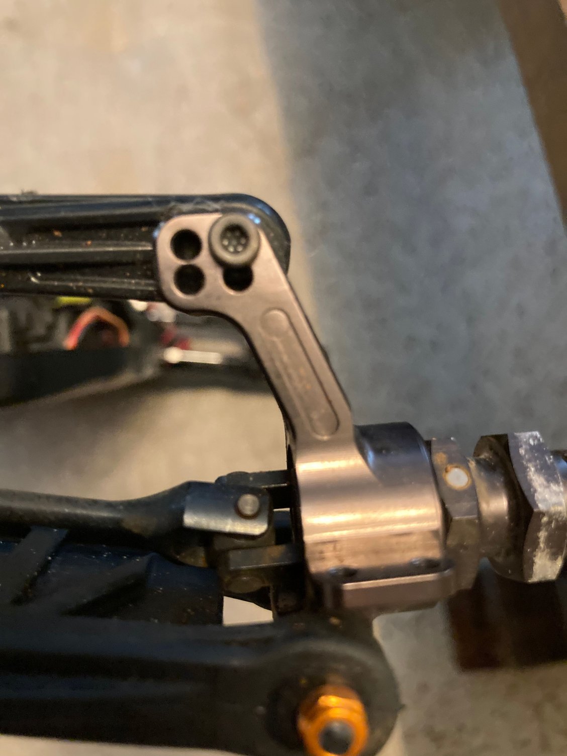

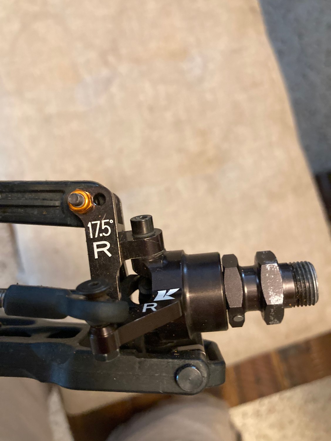

I run here in Florida
I pretty much run the stock setup with a few changes…
Red springs up front
60/50 Losi oil front/rear (adjust accordingly for the blazing summertime heat etc)
12/12/4 Diff oils
2.5/3 degree toe in rear (currently 3.0)
Droop screws are set at 2mm (ish)?
I run the strr rear unis….somewhere in the thread that is discussed…no probs there
I change the rear pills around…works for me (see if I can send some current pics showing suspension etc.)
Shocks are in middle hole on tower and arm both front/rear
60/40 ish front rear brake bias … vented discs.
Aluminum front rear caster blocks/hubs (personal preference)
17.5 castor +0/ +1 inserts….
Tworx front and rear aluminum chassis braces
Lunsford titanium bottom kit… turnbuckles.(personal preference)
If a lot of traffic is running and a groove forms I might make tire changes and maybe play with diffs, oils etc.
Running stock Kyosho 13t vented clutch bell setup on 3 aluminum shoes with 1.0 springs all around
I find that I can still get on the throttle and it handles the rough sweetly.
Still playing around with it but working for me…lol
Obviously tires are going to play a huge factor and since coming back in …I’ve really liked the feel of the J Concepts Reflex to start out the day…

Pretty sure all links and Ackerman positions, sway bars, pistons etc. are stock except for the rear pill setup… and mentioned items? I run the lightened cross pins in the diffs(not necessary). I run emulsion setup…. And check/change oils every so often..
No “magic” setup…. Find you a good base setup that’s a comfortable start…then tweak/play around with it to accommodate your driving style and track conditions based on your experiences and data gathered…out of the box setup isn’t too shabby…😎🇺🇸
