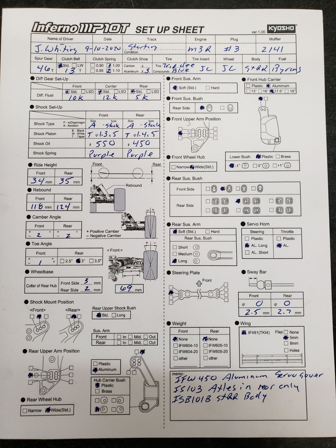

a few members have asked about set ups for the truggy.. this is what i have been running the last month or so with good results.

that body fits ???

need to change the front body mounts out and install them in the front of the tower. i used serpent te-truggy front body mounts.

Thanks for the setup sheet J! I ran almost identical setup today except for fluids. 7-10-5 and shocks 500F 400R. Got rid of the squirmy rear end for me. Lacked some giddy up to clear a short run up double though. Will try thicker center diff on Wednesday.

good to hear. run 10-12-5 in the diffs .. i tried 10-10-5 and as you said the short runups i couldnt make so i put 10-12-5 and had no issues with making jumps. 12-12-5 0r 12-14-5 work great in high bite.. the truggy has so much steering you can run higher diff fluids and not lose mush steering.

J, can you measure your rear turnbuckles for the rear camber? I dont have a gauge.

killing me smalls. lol.. 17.60mm .. get a camber gauge.. ha ha ha.. hope this helps.
