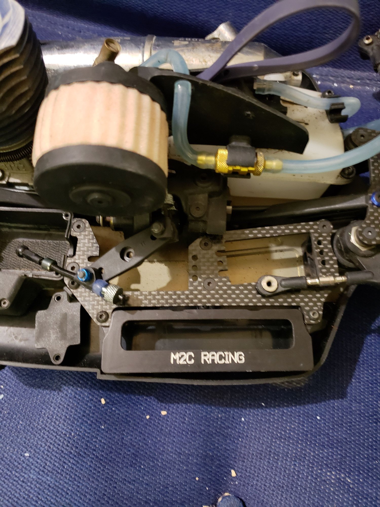

I just bought a used Mugen Mbx7r. Im just wanting to know if someone can recommend a good receiver battery that fits in the M2C tray

Any 2S flat receiver pack

I have a 2s lipo pack that I can't use that's made for the original mbx7r tray (which should work with this one perfectly fine). It's NIB just didn't realize my reciever can't handle over 6v.

Normally that is made for a flat receiver pack. The dimensions are set by a 5 cell 2/3A battery pack. 17 x 28 x 85mm. Several Life and LiPo reciever packs are made to these dimensions.
