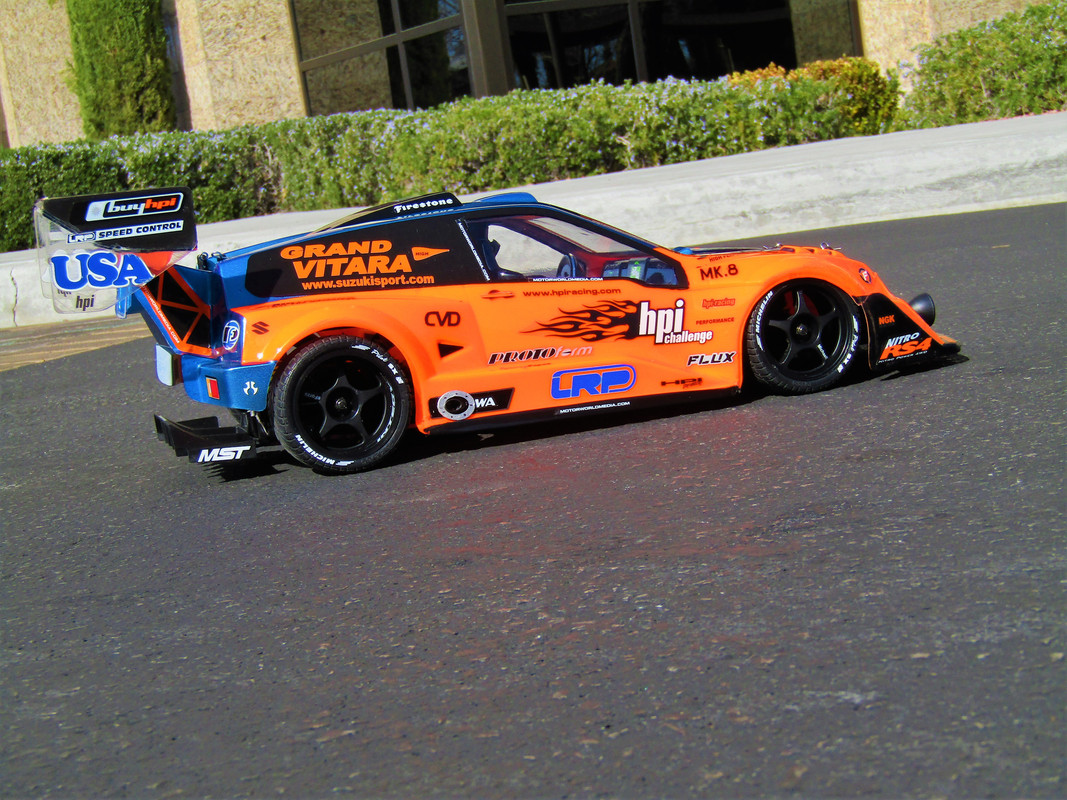

I did a similar project in reverse order. Took a Super nitro rs4 and converted into a on road electric rally car.

I did like the street version much better then the off road version. The car was created after the Pikes Peak hill climb and when they changed the entire surface to asphalt.
