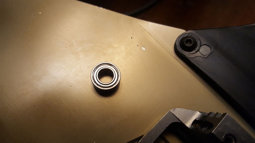

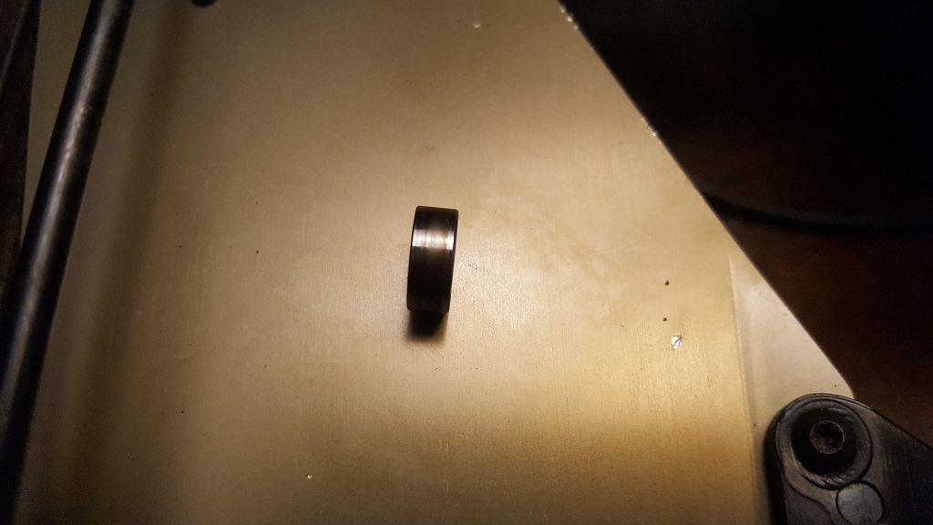

How do you guys gauge on when you need to change your clutch bell bearings? I have some J&T Ultimate bearings and I just pulled them out after 2 gallons to check them and they appear to be fine. My clutch bell spins really free. Are they still good to go for another gallon or is it time for them to be replaced? I don't race and just bash. Also, that's just dirt a little dirt in the race that wiped off pretty easily.

Honestly, I change them very often. I always put new ones before a race, if it is a big race or a long main I will put new ones during the weekend. I then reuse the old ones for practice, clean and oil. As soon as they start sounding loud or get considerable axial play, I throw them away. You can get lots of life from them if you clean them often, but since they cost 1$ I think it just isn't worth the risk.

Yes, as stated replace ofter, it is the cheapest way to ensure clutch longevity and prevent blown out bearings. Buying a bunch in a tube is a good practice. If in doubt, replace them.

Though they usually can be cleaned and oiled again with good results, if you're the least hesitant just change them, if the bearings goes out they can take the crank with them.

JT clutch bearings last a long time. Change them when they just start to get rough. Should get more than 45min from a set imo.

45 min of bashing? I don't race so I was just wondering what the signs are of them needing to be changed.

If you do not race then change when it got too much play, feeling gritty of has broken in pieces.
