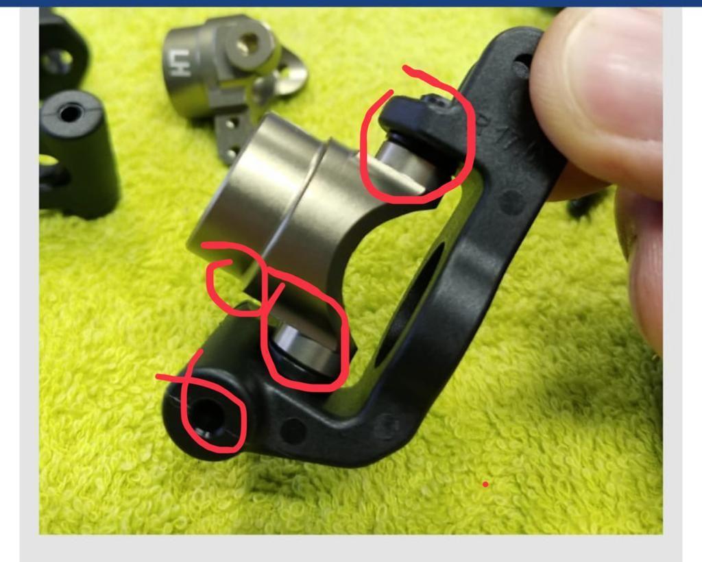

Any quick tips to make the front knuckles move freely ?
I do not have a tip; however, flip the bushings so that the 2mm one is on top. You can run it either way, but it appears you want the spindle in the low position.
try to loosen up the screws a small amount. they maybe too tight

Posts: 862
pass a bit of sandpaper on the bushings and over the screw removing the black paint then use thread lock
OK, so do NOT loosen these screws. Sorry, just dont want you to break something due to this.
I would dremel the spindle until the anodization is off the top and bottom and put back in place and should be good then.
