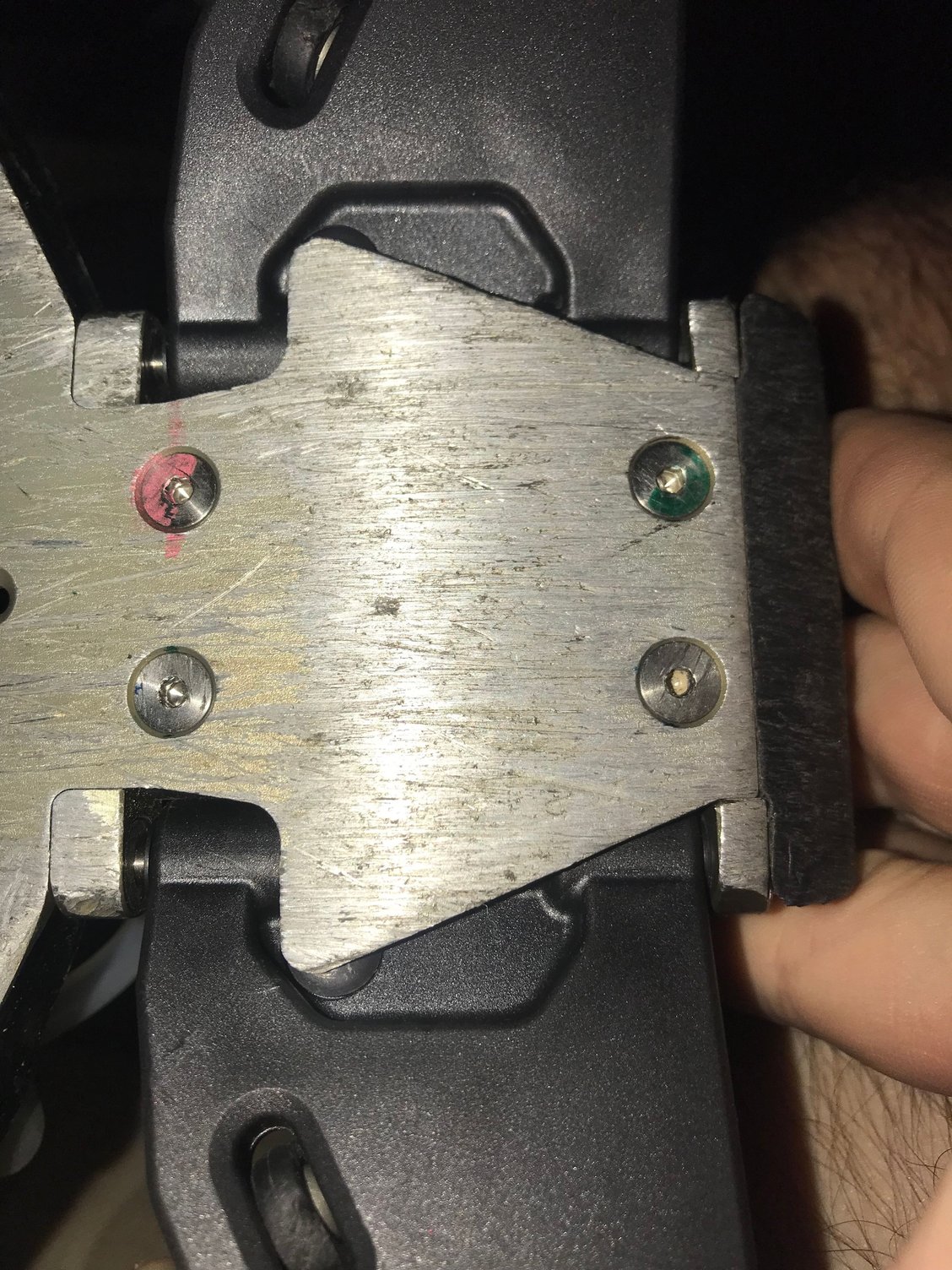

Hey guys I put 2.0 x arms on my elite, and the front arms have so much space moving forward n back, I would say atleast 2 maybe even 3mm. These arms must be not be the same as the 1.0 arms, so are you guys putting shims on the hinge pin in front of the metal sleeve in front and back or just on 1 side, what shims will work? Should I use plastic or metal shims? Here’s a pic I took.
u can see toward the back of the arm it just isn’t long enough and u can see the remaining space and hinge pin. Def different length from front to back of the arm. Do I want the arm slammed forward or back? Or should I put equal shims front and rear?

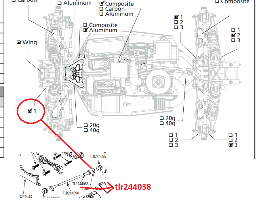

Missing a spacer that goes on the front side of the hinge pin. TLR244038 has them, don't believe they come alone.
I put the metal tube spacers in the arm. They still don’t make up the distance.
Matt Piva is offline
Old 12-03-2022, 07:36 AM
  #1839
Join Date: Jun 2022
Posts: 237
That's because the two things are completely unrelated and the friction inserts are not spacers. I already gave you the answer. Here it is circled on both a setup sheet and on the exploded view, since you're either being contrary or are somehow still confused.
alright dude chill, I see it now. Those didn’t come in the package the arms came with. I’ll have to find some that fit or order those separate. SMH.
