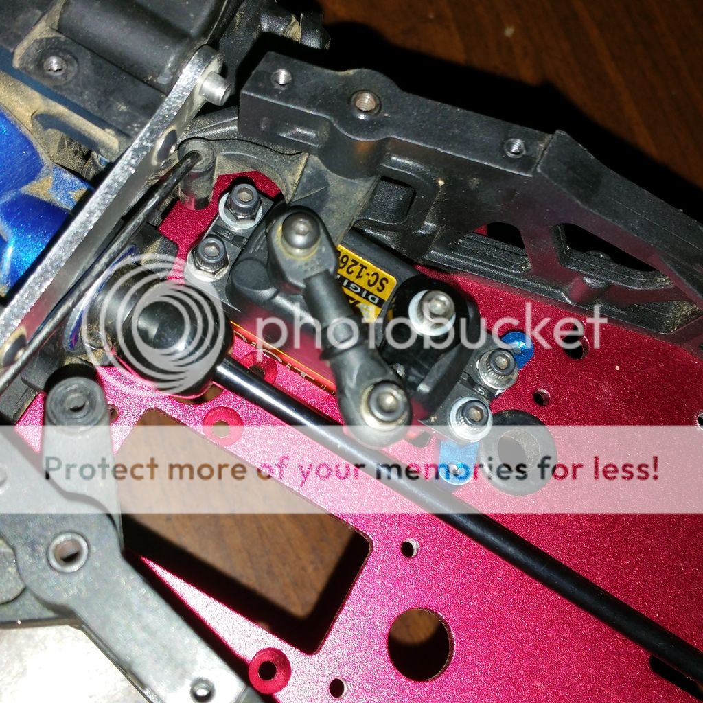

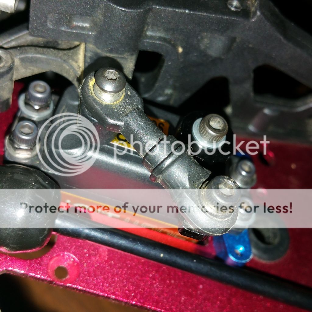

I'm running a single savox servo with a racers edge horn and some traxxas rods ends for a linkage

Do you have any picture of your setup?
Which savox servo are you running in your MT?
It's overkill, savox 2270 brushless high torque like 480oz I think.
It's not the one being used in the picture, the one in the pic is like 347oz which is plenty. Savox 1268 sg. I just cut a 3m screw to make a threaded rod to be used to connect the to rod ends together.
I found going to a single servo, I had tons of flex in the plastic mounting in between the chassis and servo, so I opted for the aluminum mounts, and no flex it's great.
BuGgYBaShEr.28 is offline

I'm using two 1233SG servos. When the wheels are on the ground these servos just barely can turn them.
The 1233SG can do 180oz torque or so. I don't think the 480oz is overkill for these big tires.
Wow, great steering setup. I'll do the same mod if the MG servo safer won't work as I planned.
Thanks for the pics.

480oz is alot to me and I love it tho. And it's also brushless running at 7.4v so it's efficient, the 1268 runs at 7.4v and 347oz and it was also a great servo and plenty of power to the steering as a cheaper option.
Also another thing, Overdriven as mentioned to me that you want the bellcrank arm to be parallel with your servo arm, this allows less drag I believe in your setup.
