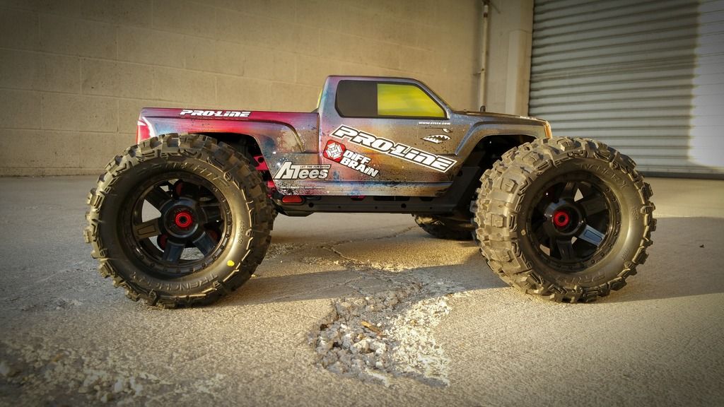

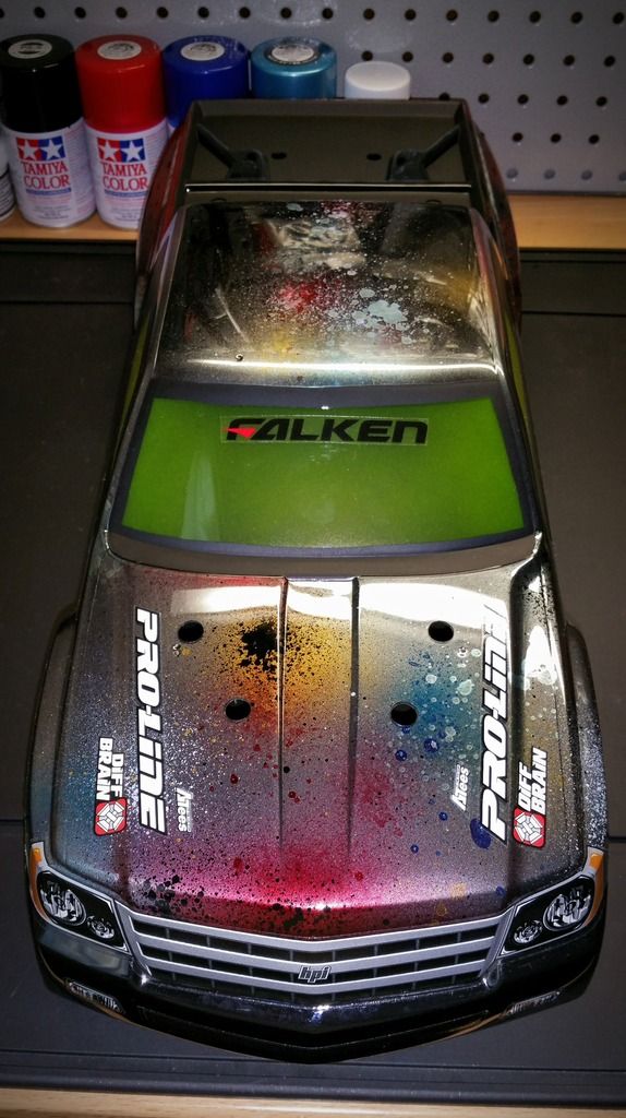

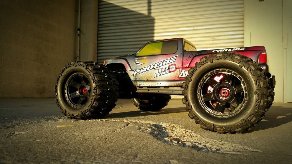

If anyone is wondering what bodies will fit the ARRMA NERO. I have found that the Savage XL Bodies do.
Here is mine with a HPI GIGANTIC body for the Savage XL. I'm also going to run the 3.8 Trenchers as an alternative wheel and tire combo.
Gave the stock and HPI body a reinforcement treatment using E6000 and drywall tape. Than I sprayed a rubber sealant. Just test the waters with it. But my XMAXX took a hit on a parked car after a 44mph pass and the body is still good. No cracks. The rubber is a super thin layer that allow the body to flex and still provide protection.

Turned out great. I like the yellow windows. Thanks for the share.
I tried the drywall tape method but did it wrong cause I'm put it on after I painted.
I used bed liner before with Zero success. I have a new body I'm cutting out now and hate painting so I'm going to find some of your method.

So what exactly is the process there? Paint, let dry, then reinforce? I'm a terrible body painter and I've had bad luck with all my painted bodies with paint chipping and peeling. I'm probably going to repainting a couple bodies here soon and I intend to do it correctly and make sure they last this time.
I paint let dry, the cover with goop, press in fiberglass tape, let dry, cover with one more layer of goop, sometimes only the problem areas, it will make the body pretty heavy.
