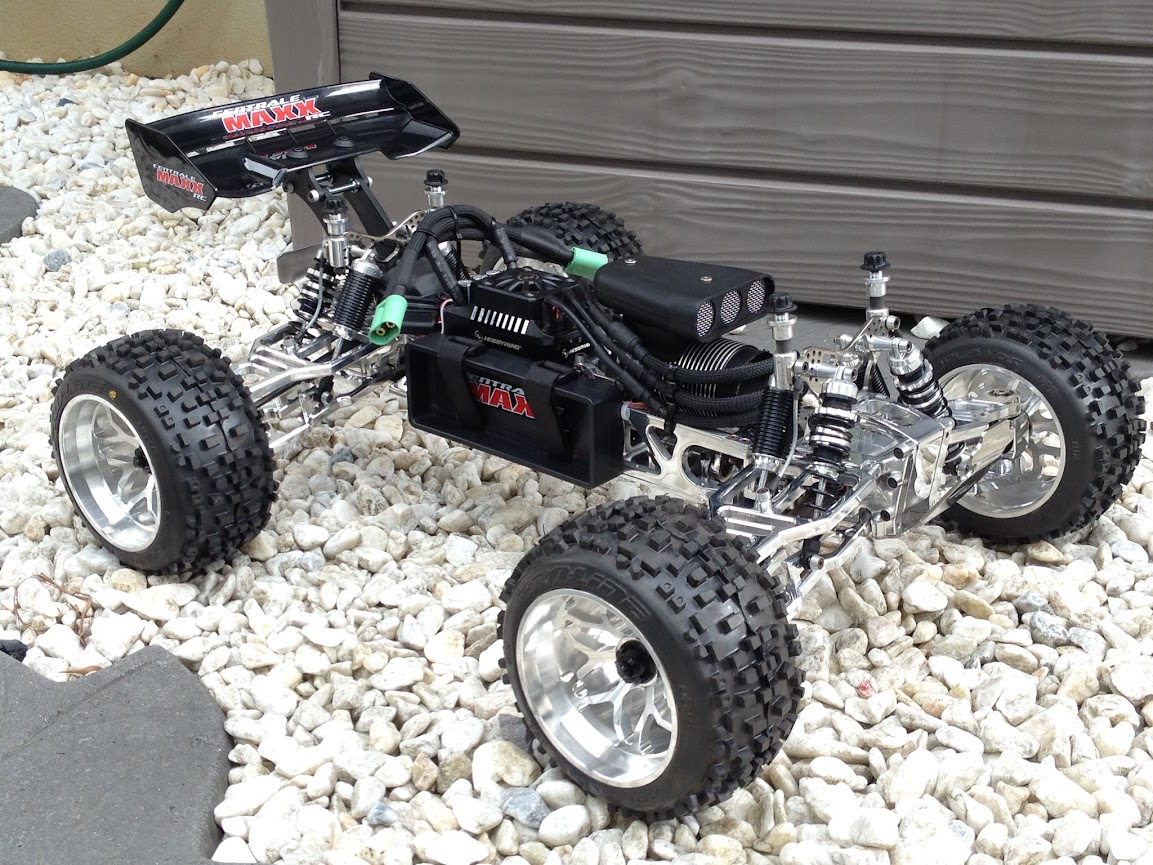

CF double deck Frankenbuild:

It's good to see our trucks NAKED.
The truck bodies just hide a BE YOU TEE FULL
Assembly of engineering. 'Sides,that's where all of the bling is.
Not much here:
Yeah,plastic drives.
