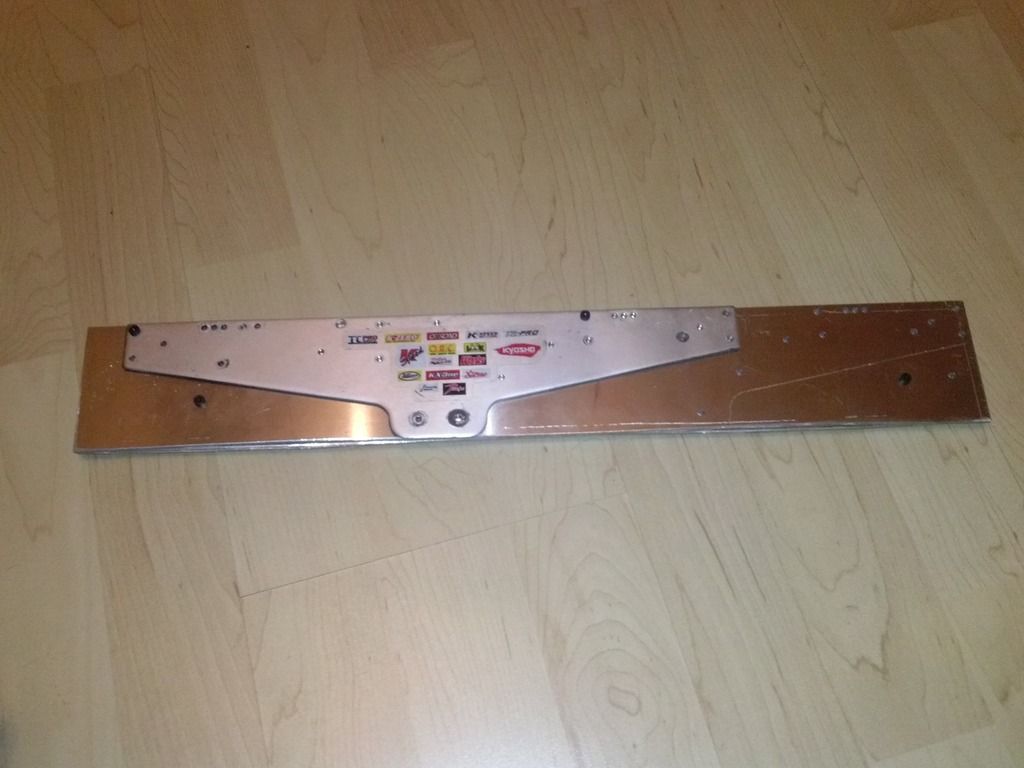

Hi, guys. Just want to show you the modification on my Mad Force. It all started because I didn't liked the way it rolled over at almost any corner. So a widening project ended up in a complete transformation.

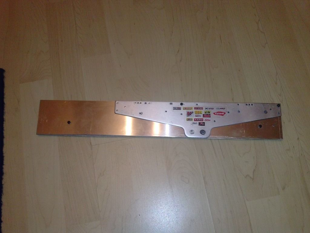

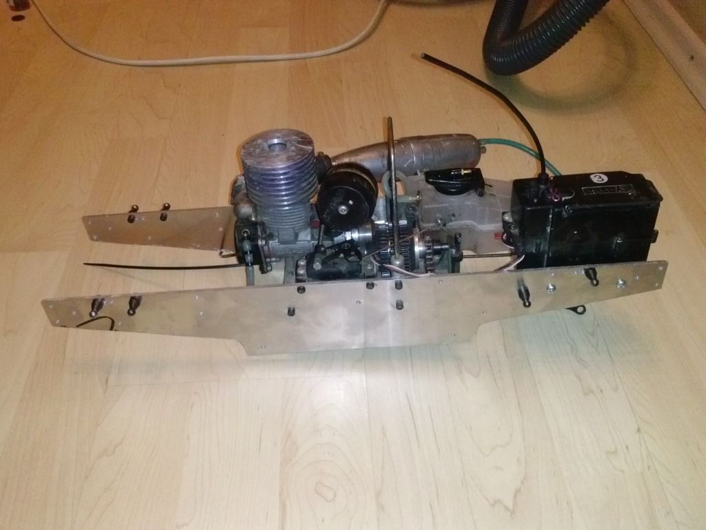

I started with a 3 mm aluminium sheet on which I "copied" all the holes from the original chassis. If I remember correctly I made it 12 cm longer (~5")

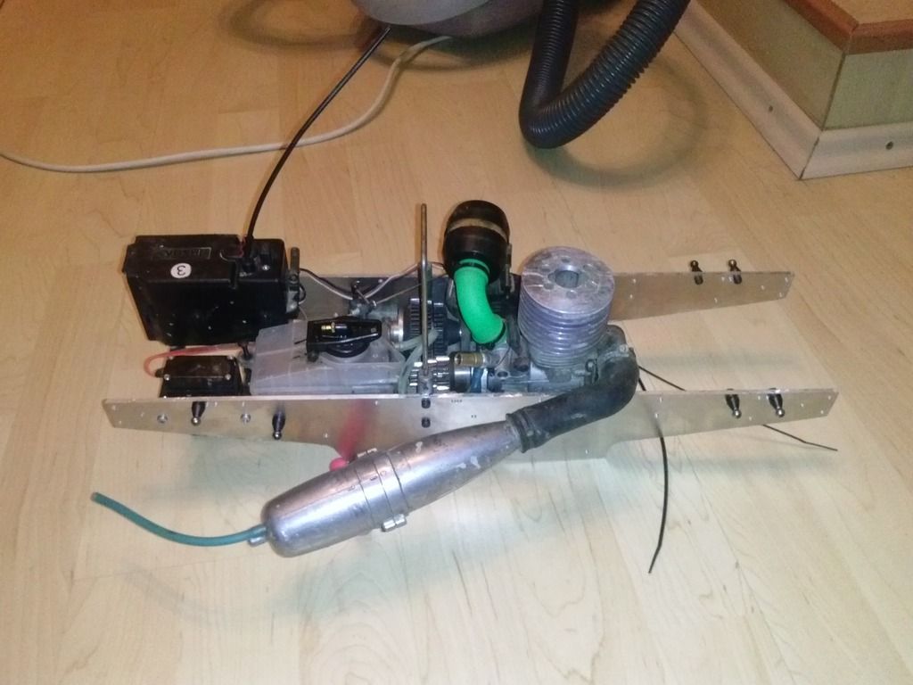

Front side
Rear side

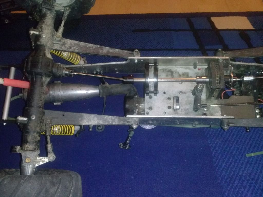

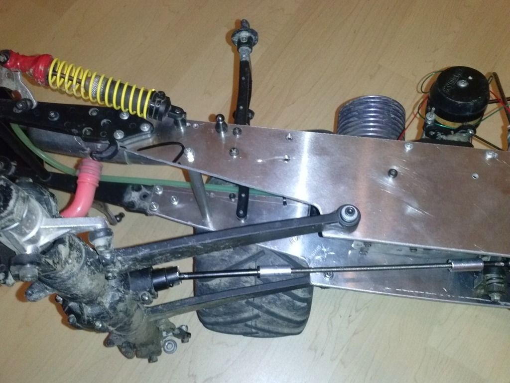

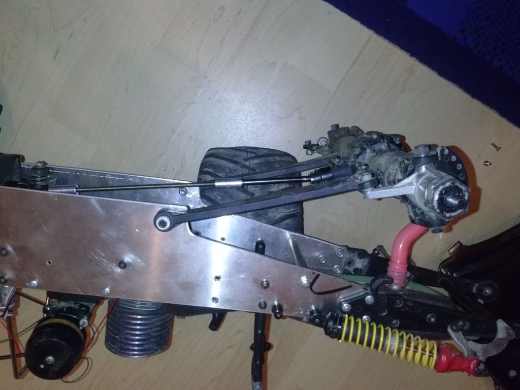

Basically, I only moved further back the entire back section of the car. The only part I had to change was the rear center shaft
However, being so long, the new center shaft had a lot of flex. So I changed the design in order to further use of the original part.

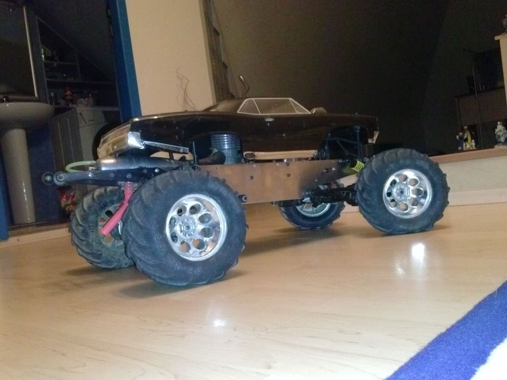

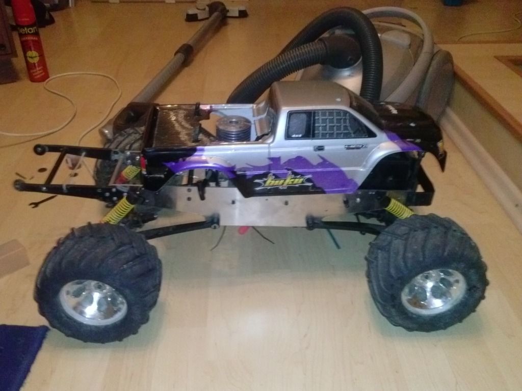

With a Savage 25 body

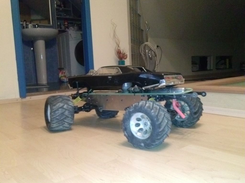

Didn't liked, though, so I bought a Pontiac GTO body, fits much better

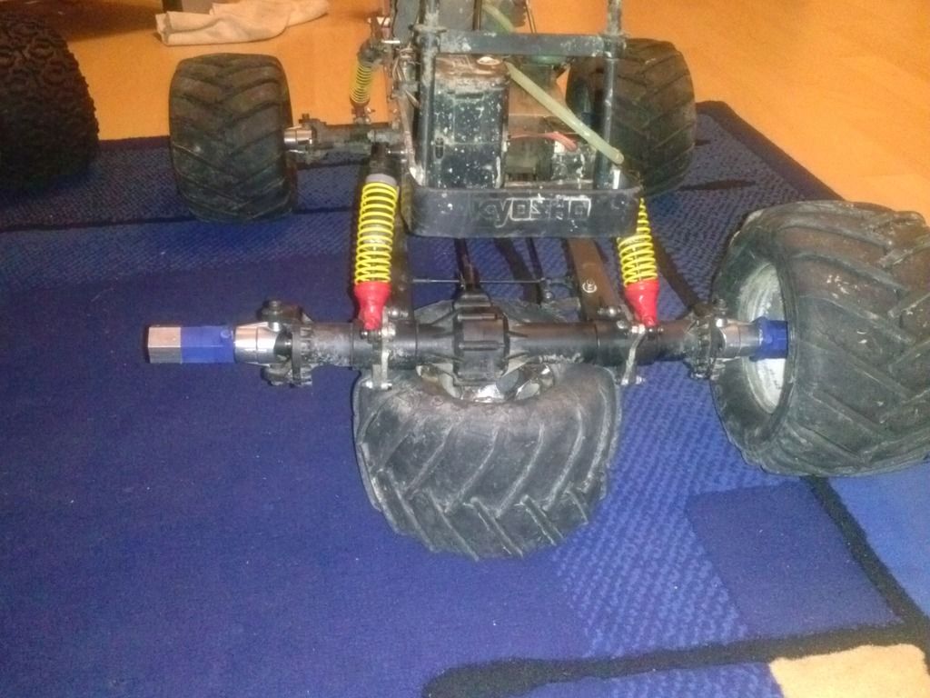

For widening I use 17 mm aluminium hex, 4.5 cm long.
So now is around 8-9 cm wider and 12 cm longer.

what 17mm extenders are those ?
werner sline is offline
Old 05-01-2015, 04:29 PM
Tzicul's Avatar
Join Date: Feb 2014
Location: Bucharest, Romania
Posts: 163
My own design, made on lathe from 17 mm aluminium hex. I can send you a pdf, if you want

Very cool project. These home brew mods are my favorite and stretch chassis projects are always fun, I've done a few myself. Love your 2nd version of the rear shaft.
You know your new wheelbase should be pretty close to the wheelbase of 1/5 and 1/6 bodies from FG, MCD, Redcat, etc. Just an FYI in case you want to consider alternatives to 1/8 bodies.

Never thought that way! The GTO body looks nice, but is so thin!!! I actually wanted to make a mold in that shape and make a new body from a thicker PC. You can't find here too many options for bodies and shipping overseas from US is stupid expensive.

There should be some European dealers for the FG, MCD, Redcat and other 1/6 bodies that would make shipping less painful. Double check your wheelbase though, I believe 18-19 inches is what the bodies I mentioned are.
