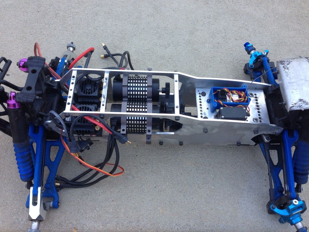

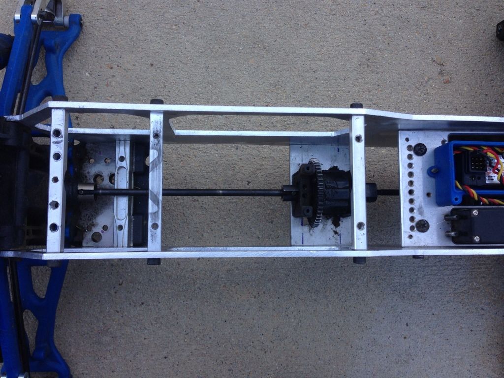

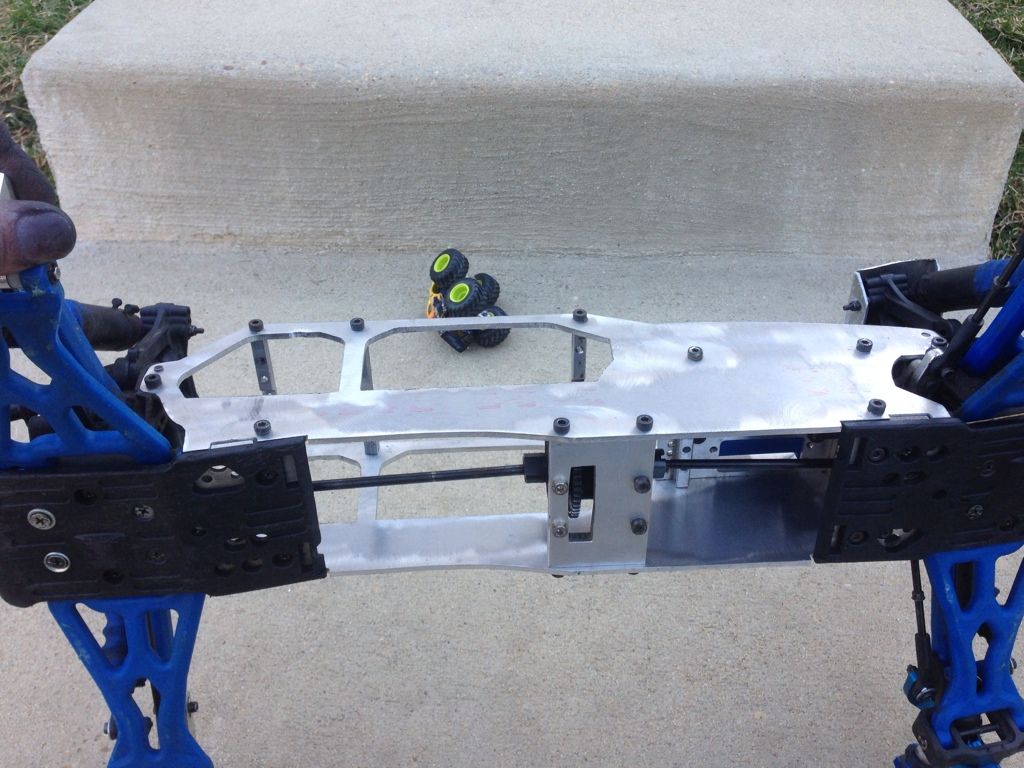

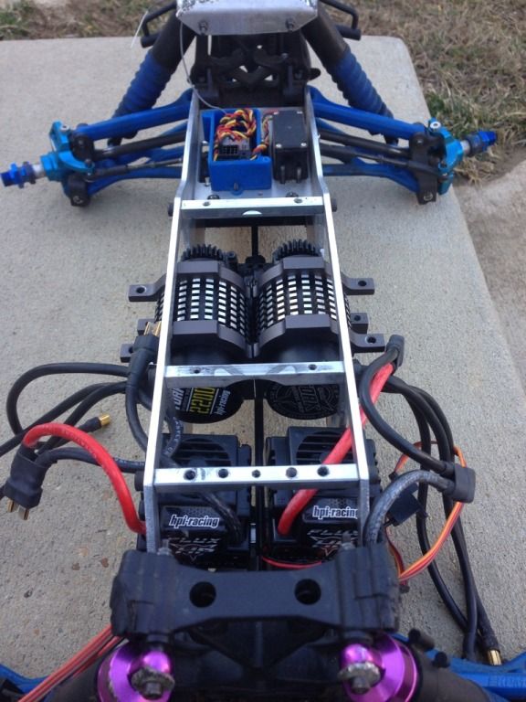

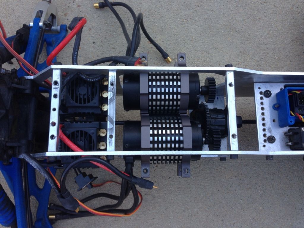

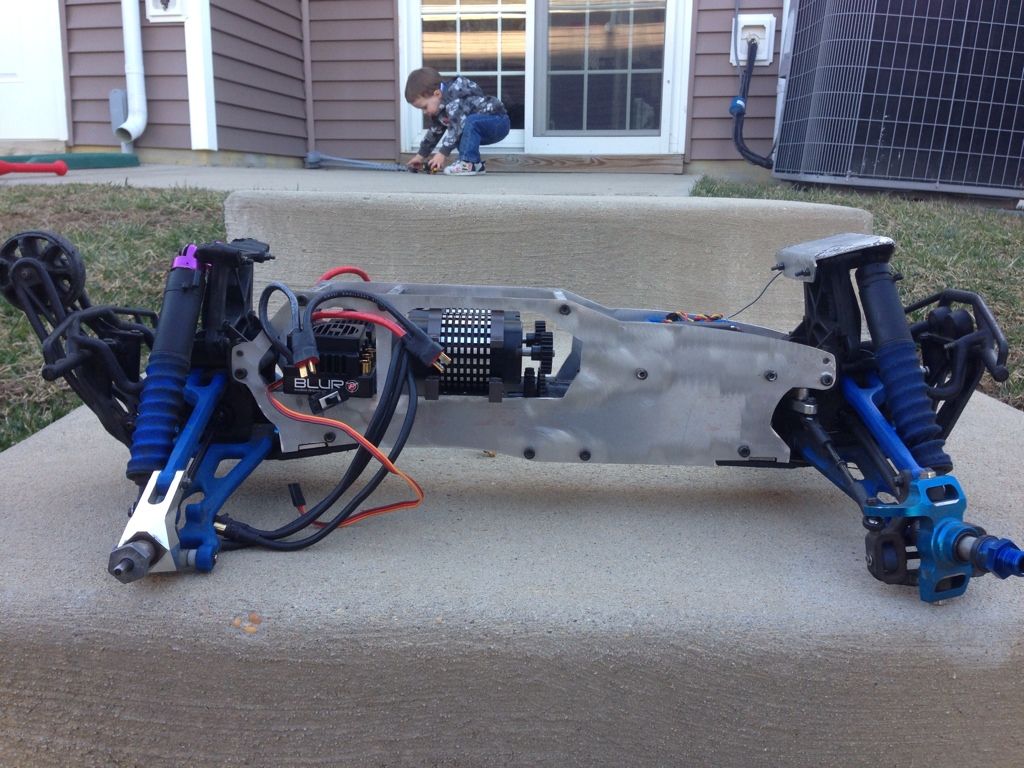

My center diff XL flux can still do 40mph backflips. Yes it is an amazing sight. I've got some pretty cool pics of the truck flippin I have to find. Ill share when I do.
As of now I'm just using the two 2200kv motors, I have the Y jumper for the esc's and will be removing one red wire from one esc so only one powers it lol. The issue now is mounting the motors nice and low and still having room for four 3s battery's. looks like my gearing will be 25/46t with a net speed of 116 or 118mph
