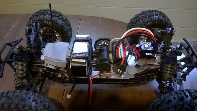

Hey finally got a new body and some new kicks for the old girl . i have been experimenting with motors in this truck , alternating a castle 1518,1520,and 1717. believe it or not the 1518 seems to have the most power ? i honeslty think i need a new 6s lipo to get the most out of the 1717. any way here are some pics .

Your current 6s may be tired but the kv difference also plays a role in how powerful it feels. This is especially true if you're using the same gearing with each motor. If you change the gearing to keep top speed the same between each motor the differences would become more apparent.
I've personally had all 3 of these as well. Loved them all, especially the 1518 and 1717. The 1518 is a little animal with a killer midrange. IMO the 1520 feels similar to the 1717 but a bit quicker to react to throttle changes than the 1717's larger diameter rotor when making mid air corrections. When compared to the 1518 the 1520 and 1717 do feel a little flat, powerful but in a broader, flatter power curve.

Yeah I plan on keeping them all thanks for the advice I put the 1717 back in along with a 28 tooth pinion . Seems to pull harder with the new 5s lipo i am running . I think i will try the new Graphene 6s 65c lipo and see what that does .
