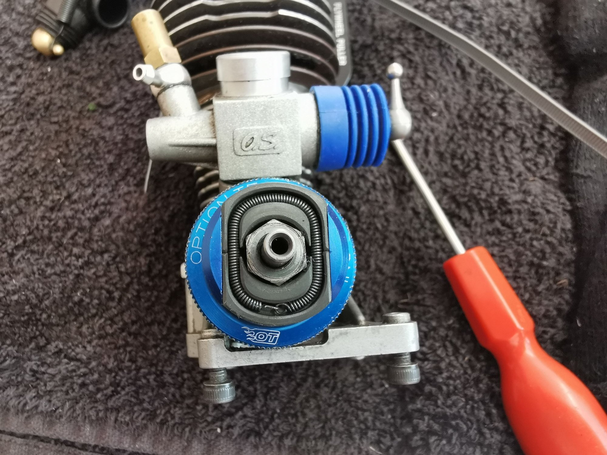

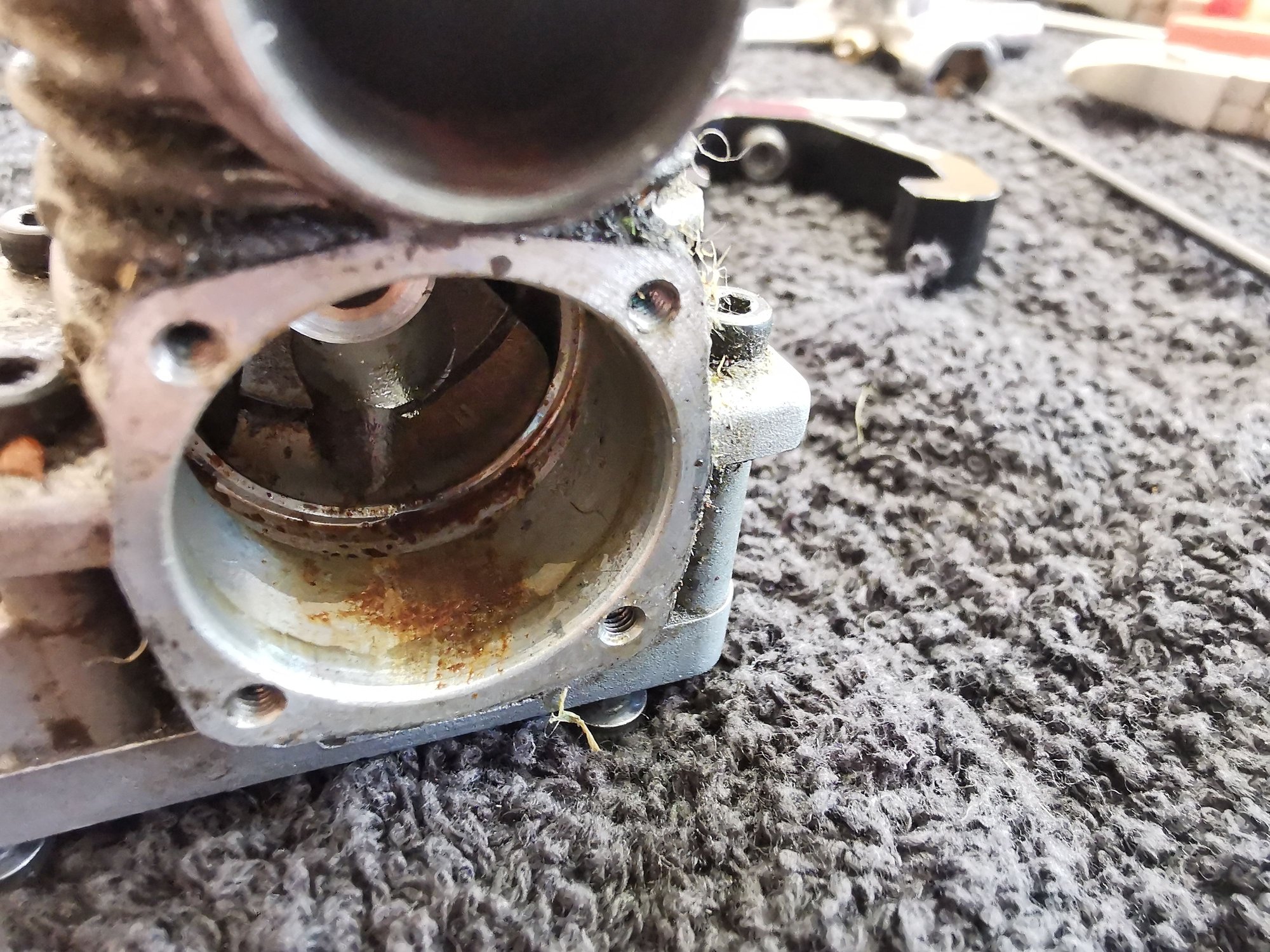

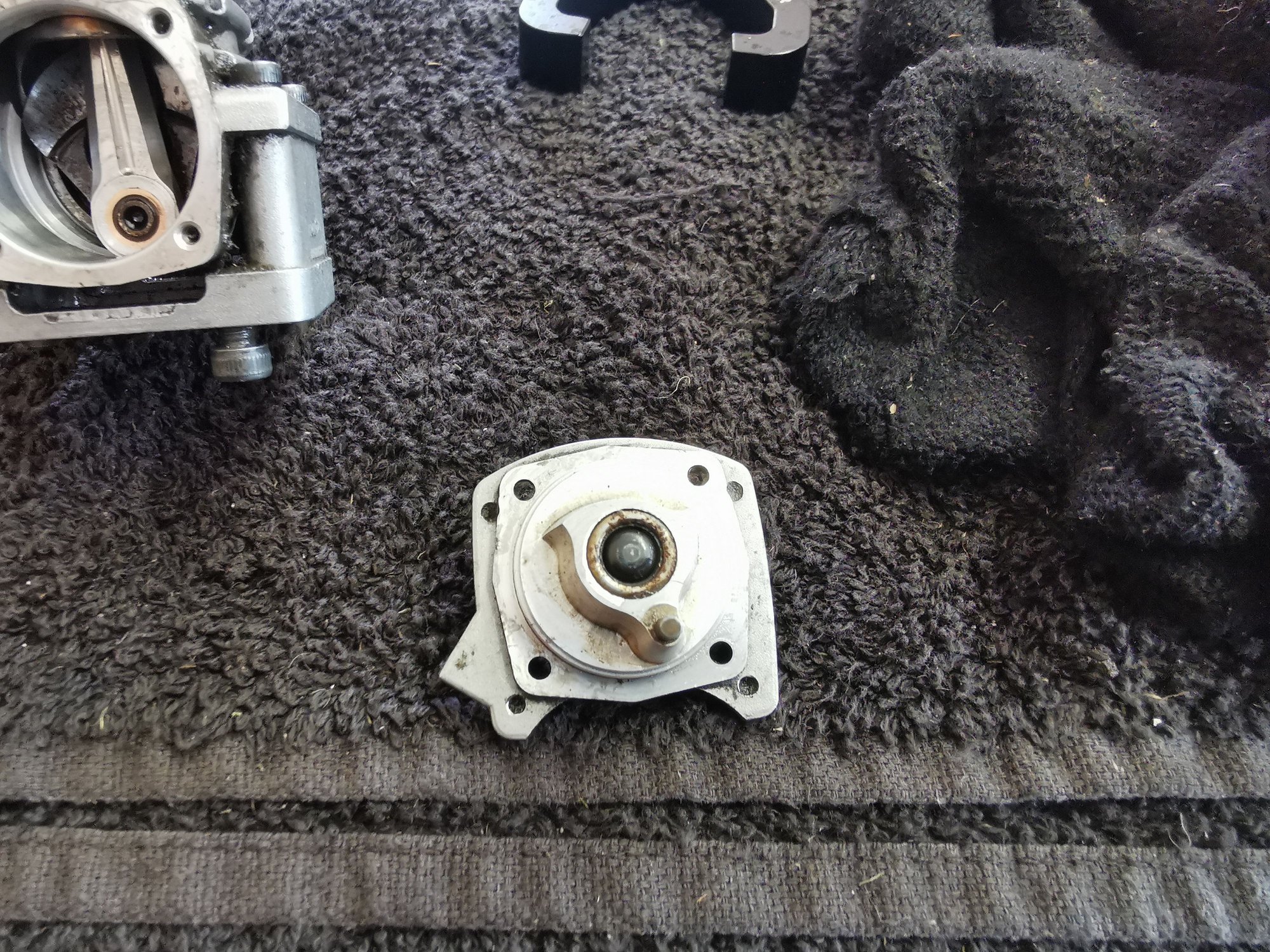

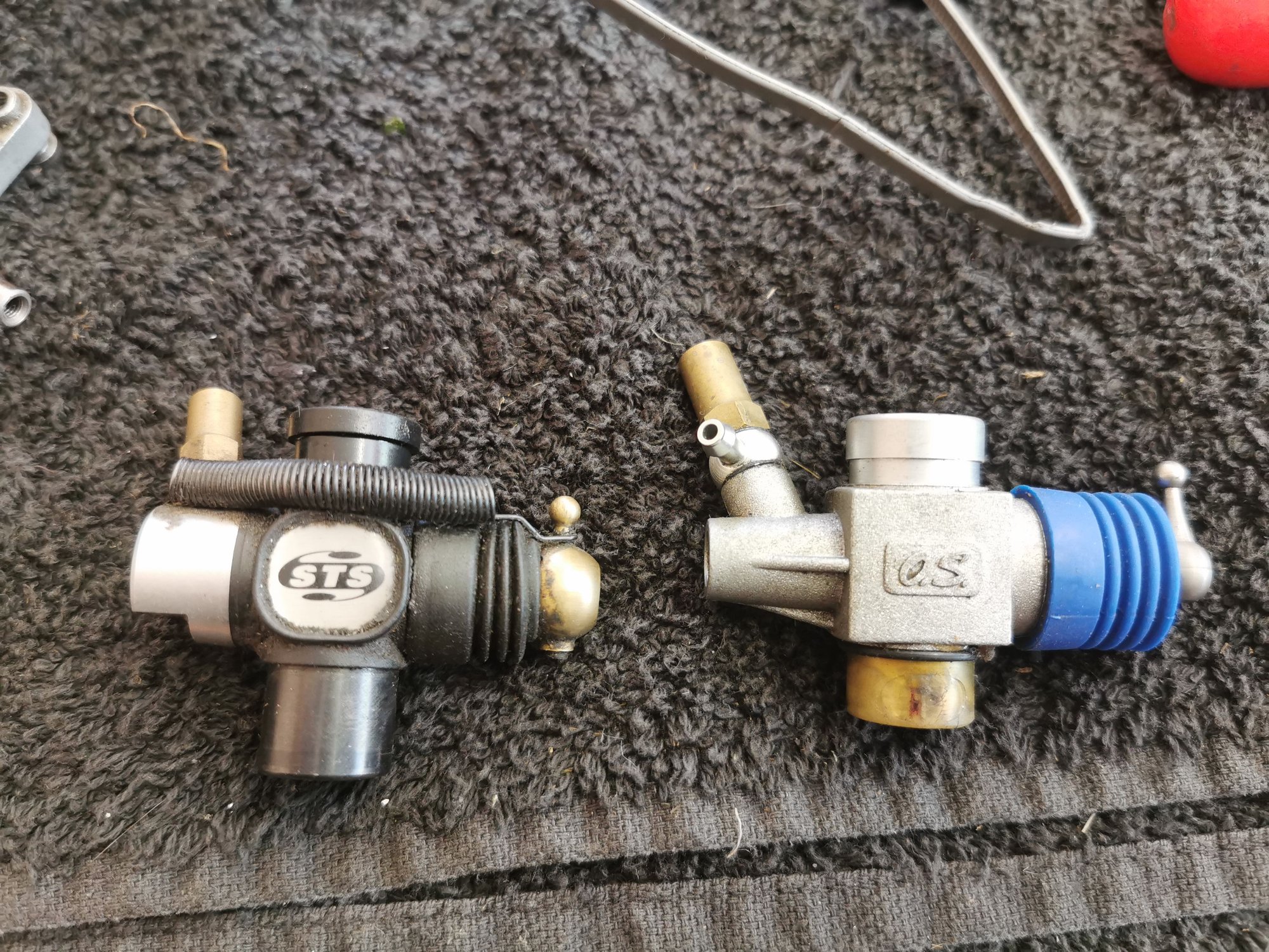

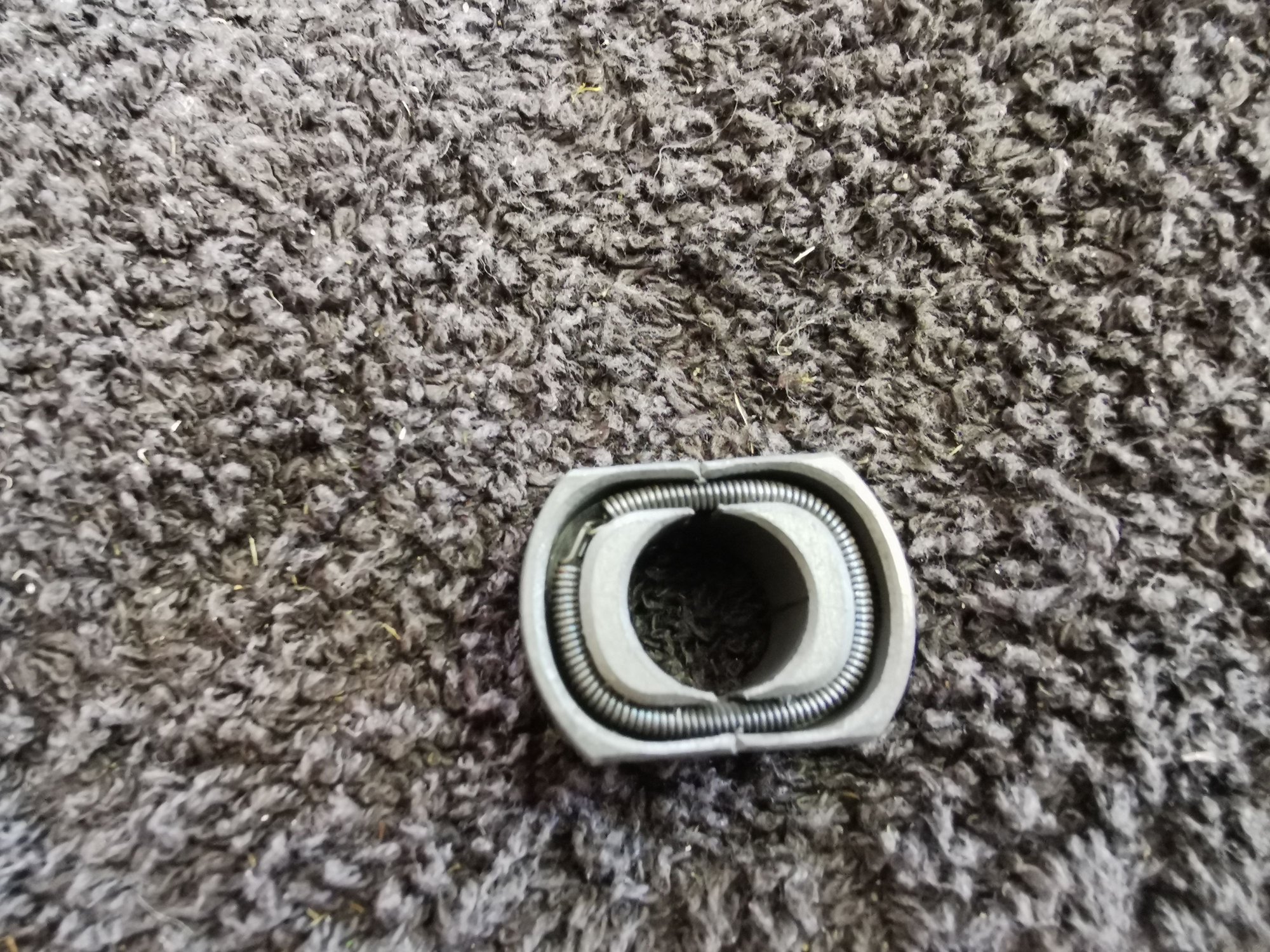

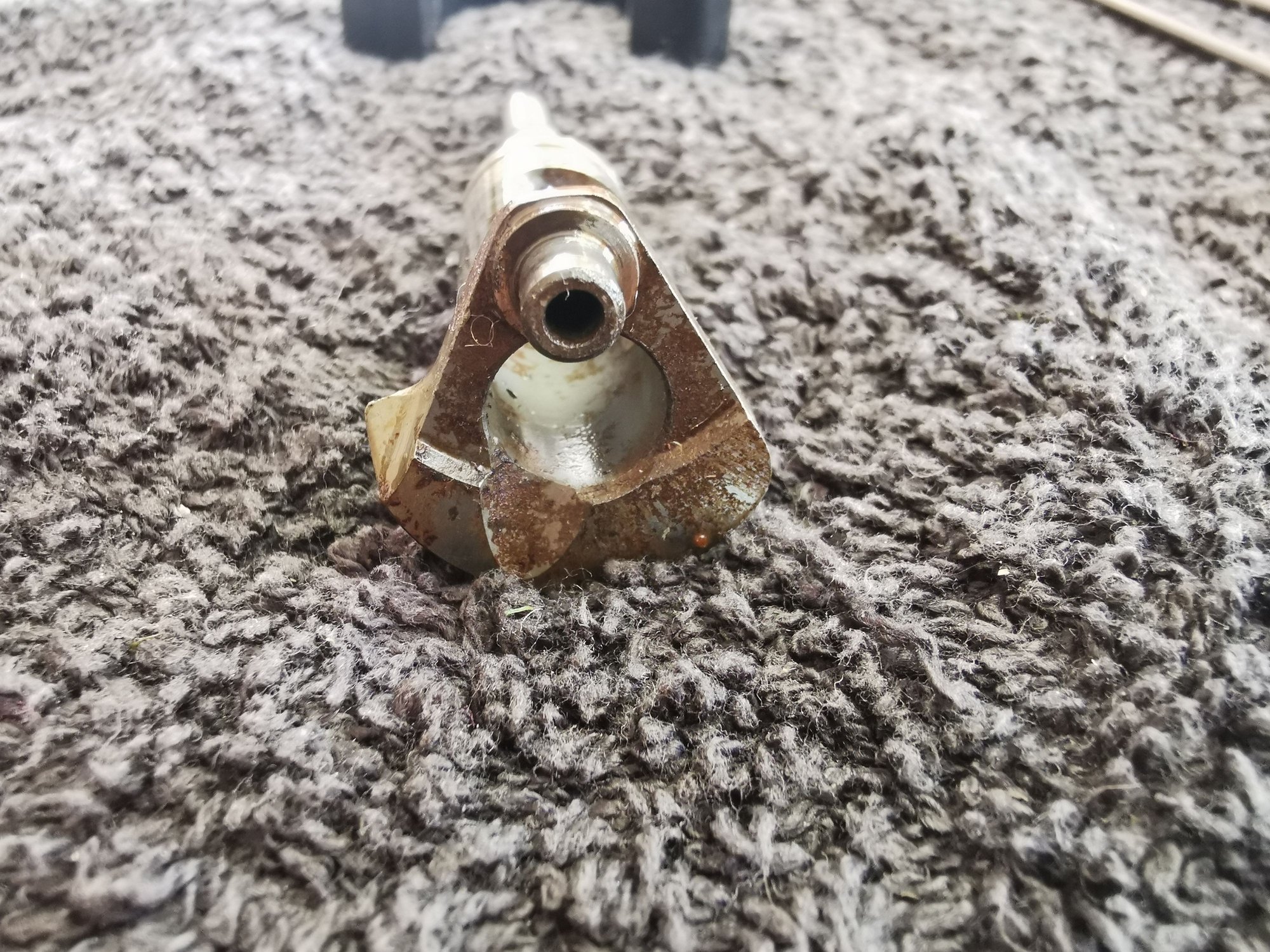

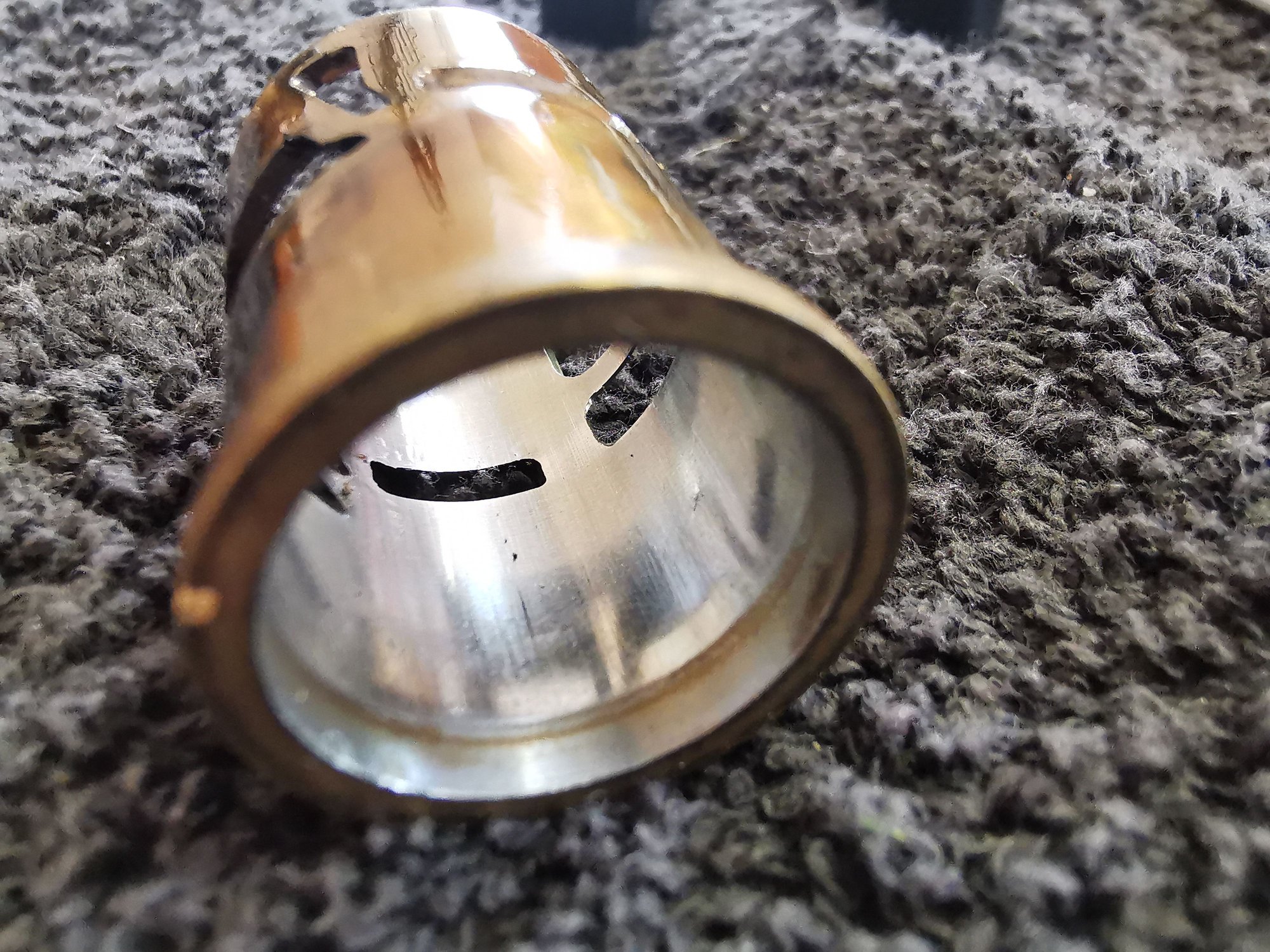

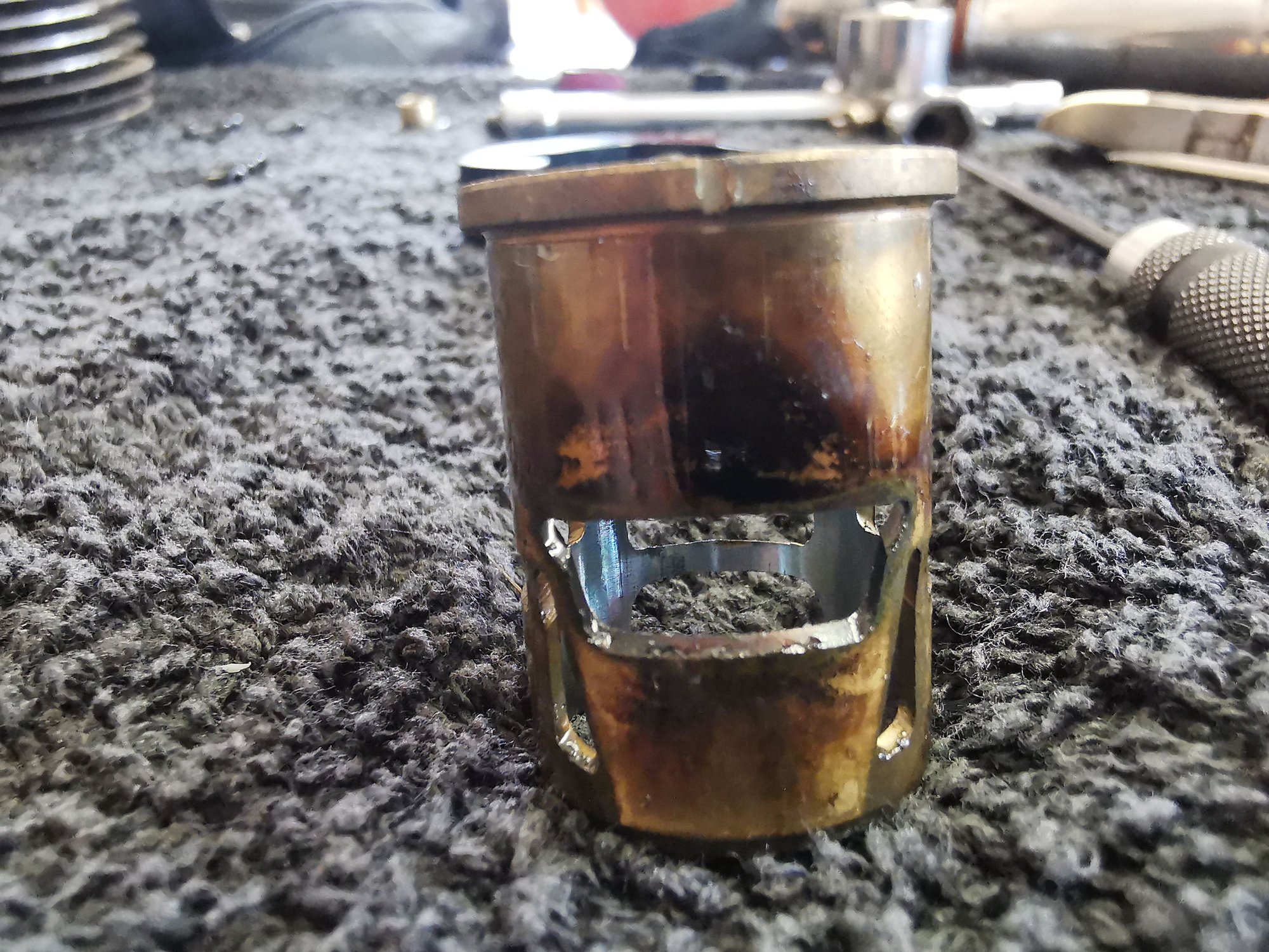

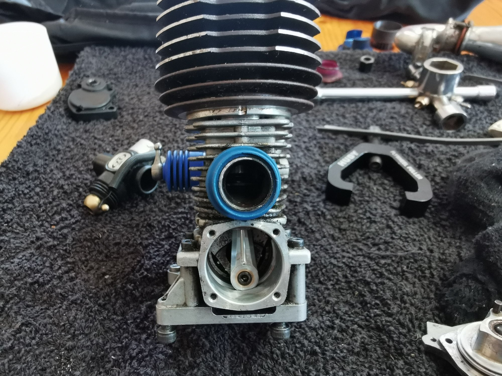

OK, so the STS decided that it didn't want to run properly - specifically, it refused to idle no matter what I tried. It revved fine and ran at speed, no worries. As soon as I let the revs drop - stalled.
Initially, I thought carb. Then, I could feel what I thought was a really gritty, knackered front/main bearing.
Turns out, the bearings are actually fine. ​​​​​The gritty feel was actually an issue with the rotostart backplate, now sorted.
The idle issue was to do with the carb. The STS carb could get sticky, so at some point, the carb will be stripped and made good. In the meantime, the OS carb was used. In fairness, it's a better carb.
The clutch - still mint after all these years!
Gumming at bottom of crankcase
Sleeve has good pinch and chrome is all good
Tarnish shows years of use on 5 port sleeve
Crank is in good order with a little gumming
Reassembly following cleaning of all parts
OS carb next to STS
Backplate and one way needed servicing

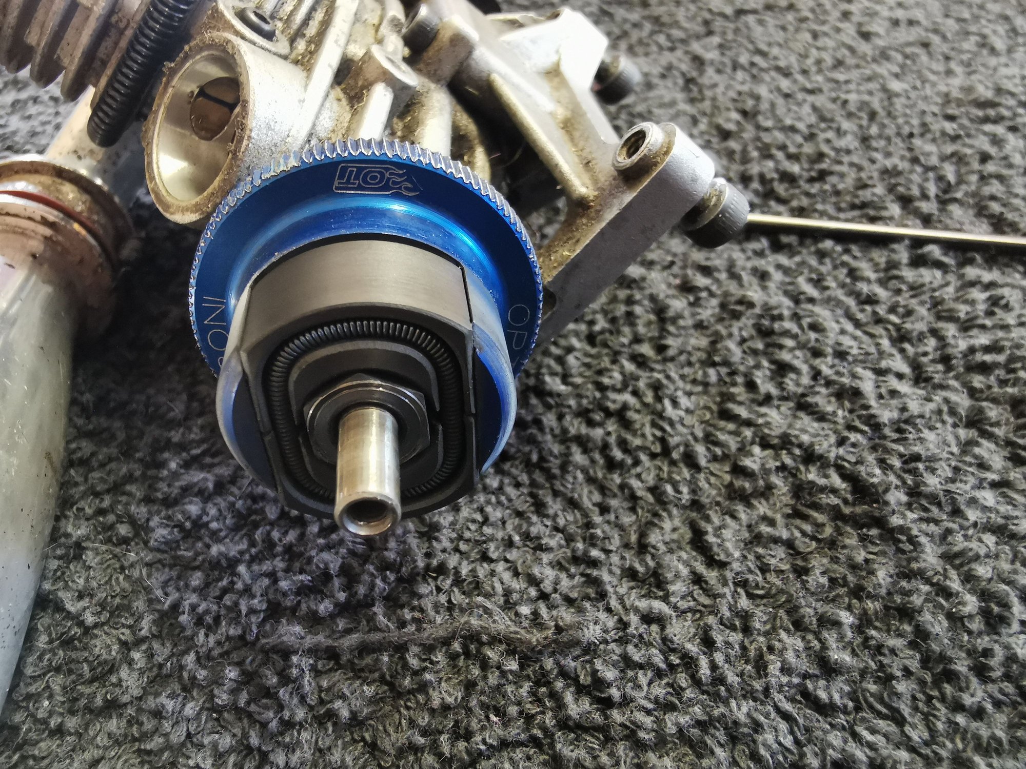

Clutch was given a clean, degrease and lightly sanded to remove any glaze, carb fitted
Engine ready to go...
After fitting back in the truck and firing up, the only thing required was a quick adjustment of the needles. Throttling is great and tickover simply rock solid with this carb. The STS carb was not a bad bit of kit by any stretch, but this OS item is just so silky smooth and well engineered. It's pretty rare you see metal bodied carbs in this day and age, so it's certainly different! Last time this saw use was on an OS. 21 VZB V Spec in an MBX4 RR buggy!
Tomorrow, I'll strip the STS carb and see what's gone wrong with it. It may just be debris or a perished o-ring. Guess we'll see.

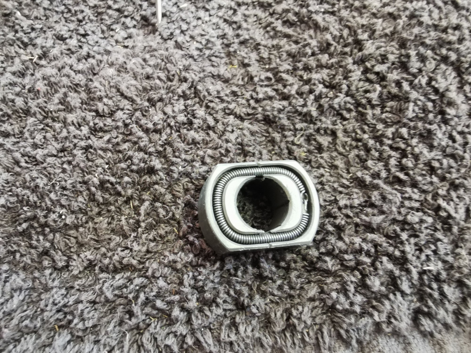

your clutch shoe is upside down
On one side, the groove has room for 2 springs. The other has a groove for 1 spring. I use 2 springs, 1 each side.
Deeper side
Shallow side
The footprint and action of the shoes is symmetrical and Fioroni don't actually specify that there is an upside or a downside. The shoes with springs just slide over the nut. The shoes operate exactly the same either way round and as you can see, last forever. 👍

look at the bottom where the shoe sits in the flywheel, it is beveled on the flywheel, the shoe is flat on one side and beveled on the other. you have the beveled side up.it will still work the shoe just wont sit flat on the flywheel and could cause some binding. its also why your shoes appear to be not sitting flat against your flywheel in the first picture
