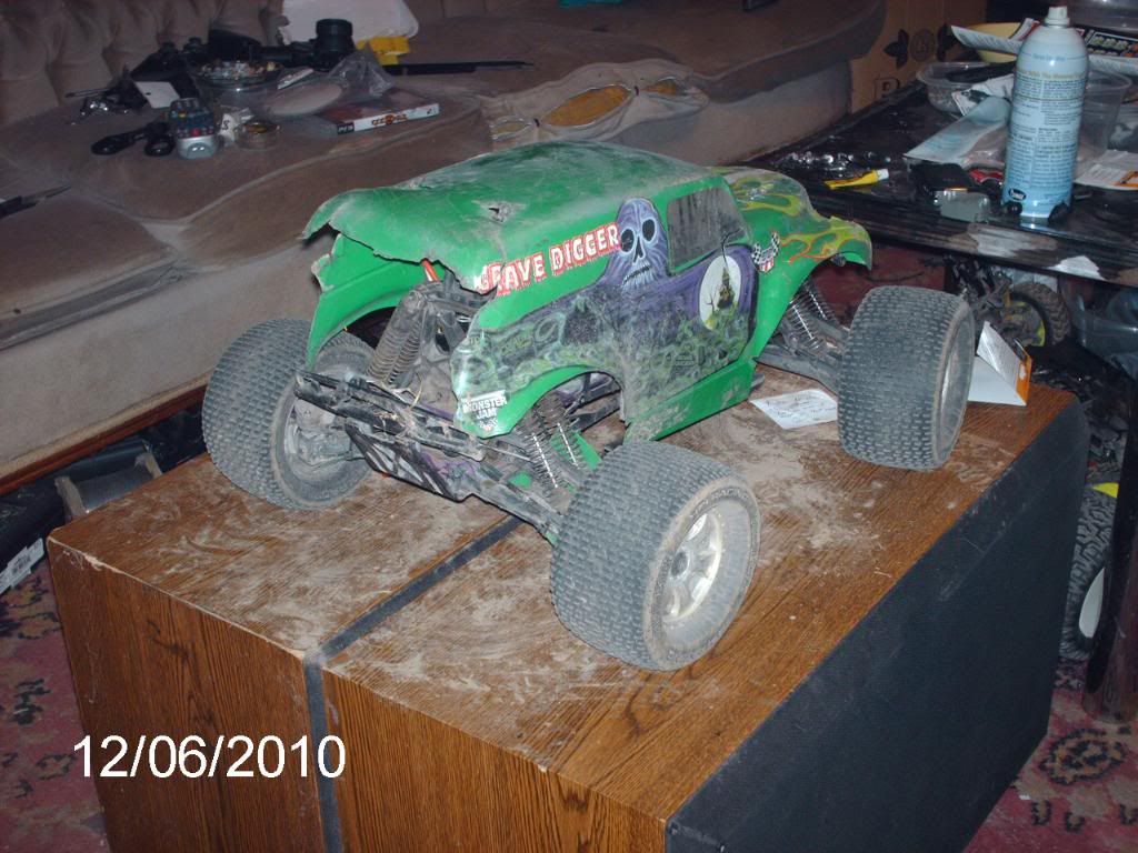

yah we could get into a real nitro/ brushless debate but how about we just show off our creations. this is a hobby man, each side has it points and have all the fuels and rc's to burn them up so i love them all.
this is my savage x monster.
i built it back before the flux was even a wisper on any tougnes so parts and ideas where rare!
somehow my good lhs got me a 44 tooth gear to lock the tranny even before hpi had the flux on the site.
i say good lhs store because i used to go to laval and got ripped off on a bad esc that should have been warrantied( first model...all bullet connectors)
then my second esc burned up after a short run and castle blammed my batteries! soo i need new batteries ... now... but my third esc is still smelling nice, which is more that i can say for the closet the second esc is in! lol
what was that about budget ????

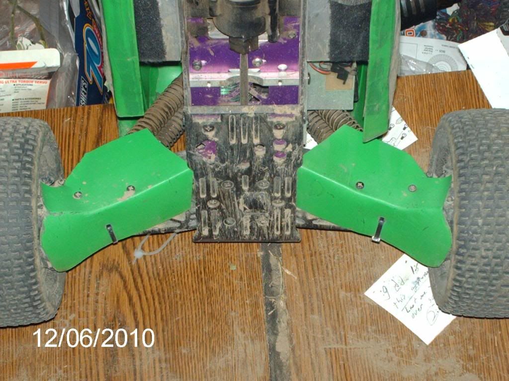

i also put in the bulletproof gears front and back, the 39 tooth solid tranny gear instead of 44, the sway bar set and i made i set of rear protectors from left over body trim pieces i just can never seem to finish finding uses for.
