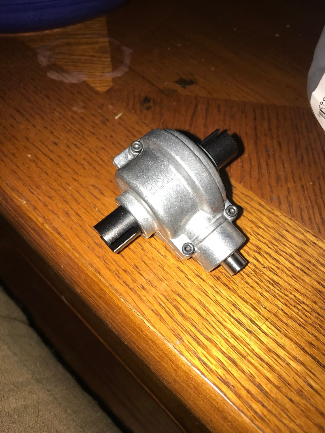

Got my heavy duty differential built:
Specifications:
Losi aluminum diff housing with locktighed screws
New losi 8x 10 bearings all the way around
New ring and pinion
New spiders gears
Heavy duty differential case
Heavy duty hardened outdrives
White lithium grease on ring, pinion, and outdrives
7000 weight diff fluid( all the hobby shop had, figured itís better then just pure grease)
This is the first diff Iíve ever broke into, and built. Seems to spin flawlessly, one strange thing is that I didnít need to use a single shim(besides the thick one that goes between two bearings on the pinion gear shaft) on the outdrives, or the ring gear area. Nothing binds, and it doesnít feel too ďlooseĒ or too tight either. I know every part is machined and made to slightly different tolerances, But is that in the realm of possibility to not have to shima diff built with all new parts? I tried adding one 13 mm shim to the ring gear/ bearing side, and once assembled the diff unit was so tight I couldnít hardly turn the outdrives so I took it out. Anyway, I think my diff is good to go, and should hold up to the gentle thrashing I plan on giving this truck. Thanks for looking everyone, have a great evening.

man thats a nice looking diff! it is possible to not have to shim, have had the weird occasion where that happens, very few times, but it does happen.
as long as there is no binding, and as little play as you can get.
snowman49 is offline

alright thanks for the information man, Iím going to assume my diff is correctly assembled then.. it feels and looks good at least. And yes this truck is incredible. It feels good to have a classic, weird to think that in 4 years these lstís will be 20 years old or so. Excellent trucks, and as IĎVe worked on it, I realized itís super well built and easy to work on in the grand scheme of things.
