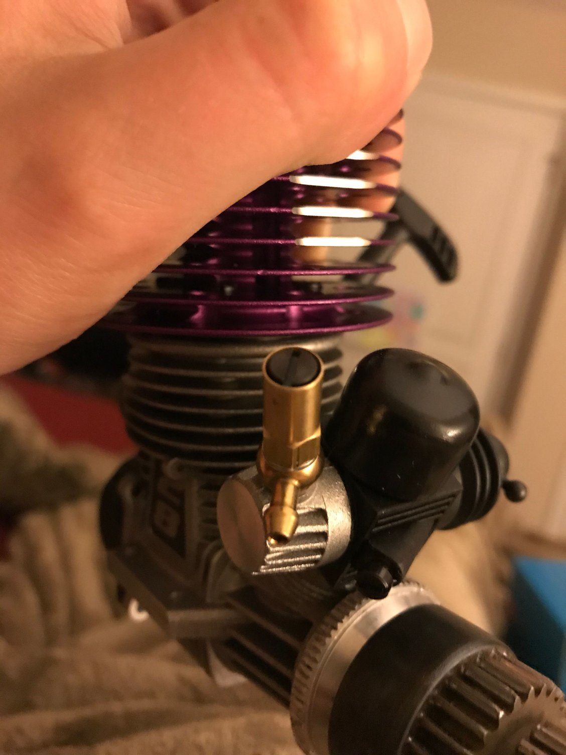

Hey guys, not much action on the lst lately. But I did have a little something come in:
Nova .28 tuned by an Italian guy name Ielasi. This one is a 3 port as opposed to the 28-8port model. I figured this would be a little more tame and controllable, but I literally canít find a single review or feedback on this engine. So Iím taking a gamble and hope it works out better then my prior experience
Quick question for you fine folks... in terms of the high speed needle housing( not the needle itself but the brass fitting in which it resides), does the fuel nipple banjo hole have to line up perfectly with the brass high speed housing hole when changing location of the fuel banjo? This carb comes installed the opposite orientation needed for the LST, I already switched it, I already replaced the aluminum high speed needle washers that seal the banjo and housing together, and to the carb( a must when changing banjo placement per novarossi). Am I overthinking things? I must be because I donít see how you would even have the ability to move the fuel nipple banjo for each particular vehicle application if it only had one correct orientation. I hope this question makes sense. canít wait to try this again. I didnít realize this engine had a long low speed needle, which apparently tunes completely different then a short low speed needle carb. Found a group of youtubers struggling to get tunes on their 28-8 truggy motor and other long low speed needle nova; they all literally had the exact same issues i was having, to a tee. Wish me luck guys , hopefully break in on Saturday.

the banjo fitting is hollow, you can rotate it however you like. it will fill and act pneumatically pressured no matter the orientation.
in the FB group im in one or two of the guys love thoseLelasi tuned engines, but the ones they were talking about were small blocks.
check out: Ielasi Tuned USA on FB if you have one.
not a clue on long needle carbs though man sorry.
sucks to hear others are having that issue, hope it was just a bad batch.
i have re-used those washers with good luck, but typically very little to no use at the time.
(did fine on one or two that were used a bit before i had removed them, but if possible i would swap them.)
really hope that engine works out for you so you can actually enjoy your truck.

alright buddy thank you for the info. I figured I was over thinking the banjo orientation. And Iím glad to hear about the washers being reusable. I figured if they were unused, they would be fine to use again after tightening and setting the fuel nipple banjo position. Luckily, novarossi includes two spares so I just reinstalled the new ones, and saved the original washers just in case. In terms of the low speed needle design, itís not really a flaw, and from what I gather they just tune differently then any other sport engine or even a race grade engine. Most carbs have short low speed needles, that pull completely out of the throttle slide at say 50 percent throttle. The long low speed needle design never actually pulls completely out of the throttle slide, and to make it even more confusing the low speed is apparently responsible for fuel duties almost up to 75% throttle or more, and has a direct impact on the high speed needle setting. From what I gather, Iím supposed to set the low speed first, then barely lean the high speed needle after setting the low. Then after all that I go back and fine tune the idle speed needle to get a steady, consistent idle. Most engines(and the way I always tunes), requires you to set the high speed needle first, dial in the low speed second, then just fine tune your idle screw after all those are set. Basically, your supposed to tune this engine backwards which has been throwing everyone through a loop. Not sure why they would make a pull start/truggy engine with such a backwards, complicated carb design that completely reverses the standard tuning principles, but they did. Everyone on YouTube has made strides though in tuning the low speed first, getting a nice steady(but high as well) idle, then lowering the idle screw a touch, then tuning the high speed beedle(barely since nova likes rich high speed needle settings, almost flush with the high speed housing), and then after setting that they revisit the low speed, since leaning the high will 100% lean your previously set low speed needle, since they are literally always ďconnectedĒ in the throttle slide. Thanks for the kind words man, i have way more faith this time getting this engine tuned now that I know how I have to tune it. And also, hopefully it doesnít blow oil out of the head button, I know that was an issue with my previous engine, and this engine seems to have a different head button, and cooling head then the other at first glance. Wish me luck

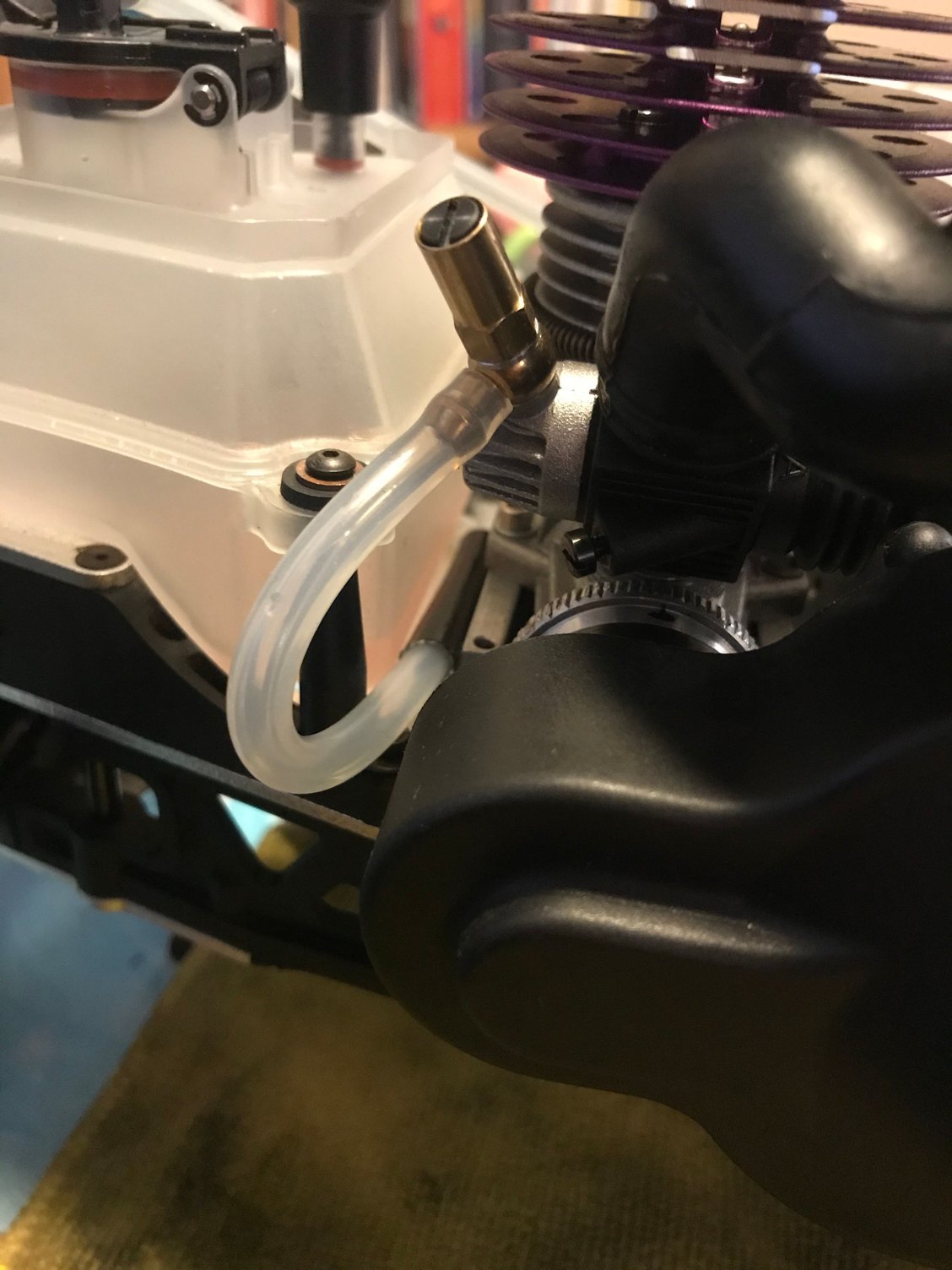

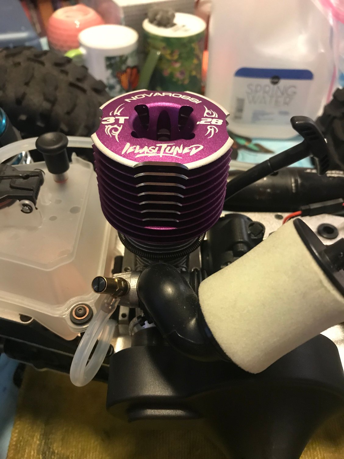

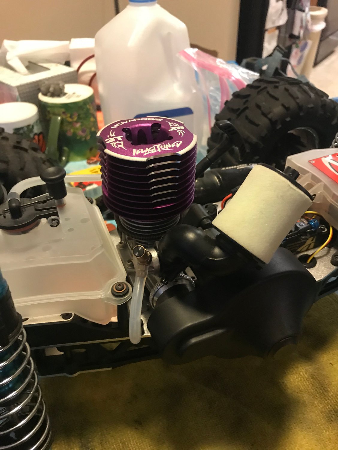

Nova installed.
Another angle.
.28 3 port sleeve. Iím hoping that it will be a little more tame then an equivalent 28-8 port. Really trying to just enjoy this truck and rip it back and forth on the street or some grass. Even though itís kind of been a pain in the behind, I would hate to see this beauty become damaged in any way.
If you look at the fuel line, I installed a Traxxas fiberglass heat shield in between the line and the engine mount. Not sure if itís going to do anything, but in my original set up a few weeks ago, I just had the fuel line sitting right next to the engine mount unprotected. Started thinking more about it and, well...Iím pretty sure that wasnít helping in my previous engine trying to get it tuned and such. This was before I had noticed the defective head button but still.
Anyway, super excited to retry things with this engine. Iím still 99.9 sure my other engine had a defective headbutton that was a major source of my Woes, and I fully expect this one to seal properly. During this whole saga, Iíve replaced numerous parts including a brand new NOS fuel tank, new losi fuel tubing, basically all new transmission with the forward only conversion, new output shaft, greased with white lithium grease, brand new spurs, brand new high and low speed hubs with bearings, fiberglass heat shield for fuel tubing,and brand new avid exhaust gaskets. I feel much more prepared, and I feel the truck overall is in much better shape then before. Weather is supposed to be garbage this weekend, but if for some reason itís sunny for 3-4 hours and it dries up enough, I will do the first break in tank. Thanks again to all you nitro heads. Take care
