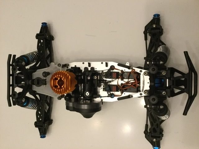

i tore this thing down quite a bit to clean and make sure that everything was in working order before running, for some reason im alot more "nit-picky" with this truck than my MGTs, try keeping the truck almost spotless, and in tip top shape whenever possible.
upon disassembly for cleaning many of the 4-40 flathead screws ended up getting stripped, which given they are 1/16" in size hex, and having the "L" wrenches which are terrible in their own right, doesnt surprise me almost all of them i was trying to remove stripped. i did learn though a T7 torx but seems to work well in place of the the allen, have since purchased a dynamite 1/16" hex driver and am loving it!!!
Got a FOC for the truck, and have a chassis brace in the mail. (Mine is not broken, but I had been reading the cast aluminum is prone to cracking). Got some aluminum plate that I need to cut up to make a skid, wanting to do the full skid as well for protecting servos.
God i hate how losi used 1/16 Allen's for everything exposed on the bottom... anything into metal and the screws was stripped instantly, found a thread where they put 3mm screws instead that I may try. The screw into the bevel gear in the tranny was a joke too... really wasn't as much weight as I though that was removed with the foc.

was running into issues. typically it started pretty easy, but kept on not feeding fuel correctly.
pulled off the tank and going to seal up the primer button.
symptoms of running not right:
started fine after priming, blip throttle a few times while stationary-> after a about 15-30 seconds of idling and blipping will cut out and die. have to re-prime the fuel to the carb, (can see air bubbles building right outside the carb).
after re-prime-> will fire up quickly then burn through fuel and repeat of above.
few tries of this and slowly working the throttle to keep it running able to run it a few circles.
while running those circles-> high idle and or idle hangs.
cuts out after a minute or two of running around with above symptoms, idle drops to normal then cuts out after a few seconds-> again air bubbles before carb.
ended up pulling the tank, and removing the primer button, re-routed/replaced the fuel lines, replaced exhaust gaskets, replaced all o-rings in the carb and has since seemed to work just fine and all were definitely needed. carb o-rings were definitely bad
while doing all the above i noticed that my spur gear had one chipped tooth, was still running alright but ordered 2 sets anyways just to have them on hand.
got the o-ring kit and the exhaust coupler set in today, went ahead and sealed the engine too. dont really know how necessary it was as the backplate has an o-ring, and the carb has dual o-rings.
the upper carb o-ring was definitely shot, as were the needle o-rings. were about as hard as a rock. got some green slime too to put on the new rings.
One of those weird things that my LHS actually stocks. i finally convinced them to carry ARO and Air filter oil and sold out within 2 days. (have since actualy started keeping them in stock and stock a few air filters, more variety of fuel, now just wish they would have a broader range of glow plugs.)
spur is in the mail, gonna baby this one for now until it either gives up, or new ones get in.
got to run it again last night, still having some issues, decided to run it with 20%, seems alot more stable to tune, realized that the engine seal kit i got did not include the Idle o-ring (didnt even think about that needle when i was installing), and after a minute or two of running noticed i was noticing some fuel seeping through it. For now made another O-ring work, as it was also really stiff, but ordering another seal kit to put the right one in. burned through my 30% so I'm swapping everything back to 20%.
on dirt was getting 2nd gear wheelies not even at full throttle, the power out of this mach .26 is insane, just wish wasn't having all these problems with it, but thats not the engines fault at all, only myself to blame.
this ended up gettin the rest of the problems sorted.
