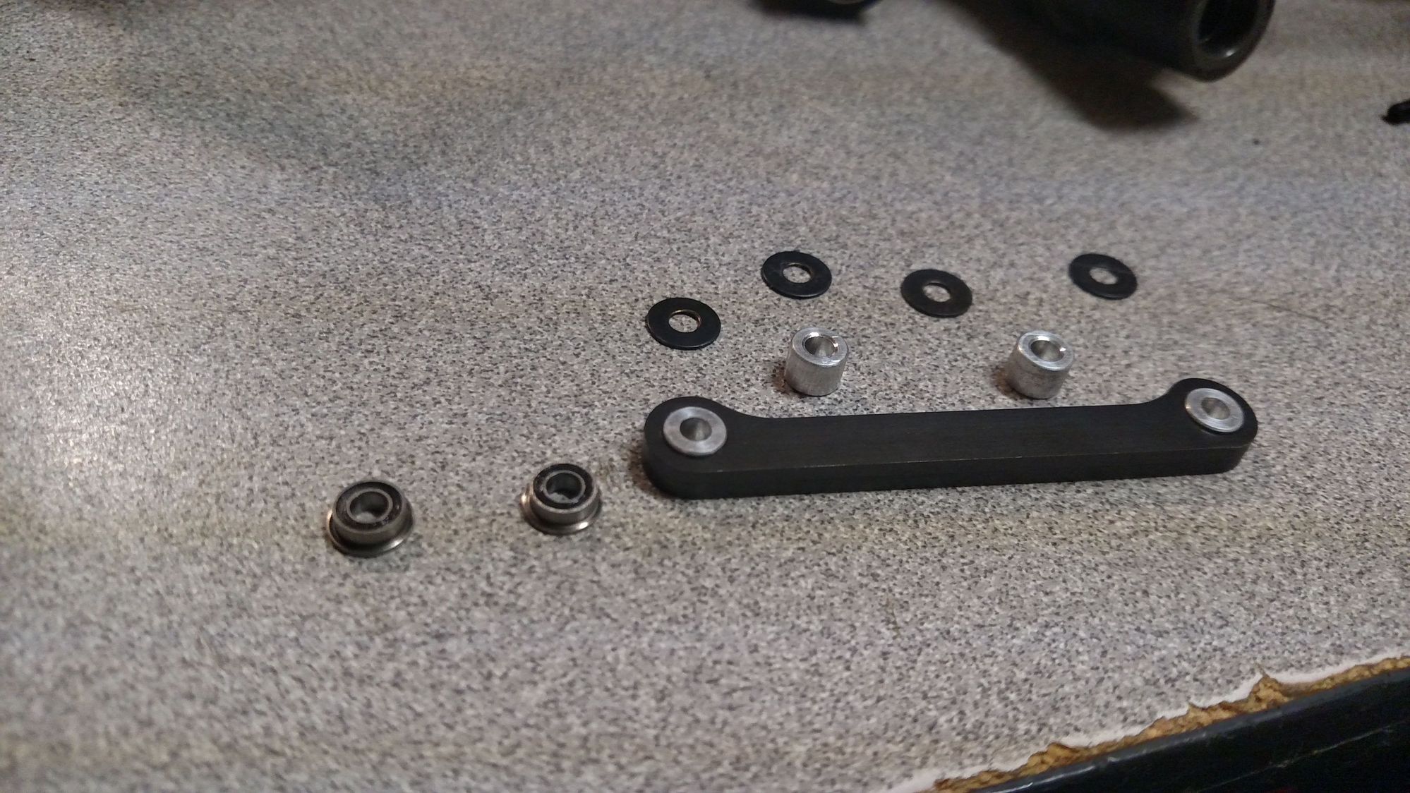

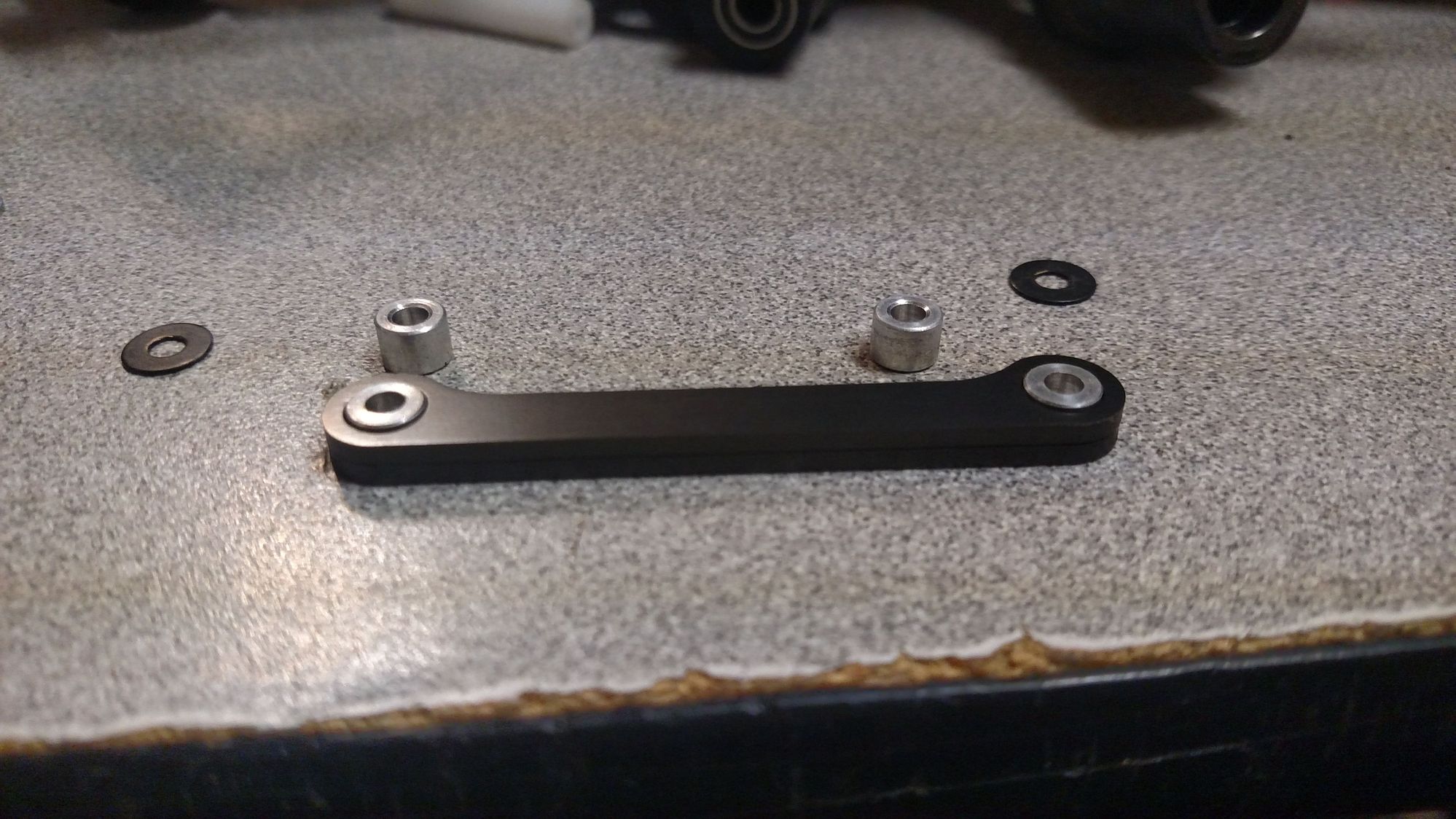

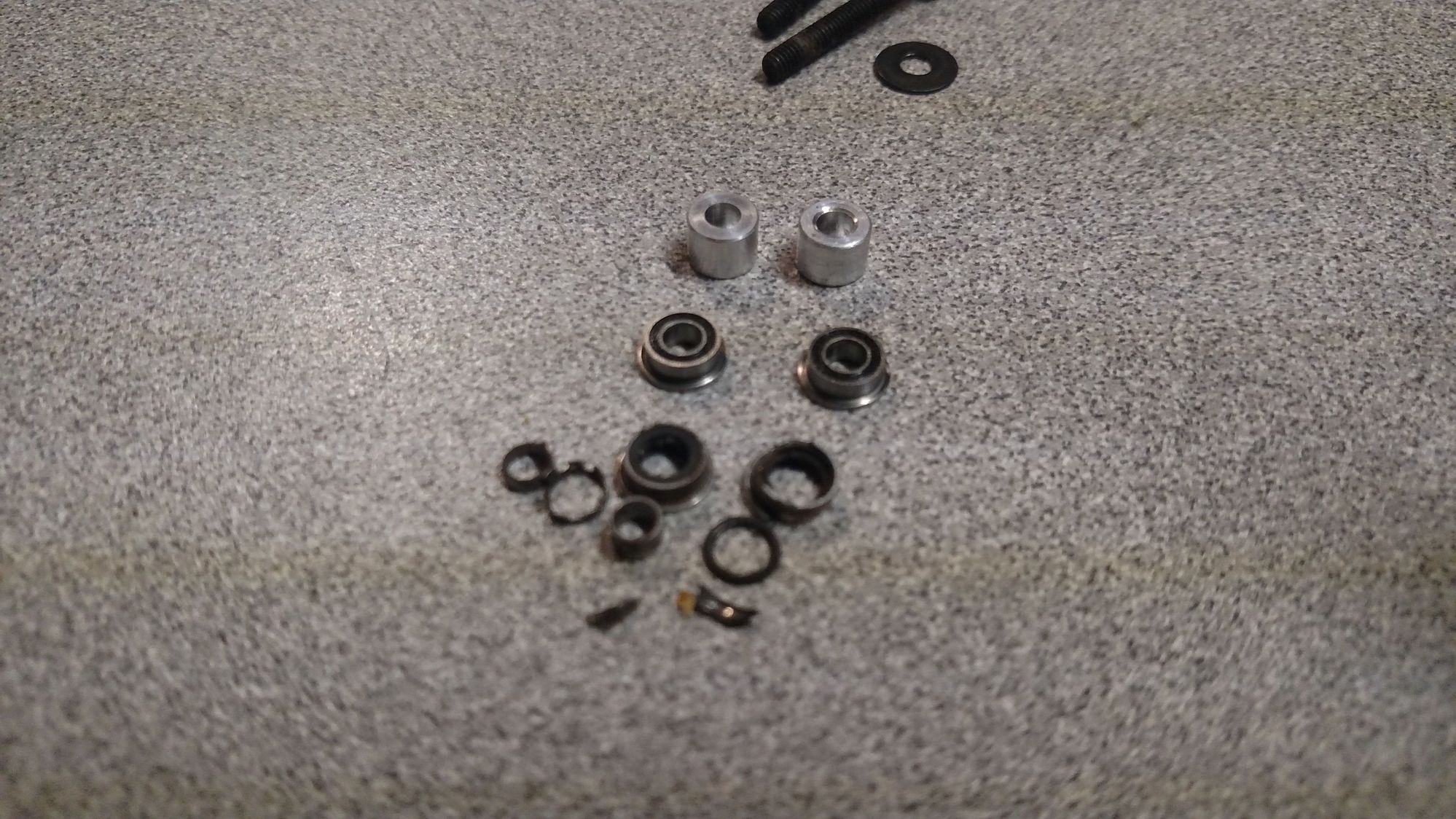

After realizing I was getting tons of worsening wheel slop involving the steering rack, I came up with a simple and effective mod. I discovered the 2 small, ill fitting bearings that the rack pivots on were totally blown. Even new ones don't fit the bolts snugly and are simply not up to task. What I did was stacked 2 racks on top of each other and replaced the bearings with 2 3M aluminum spacers 4mm tall. They are just a smidge taller than the racks allowing movement when installed on the bellcrank. I used 4 thin 3M washers total, one on each end of the spacers. Swapped the 2 3x22mm caphead bolts with 3x25mm button head. So far so good, took almost all the slop away and turns Great!!!
Blown stock crap bearings next to new ones and spacers
Spacer pivots no problem in 2 stacked racks.

Thanks for the tip on the loose steering Rich!!! Just to be clear, you're stacking two steering racks on top of each other in addition to the 4mm 3m spacers? Would you mind getting a picture of it all mounted up?
