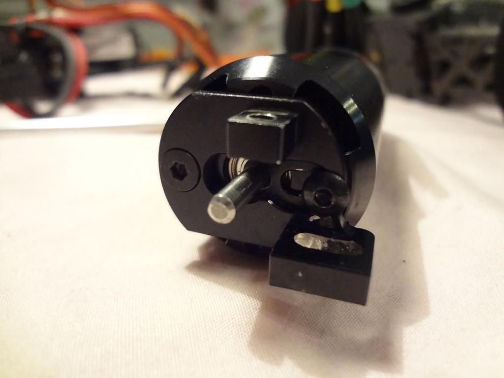

this is all good stuff. my car is back up again after fixing the rear diff gear, havent driven it that much after the power upgrade.
Seems like im suffering from what you discovered earlier with the motor sliding out of position and pinion gets on the spur with an angle.. have happened two times now, i cleaned off the screws and threads on the motor mount and used some blue loctite there and tightened it all i could now.. I guess ill have to do something similar to your vent fix there if it happens again..
It will happen again, just hit some nice jumps.

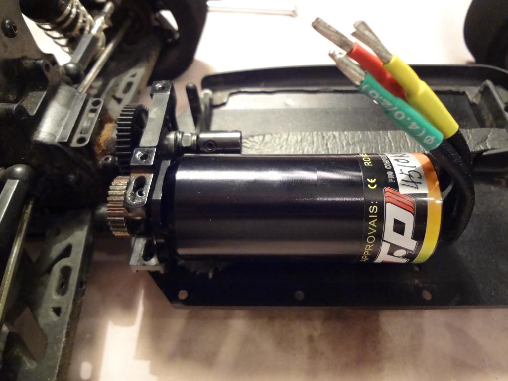

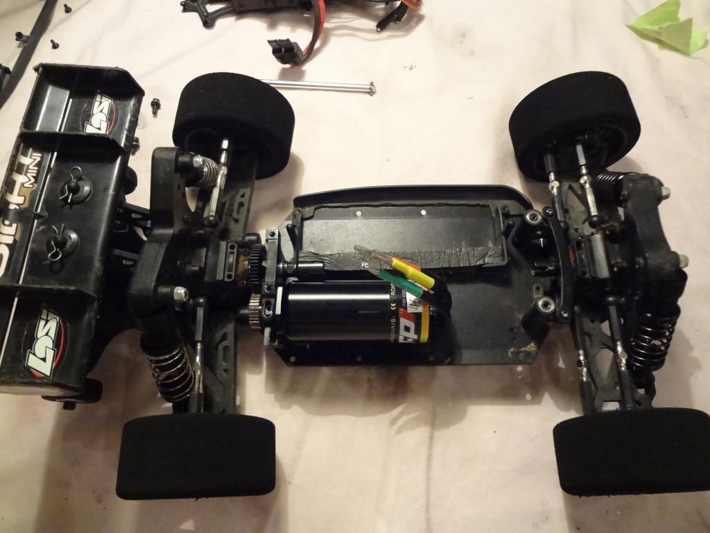

This TP2940 is on my buggy, not the truggy.
The screw hole spacing is not a direct fit. I had to widen that slot out to get that screw in there.
Instead of butchering up my chassis to fit this 29mm can, I wanted to try shimming up the motor mount and gear boxes. I used (4) M3 washers on each screw for a height increase of 2mm.
It just barely fits in.
I had to cut part of the servo and servo mount in order to fit this monster. This wouldn't be necessary on the truggy.
This thing takes up half the chassis!
Foams are a requirement for what this buggy is about to see. This motor produces up to 1600W, which is twice as much as the Leopard 2845 that was just in it.

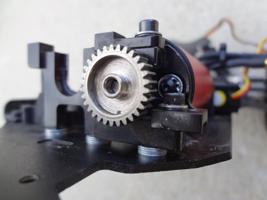

After thinking about the motor fitment, I think a better idea would be to cut out a complete hole out of the chassis where the motor sits and then jb weld a piece of sheet metal on the bottom side to cover the hole. That gives you the 2mm of space that is needed. Shimming up the gear boxes is not ideal because you lose those support tabs that go into the chassis and it's just a hassle for many reasons.
