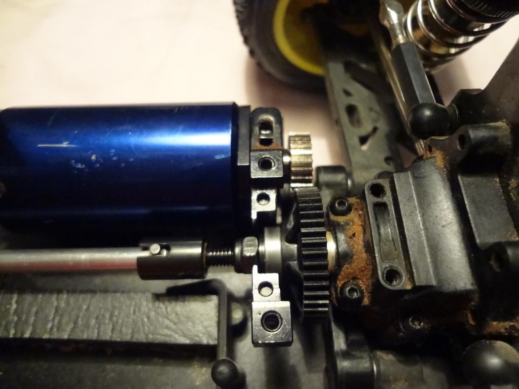

I decided to try out the Traxxas 48P 45T spur gear on my Velineon 380 powered buggy (same application as the truggy). This spur gear is made for the Traxxas 1/16 E-Revo and is available in 45T, 50T, and 55T. It turned out to be the easiest thing in the world to do. It's a direct fit with no modifications needed. I'm going with 25/45 gearing on 3S, for some speed runs.
In order from right to left. Losi pressure plate, Traxxas slipper pad, Traxxas spur gear, Traxxas bearing, Losi small bearing inside of Losi large bearing, 2 Losi washers, Losi nut, done.
In order from right to left. Losi pressure plate, Traxxas slipper pad, Traxxas spur gear, Traxxas bearing, Losi small bearing inside of Losi large bearing, Losi washers, Losi nut, done.
Hum... i made that almost one and an half year ago but on the M8 it toke more washers...but that was the scheme! It works, and last's like if it was on a traxxas 1/16 rc. And i never stripped a spur and still using the same on my pink monster m8, but i don't put it on dirt/debris.. just speed runs till batery emptys

Version 2
Losi pressure plate, Traxxas slipper pad, Traxxas spur gear, Traxxas bearing, washer, Losi small bearing inside of Losi large bearing, Traxxas bearing, 3 Losi washers, Losi nut.
