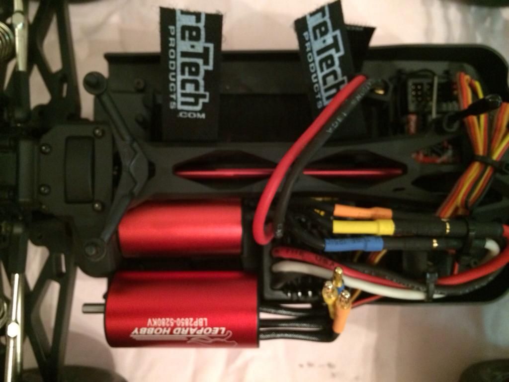

-What's the space between end of motor and ESC? Around 2cm? More less?
-The MMP is without the fan? Why? any reason for it?

Originally Posted by targetingxmod View Post
2 questions:
I have around 7mm of space between the motor and ESC. My motor is 48mm in length. So that would be a maximum of around 55mm of space if you mounted your MMP ESC in that location. Or you could mount the ESC on the top plate and run a long can Leopard 2860 or Neu 1115 and then run 6S for insanity.
I originally had the MMP on my Mini E-Revo and I cut the fan off for better fitment.

Originally Posted by 0verkill View Post
I have around 7mm of space between the motor and ESC. My motor is 45mm in length. So that would be a maximum of around 52mm of space if you mounted your MMP ESC in that location. You may be able to squeeze another 1-2mm. Or you could mount the ESC on the top plate and run a long can Leopard 2860 or Neu 1115 and then run 6S for insanity.
That's what i needed to know! But 45mm length according to leopard website is 48mm, and a 50mm lenght by Leopard is a 54mm... So a 2850 should be my bet if want to use the ESC on botton. But don't know if using the ESC on top plate will affect any handling on this m8t!!
And you are saying that the motor at the end of the pack is not hot, just warm using 4s... so that 19T gear pinion is about right for the stock losi spur's! Any idea if a bigger pinion will fit inside the spur gear cover?
By the way... any idea if mounting the ESC on the top plate will afect handling?
Stock Mini8 comes that way...
2860 motor on that seens about right for my stuff... but the ESC on top is an option that i don't know if it is wise...
Using big block motor's (36mm can motors) on the merv ruins it's already weak stability.... but this is a LOSI
targetingxmod is offline
Yup, the 2845 is 48mm in length. I actually have a 2850 motor as well (54mm length) and it should fit fine, you may need to bend the motor wires upward. Well the ESC doesn't weigh too much, so I don't think you would notice much of a difference. But I'd rather have it on the chassis since there's room for it, unlike the buggy. I was just referring to a max effort setup. As far as the motor temperature, it really depends on many factors obviously, but it didn't go beyond 120* on that day. I want to see if I can mount up a mini fan on it to keep it even cooler. Yeah I know what you mean about the merv's stability, it's not made for handling.
