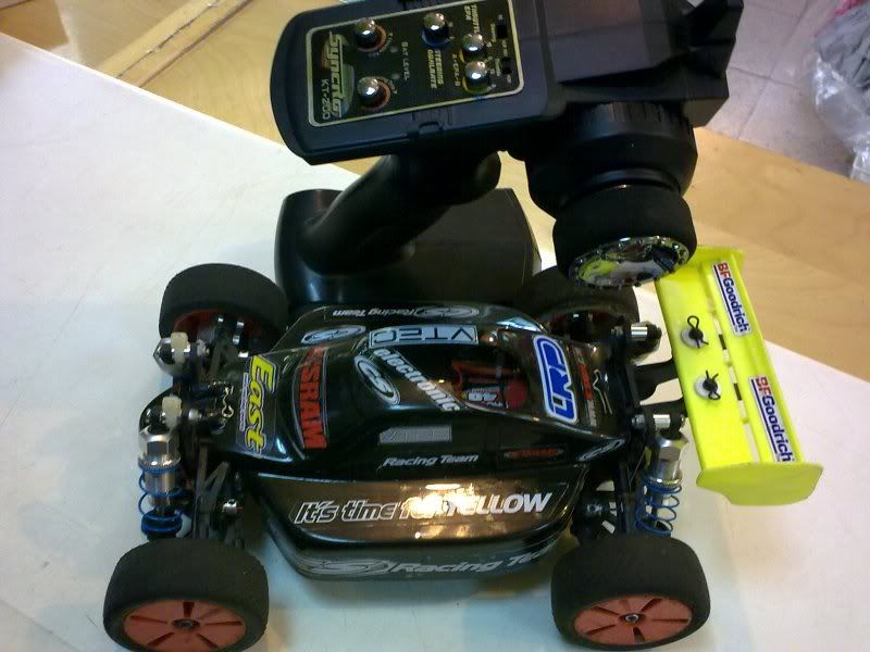

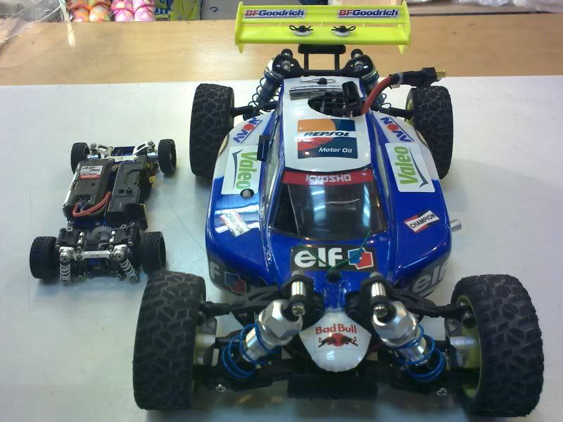

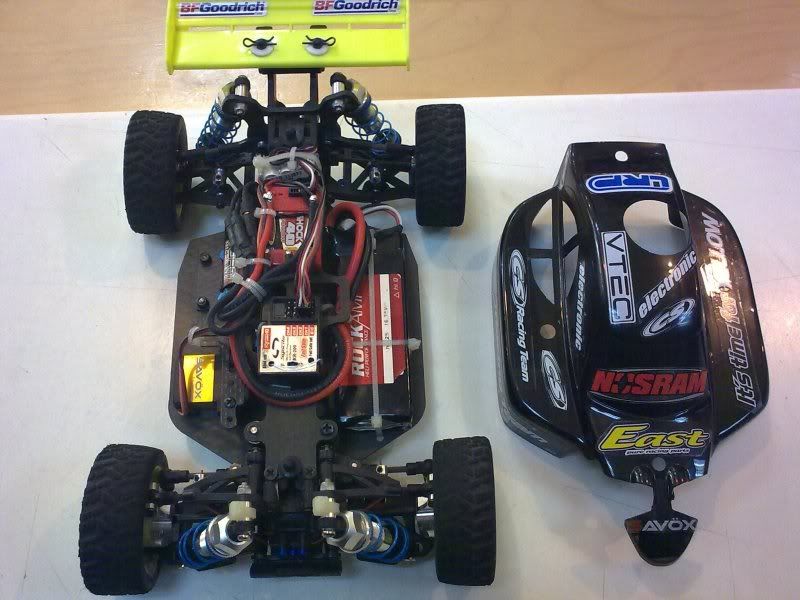

Well i joined some coins, and picked this second hand in Germany!

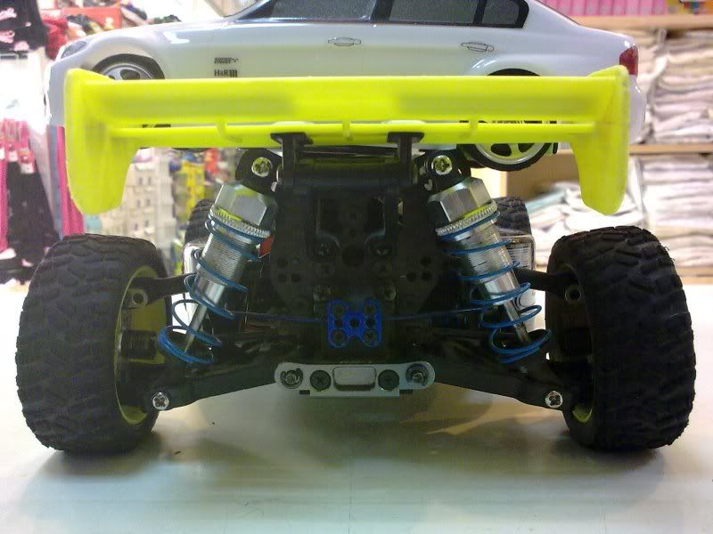

-This is to show the size of it compared to a miniz awd.

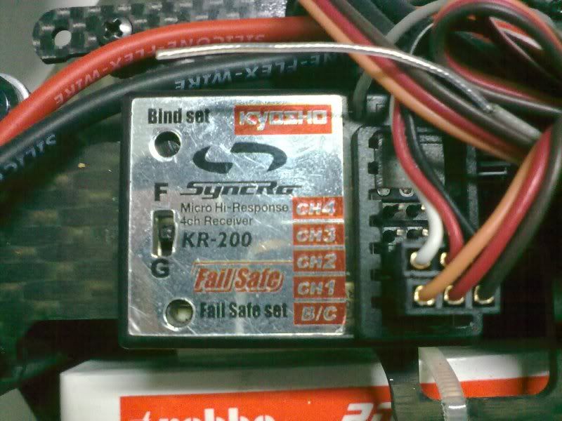

-It camed with a nice 2.4ghz kyosho receiver. No complains here!

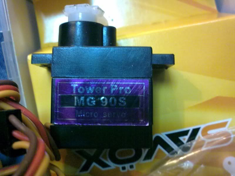

-This servo went dead the first batery try... not to bad...for a second hand car!!

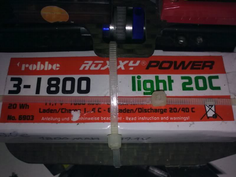

-It came with this 11.1v lipo. Later i find out that this one, that's what killed my motor...
-Because we must read the manuals first! It came with none!

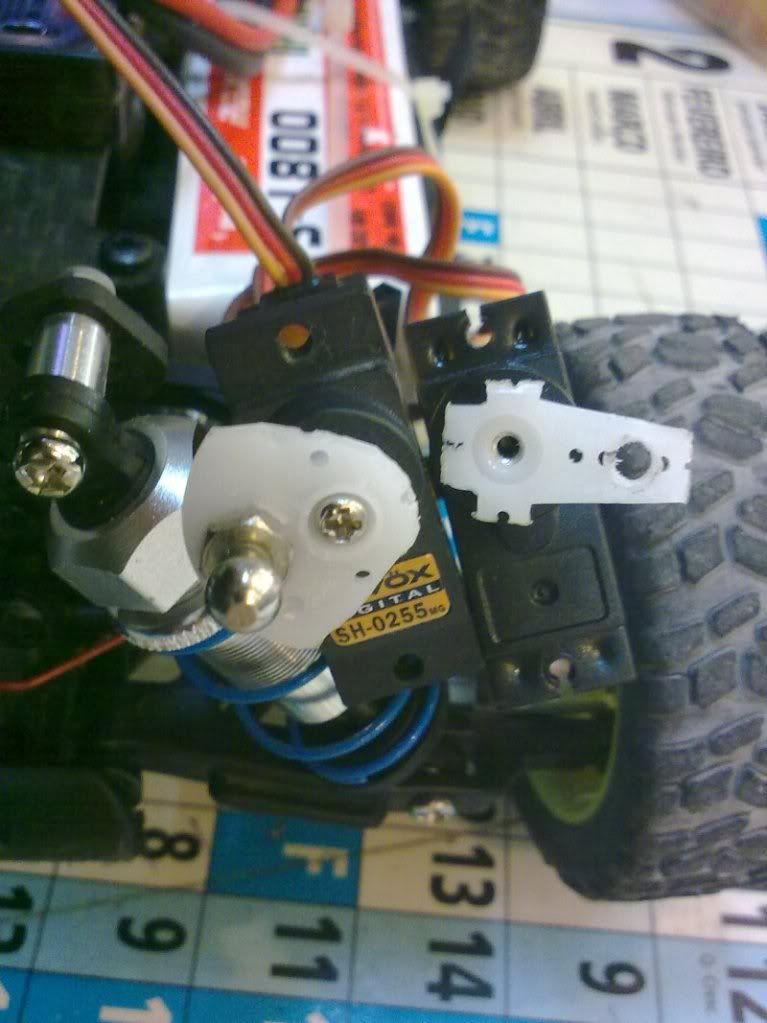

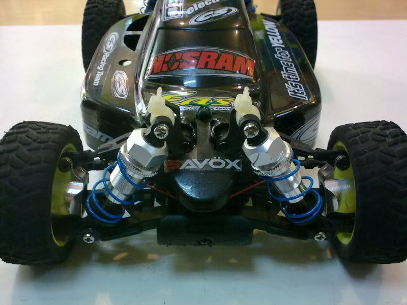

-Ok, for the servo i went for brand new Savox micro one! Flawless!

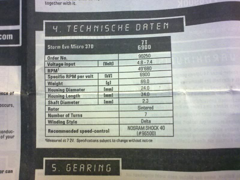

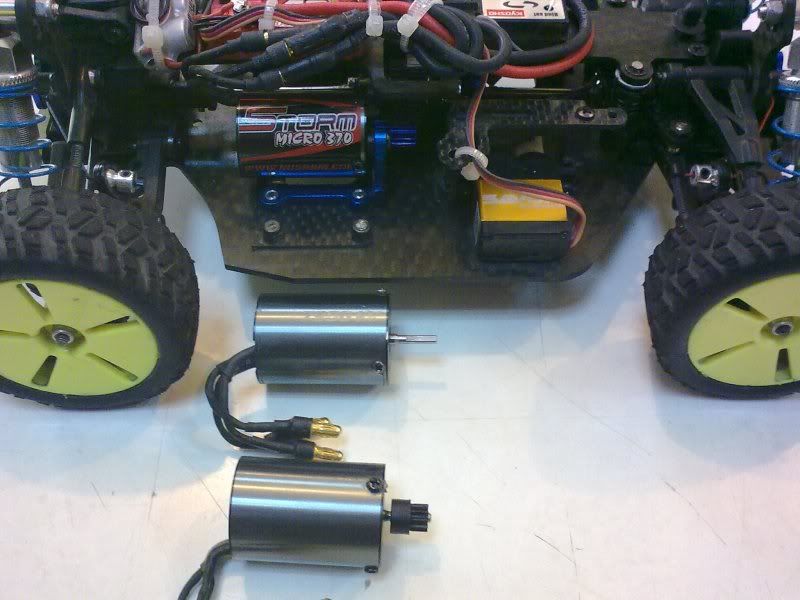

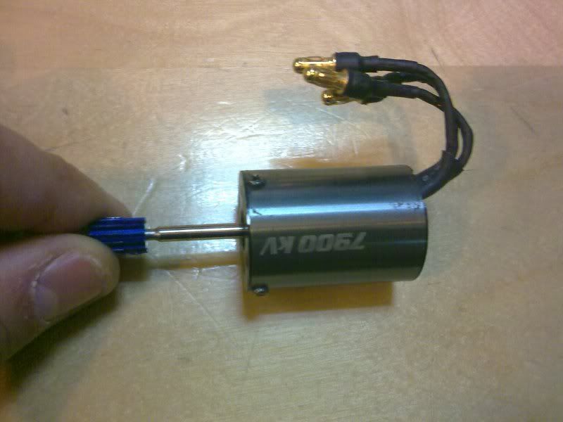

-After some batery charges on 11,1v and total IRON HOT, i found the manual and go to 7.4v... but the bastard keeps hotting... and now it evens get it's shaft out... (toasted)

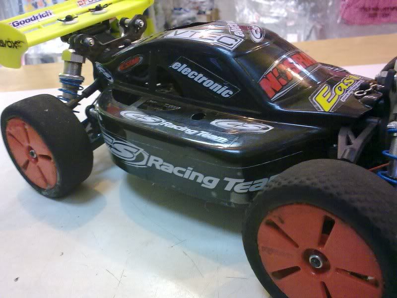

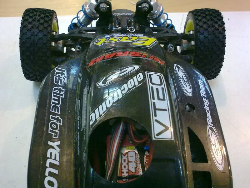

-It came with another body, that i removed the paint with alcohool inside, and painted black
-Stickers for the race look!
-Tried another cheap second hand motor 7900kv but it was hoting to! So (learned the lesson) and buyed a new Nosram 6900kv one... and it's working warm only The 7900kv is from LRP and the 6900kv are Nosram. They are the same company, like Castle and Flux!

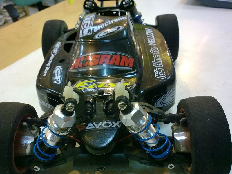

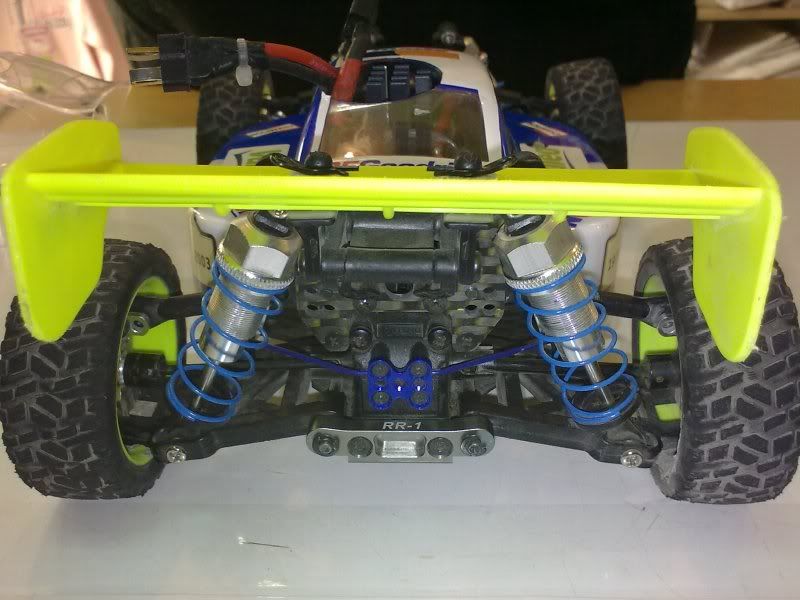

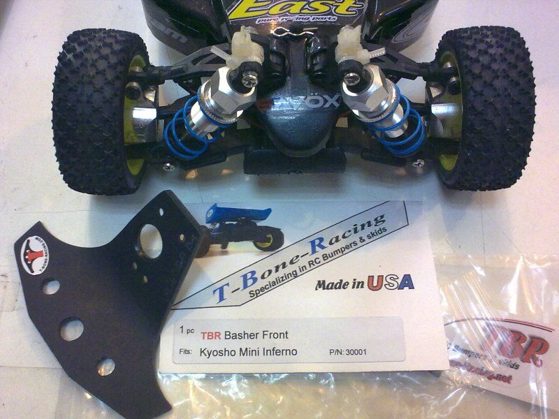

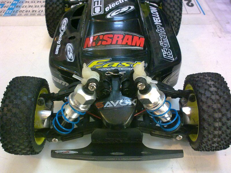

-Notice the plastic clips on top of the suspension arms! That is a solution for when it flips not break the eyelets of the shocks!

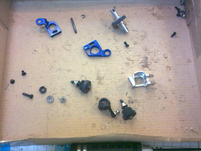

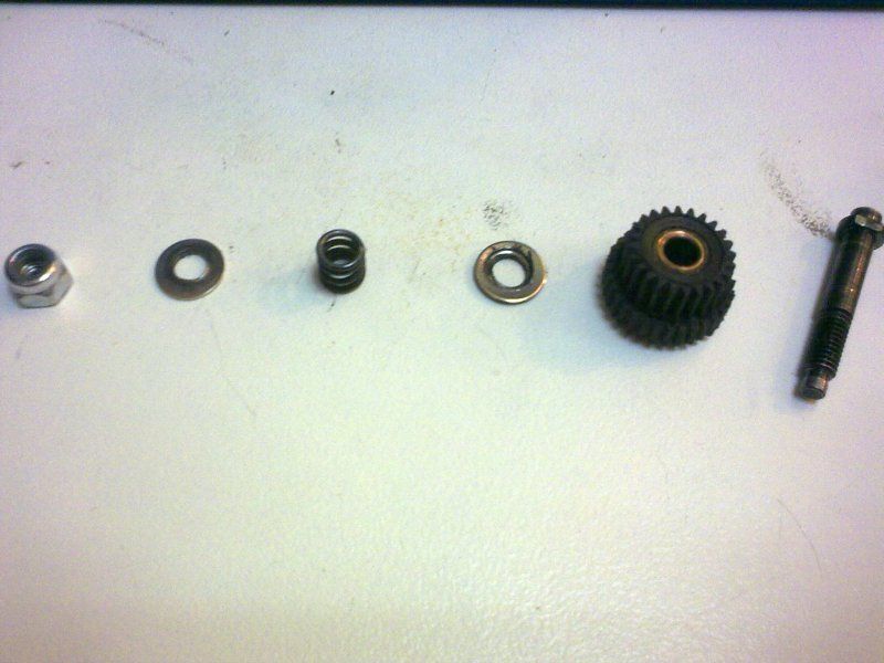

Smoked spur gear, ****!

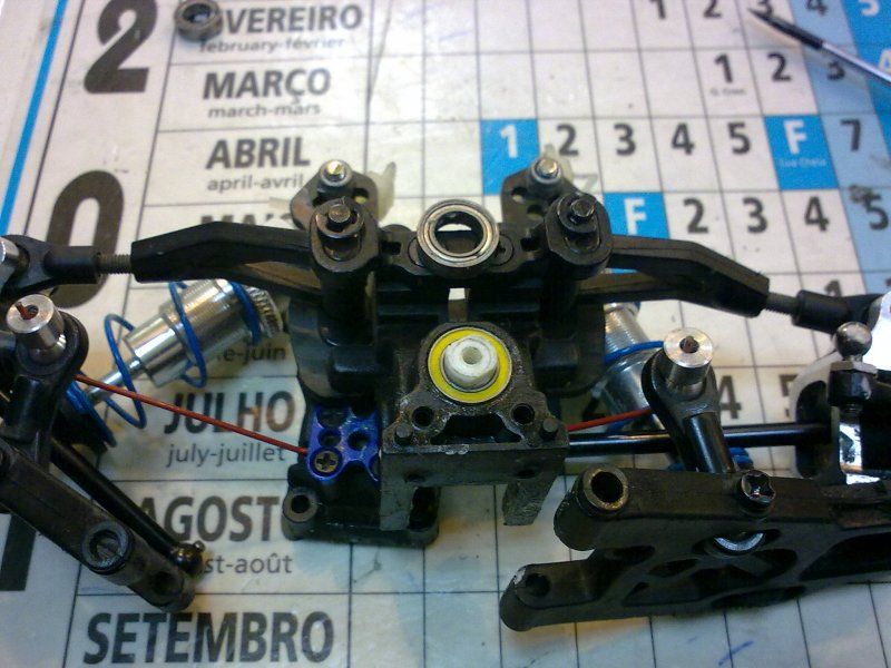

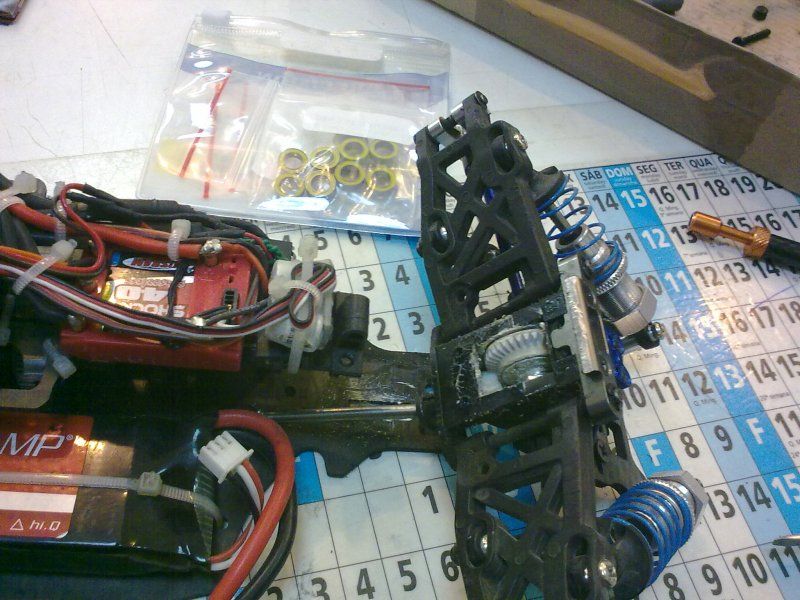

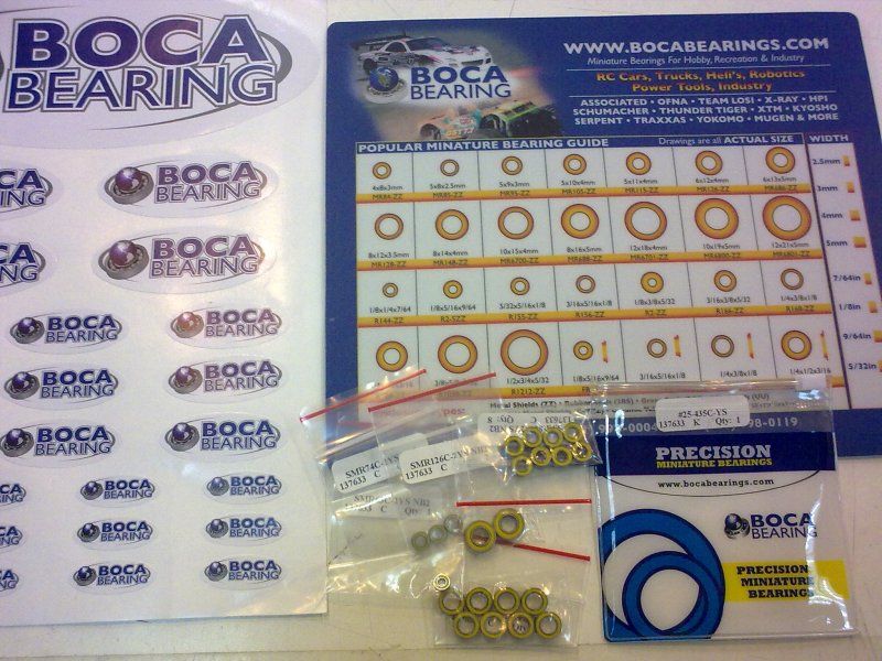

And a little upgrade: ceramic bearings, worth the money!
targetingxmod is offline
Old 04-28-2013, 06:53 AM
targetingxmod's Avatar
Join Date: Apr 2012
Location: Europe - Portugual
Posts: 2,248
I then tested them.... (they need, they say on the manual that they need some time to free themselves, because they are lubed for life, so after a couple of baterys, they should give this... )
If they are wruth the money? Yes they are... Why?
It's not night and day diference! But is very noticeble!

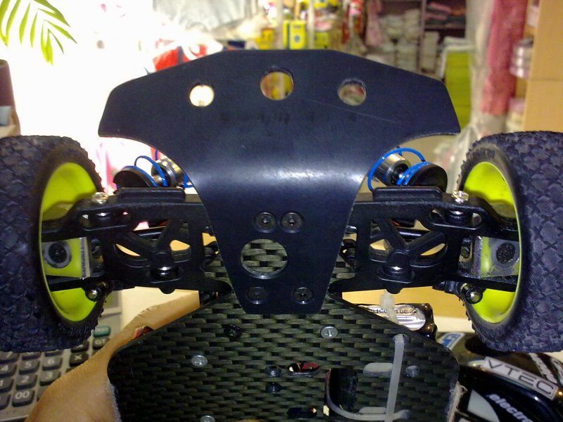

-Air intake for Electrics... i make this on my non bash units! But maybe if get any outwears do on the bash ones!

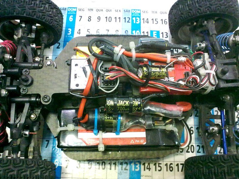

-Capacitor atack! RC is so adictted that even years past today i learn things everyweek! I know this is overkill capacitor bank but that's the way i see things in RC! What i see after this? Well cooler ESC, and a lot more of umphhhh, scream on pulling the trigger, oh yeah... this is the electric NITRO!
-2*4700uf 16v Low ESR, one directly on the batery plug from the ESC and the other connected to the RX like an glicth buster from Novak!
-1*2200uf 16v Low ESR directly on the ESC and keeping the upgraded cap pack (3 caps) from LRP

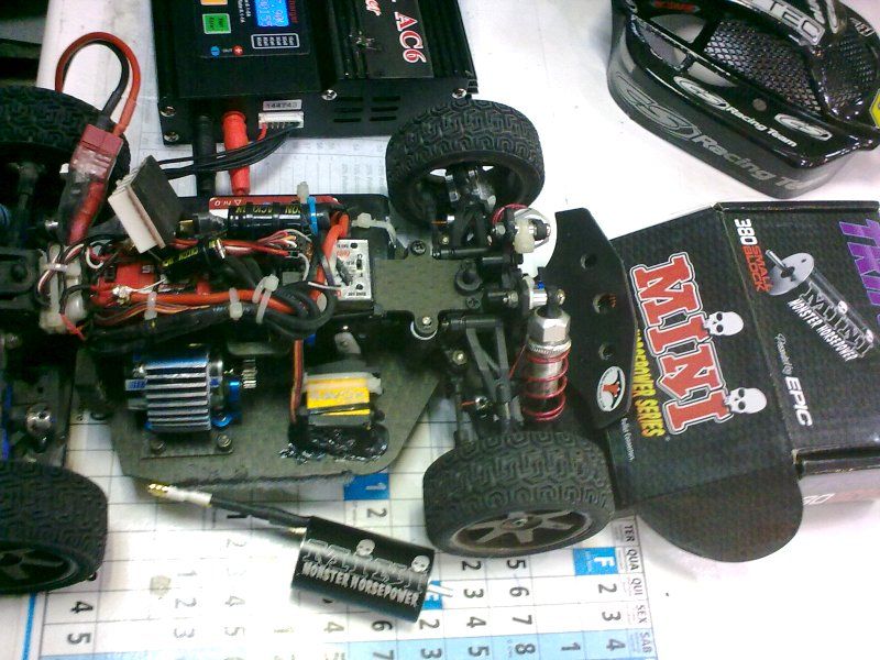

-Team Trinity Mini Monster Horsepower 9700kv runing now on 19T pinion. It's a little bigger then the LRP/Nosram 7900kv 24mm can motor that was there. It's a 28mm can now and being bigger it will not heat up on the middle of the batery pack. I can run all batery pack till the end and it's just warm on the end!
Perfect!
