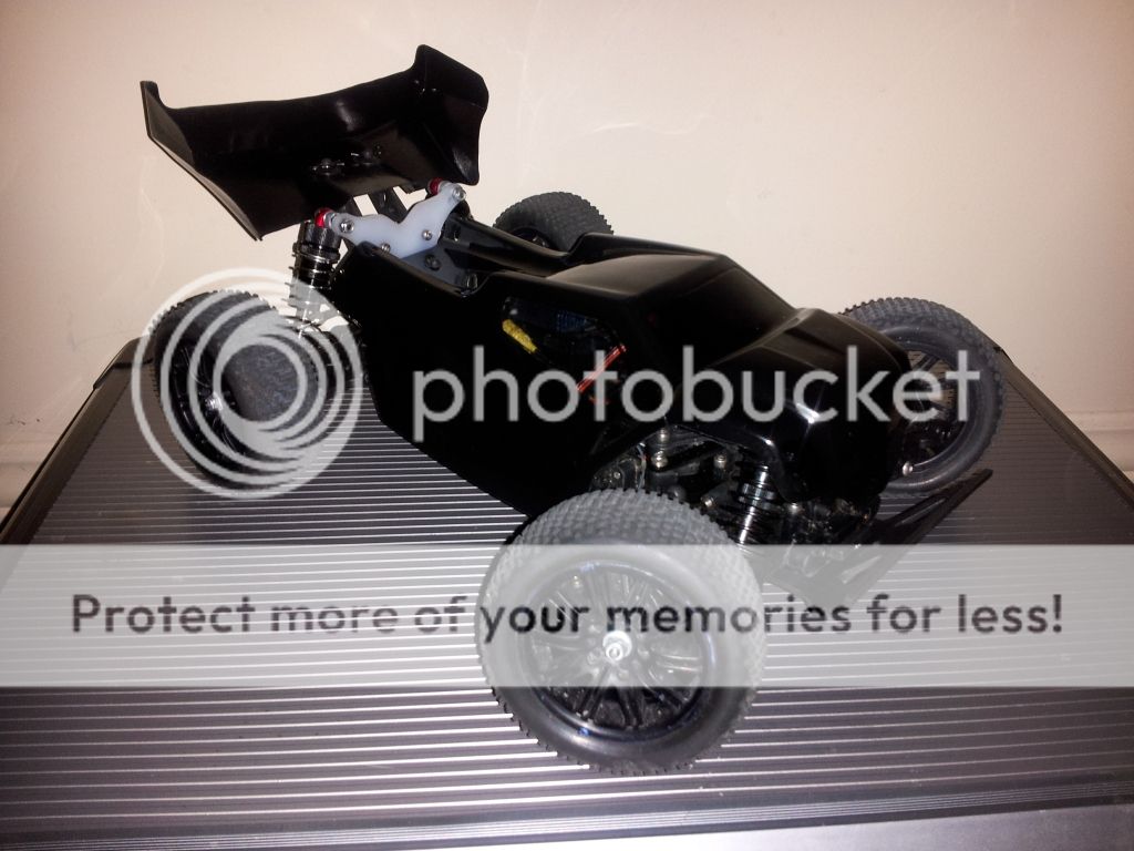

I just bought my Mini8 this last weekend and am looking for a fix/mod to prevent the upper shock caps from busting. What Ofna part number do i need? Or off what Ofna RC can these come from? I read about this from a post a few up from mine.

i made mine from Traxxas shock caps that i trimmed.

the traxxas shock caps don`t have the same tread...the tires are the stock rear mini 8ight on front and back ,the rims are on road 1/10 from hpi.
Originally Posted by cadenfrostyM8 View Post
I see you have a white rear shock tower! That makes me interested... Do u think that you could post sum pics of ur car under the body please? Your ride looks pretty sweet!
after changing to a truggy body i stop bending the front shock tower but on hard crash i bent the rear one..so i tried to make one from some delrin..did not ride it yet...i hop it will protect my wing mount and also the diff case.
i will take some picture from under the body a post them asap.
