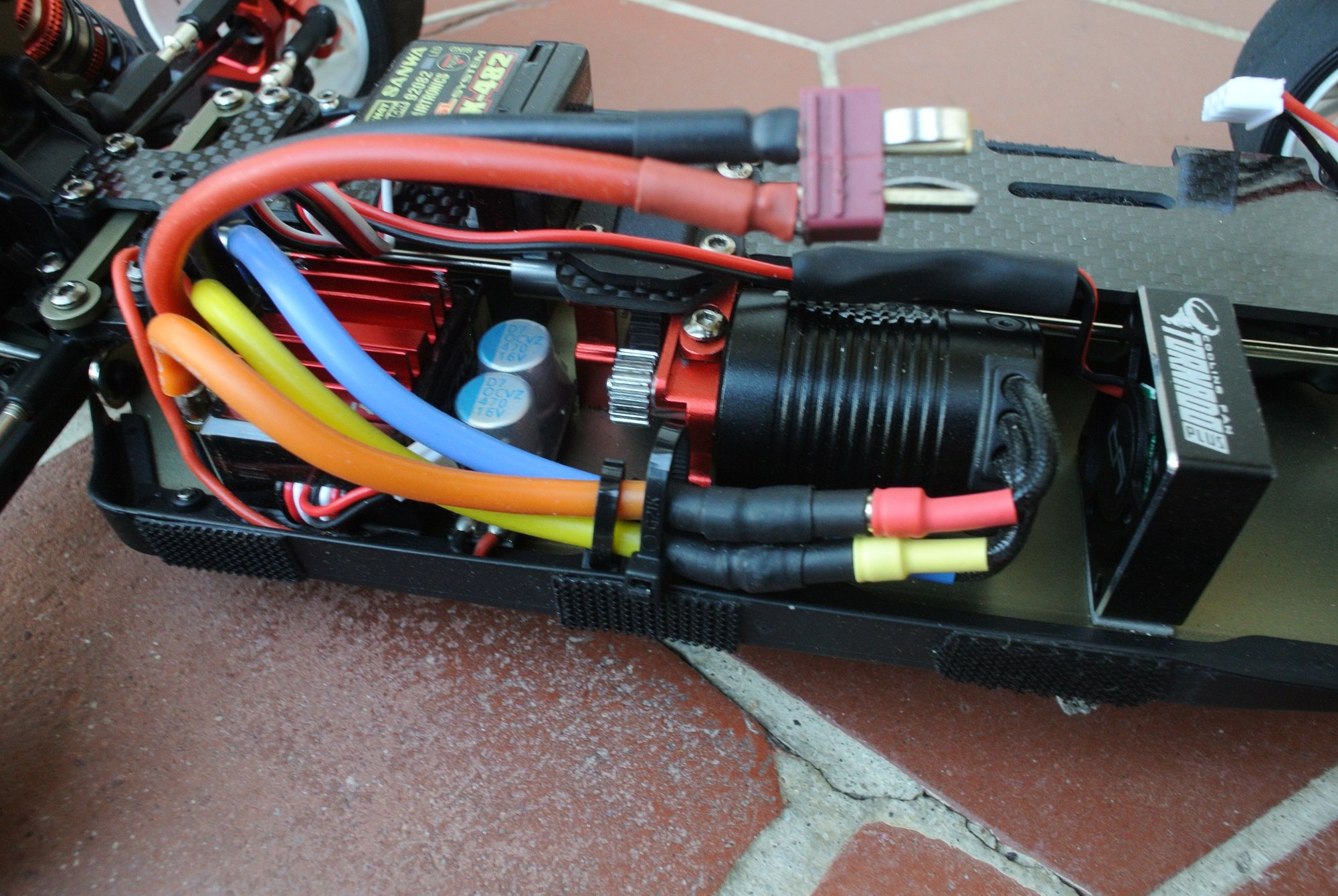

What are you guys finding works for mounting up a fan to say the leopard motor with the LC12B1? Got a nice 25mm fan here thinking could use that for some cooling.

Idk about a fan but I found some heatsinks that fit on the Leopard motor. These also fit easily on the Tenshock motor as well.

On mine I just servo taped a 30mm YR Tornado Plus to the pan and it held fine. You could use Shoe Goo as well. With the lid being so low profile I wanted all the clearance I could get and this is super common practice in 1/10 racing. Some of those cheap heatsink/fan mount combos don't actually have a pass through for the air from the fan to cool the motor. They only cool the heatsink, which is kinda pointless. There is an Integy one and a YR one that have slots for the fan to cool the motor, but again, at least in the LC12, you could run into clearance issues.

yeah was thinking that too, that 25mm yeah racing aluminum fan I have works well, may give this a look or figure out something else.
