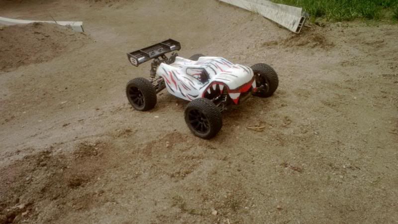

I will be updating the first page of this thread so idea's and parts are easy for everyone to locate. If you have something you would like me to post here on the first page, please send the images or idea's to me via PM. Thank you.

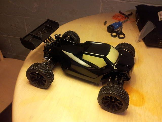

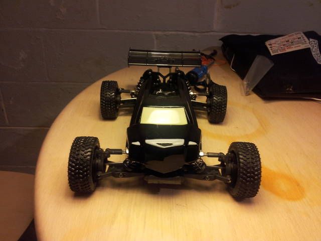

So I received my Phat-Bodies KaBoom Truggy body for the Losi Mini 8ight. As far as I know I'm the only one in the country to have one until they come out which should be real soon. This is my first go at painting bodies, so I think i did pretty good for my first try. I started this thread to show this new body and for anyone who wants to do a Truggy version of the Mini-8ight. Hopefully Losi will follow suit and make us a 1/14 Mini-8ight Truggy sometime very soon.
Under the hood is top secret for now, those wheels are HPI 9mm offset with 26mm Rallye tires. You can't really tell in the photo's but I used Black Metallic paint and for the windows I used Kryptonite Gold Pearl.

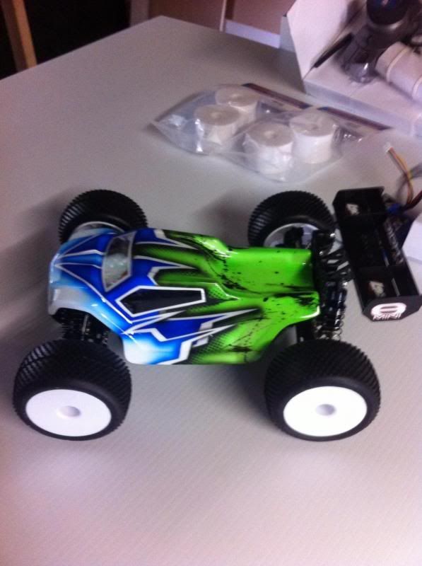

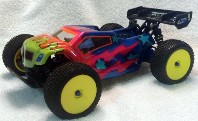

Here are two of the nicest Truggy Bodies I've seen to date on the Forum. If you have something very nice, send me the image to my PM and I'll post it here.

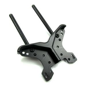

Here are some body mounts that will work on the mini 8ight. If someone has the part numbers please send them to me via PM. I believe these first two mount's are from OFNA and the other ones are from Driven Productions.
Use Part # ASC21287 RC18R body post to install on each tower for the complete set-up.

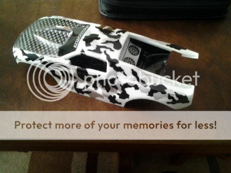

Here's how to cut the mini-erevo body to mount up on the mini-8ight.

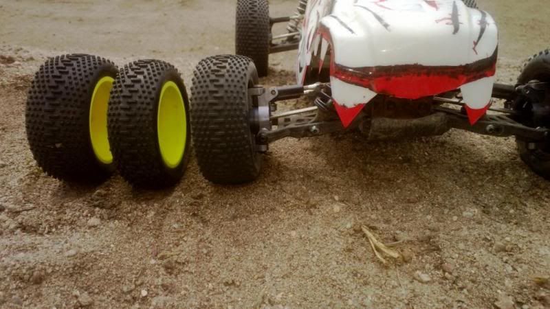

Here are the stock rear Losi Kingpin tires mounted on H.P.I. 9mm Offset 1.9 touring wheels. They look and feel just like a 1/8 truggy for sure. Thanks to Forum Member Skiboblitch for the pictures.

Looks sweet! I mini 8ight-t would be cool!

That's a sharp looking body. And nice turn around time too. One thing that catches my eye is the wheel width, I just don't think they have that truggy presence. Once I can do a conversion, I'm thinking of using two pairs of the stock rear wheels to achieve chunky. Or maybe use some rear HPI vintage rims. But damn, I wish I had a legit truggy body no matter what rims! lol

That looks sweet. Is Phat Bodies going to use your vehicle as the model for the sales picture? They could, you did a great job.
Maybe Mini E-Revo tires would look better. They seem to be about truggy size for the M8.

Thanks everyone for the nice comments. Skibob...Those mini revo tires are nice for sure the problem is that there tall enough not to let the chassis to bottom out on big jumps which means breakage. I mounted up a set and hit a nice jump in my yard and blew the tops of my diff cases front and rear lol!

To attach the body you would use the same velcro setup that comes with the losi carbon top deck.
Plenty of room under the body for you to mount a Tekin RX8 if you wanted

I know exactly what you're saying. You can mount stock rears all the way around for that true truggy look. All you have to do is place a 1mm thick washer between the hex and the wheel and that will keep it from rubbing. I don't like the stock wheels that's why I chose to go this route. On another note for those of you who race or bash in dirt running all front tires all the way around has way better performance than running the stock wheel set up. Better bite in the corners and the rear tires break loose a lot less.
