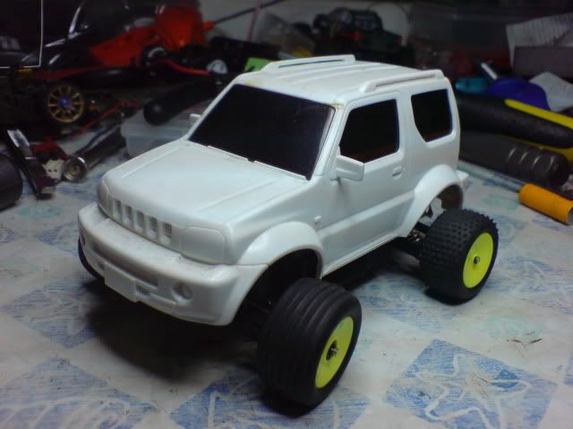

This is my contribution - still a project.... Micro Jimny

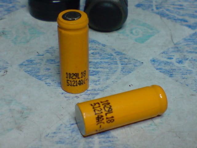

And my DIY micro T batteries - 180Mah Lithium Ion batteries

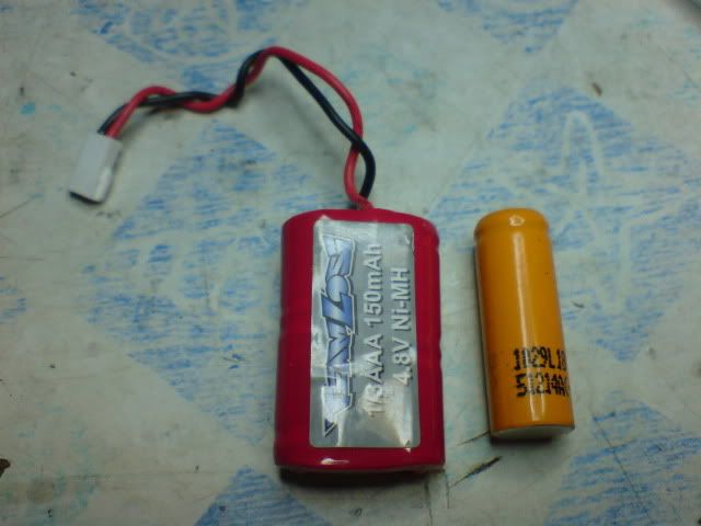

these are 29mm x 10mm diameter
near the size of the stock battery

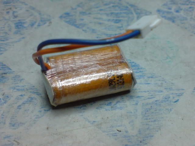

with some soldering of a spare motor wires (2S setup), thin cardboard to prevent grounding the contacts and a few rolls of cling wrap (still have to find me a decent shrink wrap)

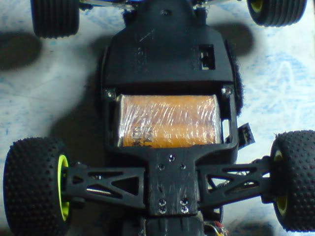

it fits the battery holder like stock
and powers my micro T to about 10-15 minutes of run time... it is also quite fast enough that I can make it do wheelies like the micro raminator.
cost of these lithium ion batteries - about $15... a similar capacity original losi lipo battery is about $38.99 from Atomic.mods

^^ nice find... if I buy more than two sets, it will turn out cheaper than my DIY batteries including shipping cost.
Any idea how long will it last when you run your micro with them?
