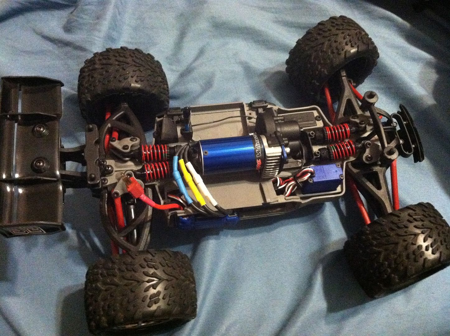

dont know if anybody has done this yet but i got bored. i though the esc and rx were mounted way to high so i moved them on my truck. im never going to use any battery other than 2s lipos so i just moved the esc and rx to one of the battery bays. in total i got rid of 22 grams of weight just by takeing off all the plastic i did. i cut the rx box so i could just get the antenna mount off it and left that in the stock place and since im useing the stock radio for now the wire is long enough to reach the mount with no problems.
