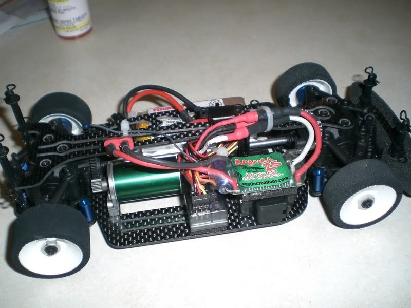

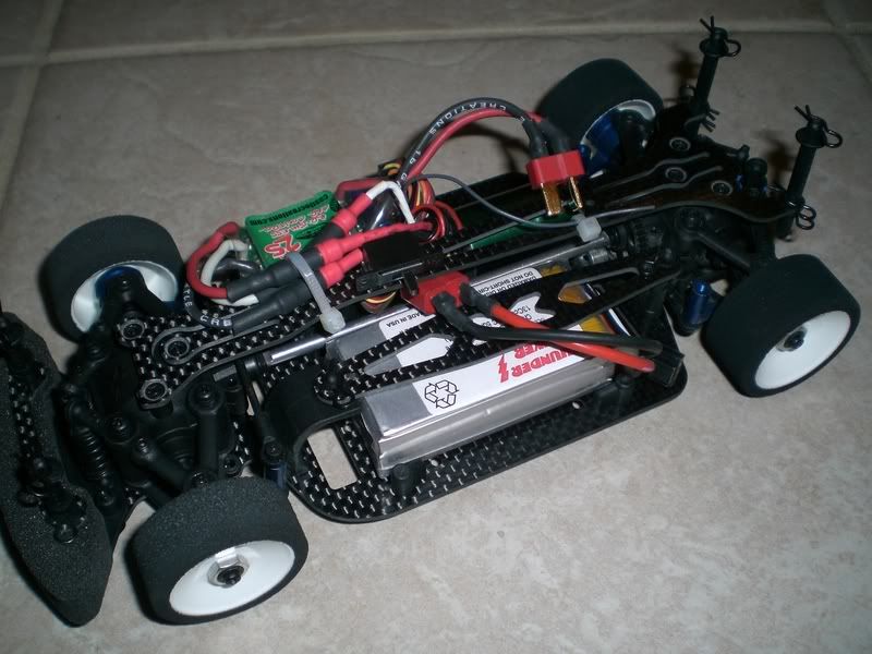

So I finished my new baby. Looks kick arse and I am ready to hit the track but am having a bit of an issue. For a little background info here is what I am running.
Mamba competition x package.
Thunderpower 1320 3c lipo (13C cont /20C burst) with deans plugs at all connections.
12 tooth pinion and 42 tooth spur.
I have tried all the recommended setting within the castle link program to get rid of the issue with no success. Tried "Low" on the start up power setting. Tried "100%" on punch control, ect ect...
The motor does some really bad hickupping before it willl take off. Almost like turbo lag but its getting really quick little bursts of throttle where it should be accelerating smoothly. I really have to get on the gas to get rid of it. I have read of "cogging" but with my setup there should be no issue with pulling the required amount of amps. What could be causing this?

I just noticed this on my batteries desciption :
"Reccommendations: 18oz & lighter models using Speed 400 sized brushed or brushless motors requiring 17amps or less in continuous current."
Doesnt the mamba esc pull 25 amps?

BTW You don't want to zip tie your wires to the multiflex upper deck. It will put it out of tweak, and wont act consistent on track.
I would say even go down to a 54.
Thanks for the tip Mini
