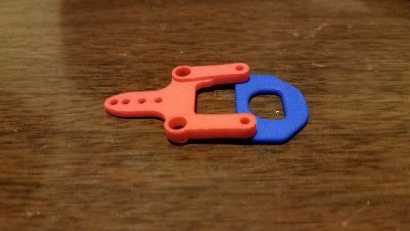

AAA vs Lithium power is a hot topic... I feel that Lithium based power has much more lower variance compared to AAA. When running a AAA car, staying on top of the battery charge cycle is 2/3 of my race weekend. With LiPo, I can charge at any time, and dont need to time my cells to the time that I race. AAA, I need to buy 10 sets of cells to get 4 good packs for racing, and the other 6 are practice packs. One single average cell can ruin the performance of the best cells in the pack. With LiPo, there is a lot less variance, and you can use a $20 charger that can charge multiple packs since we are charging at .5A or less. Charging aggressively is not as good performing for cells this size, as you will lose too much capacity in the charge. In 1/10 scale, I charge at 10A. I find no benefit to charging aggressive, it reduces consistency and there is major voltage drop in the middle of the run. 10A is perfect, plenty of time to get the cells charged up, and the run is relatively flat. By the time you get gridded up, the advantage of charging 40A is lost, and all you have is the disadvantage of lower capacity and fewer charge cycles for the cells.
Again, different people will have different experiences and opinions. I spoke with Kyosho, and they have no plans to move away from AAA any time soon. I am planning to test 1S operation with these cars soon, just need to find the opportunity. I just received some 3.7v to 5v voltage boosters good for 2A, which can go between an ESC and RX for aftermarket electronics, but I also would like to test with the Kyosho electronics. I know that the RWD electronics should be 1S capable, since Kyosho has been testing 3xAAA cells with it for their mini-endurance race which they posted a video about (with stock brushed motor). With a 5500kv motor, it could make some good stock speed racing, but thorough testing will be needed to mix it in with AAA classes, along with meeting the minimum weight restrictions. For now, this is just a pipe dream, but something that I feel can close the gap between equipment. My opinion is that brushed motors will essentially be tied to AAA cells, the relatively low efficiency of the brushed motor will induce considerable voltage drop on 1S. However, brushless motors with high enough capacity cells could realize a consistent speed of the car, with relatively low voltage drop over the 5-10m run. I have a box of 500 and 750mah 1S cells to test with, just need to find the time and get everything wired up.
For newer racers, I agree that AAA is easier to get new people that have never driven RC in to Mini-Z, however, for experienced larger scale hobbyists, LiPo is far more convenient, as most will just need to get a charge cable for the battery rather than a new charger.
As for minimum weight, my lightest kyosho stock cars weigh in at 163g. These new 98mm bodies are really light. My LM kyosho stock car in comparison weighs around 183g. Both are pretty equal in lap time.
Originally Posted by MTseo View Post
Is there an damper available that will allow an LM to be converted to 98mm? I was able to do it by making the damper hole bigger and moving the T plate, but is there a damper available that will do this unmodified? I love how the LM car runs but there are many more bodies available at 98mm, also the pn race pro stock race does not allow 102mm chasis.
LM damper for 98mm, R246-1352 should be what you are looking for. I also have a 3d Printed prototype that I am working on. The 1352 has the mounting points for the damper plate screws a little too close to the center line, which restricts the disc movement. My design moved them outwards a little. Send me a PM if you are interested in trying the adapter.
