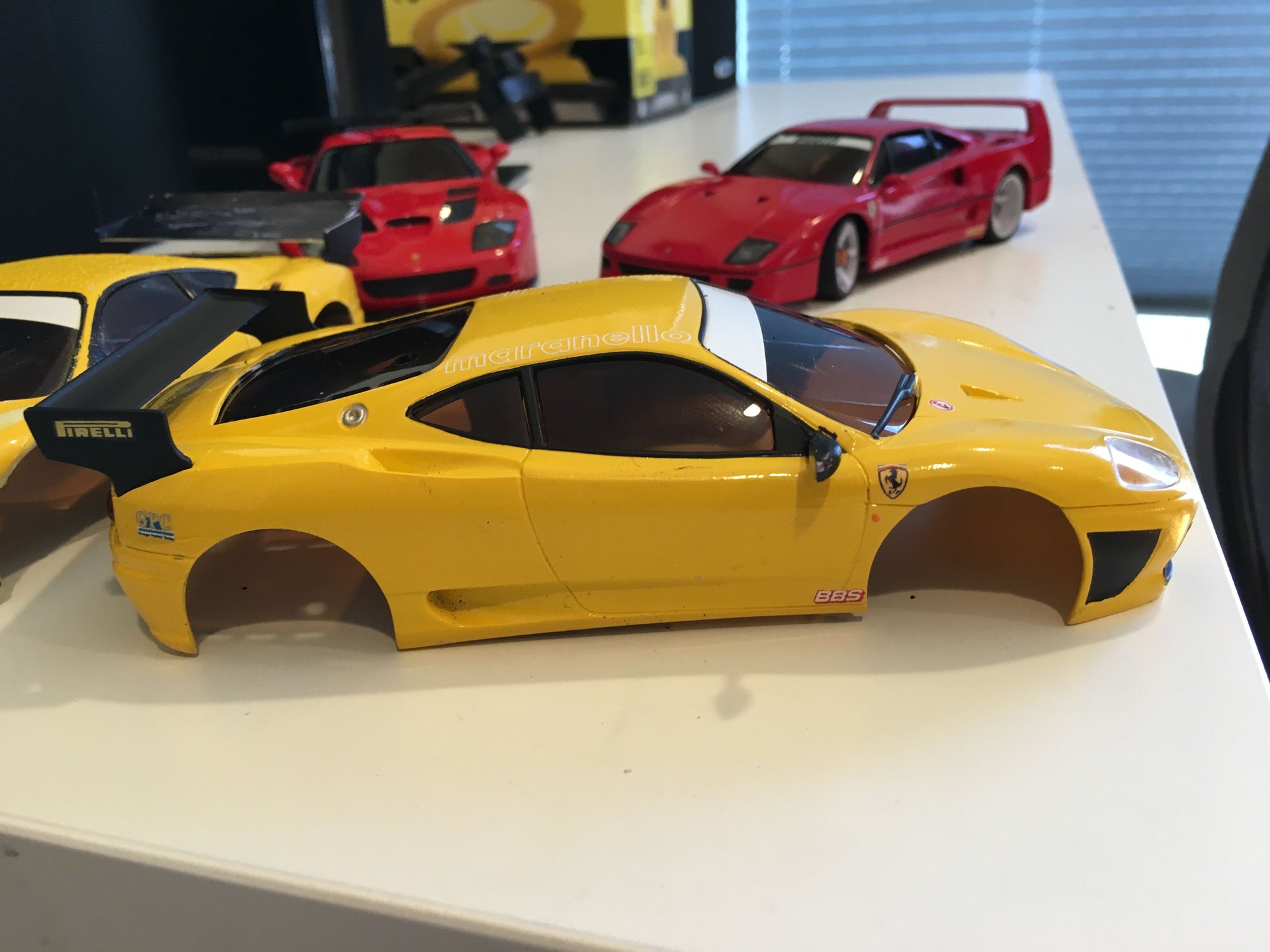

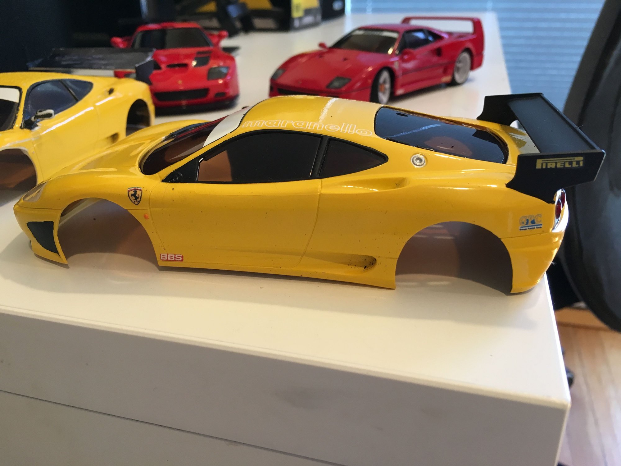

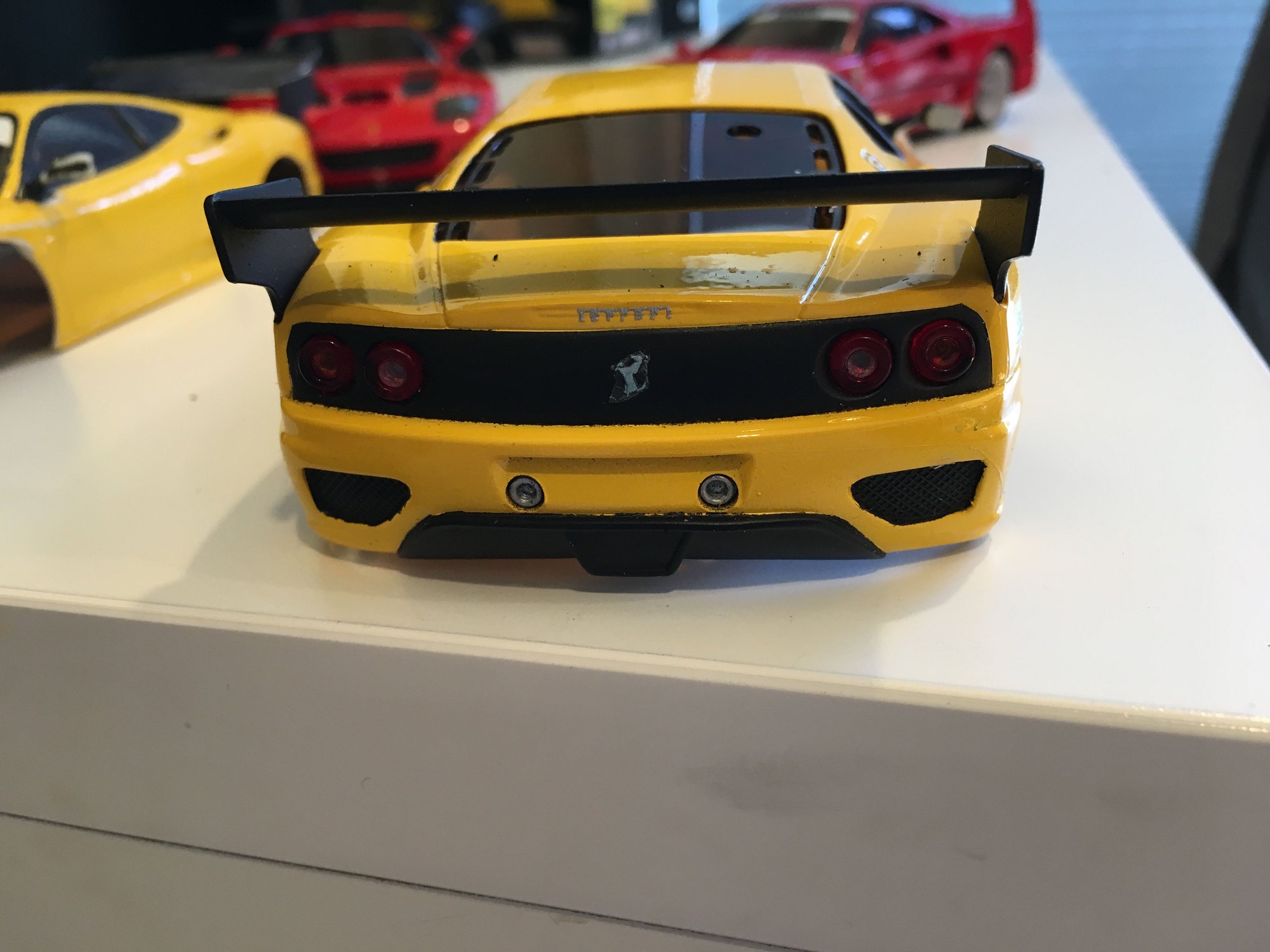

If anyone wants a pair of 360GTC bodies I am selling mine ;-)
Cheers,
Jim
