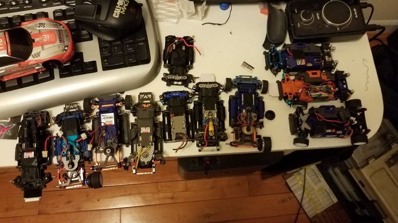

hardwood floors are tough, foam rear tires help the dust pickup and loss of rear grip. Keep away from silicone tires period. They leave a slime everywhere they go, which makes things slippery for everything else. Especially people wearing socks...
time to rebuild some cars...
