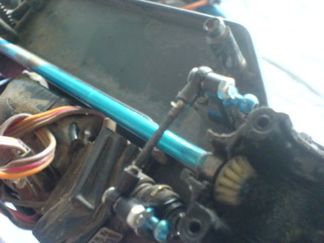

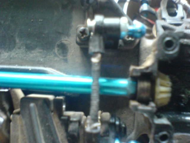

drag link nebody?...i think this 1 is better than the DP one...it has absolutely NO slop and is more made of metal than plastic....i reken its less prone to binding

Originally Posted by trainable
Hi ProudSavageOwner!
Nice work on the home-built draglink....Did you use sway bar parts for it?
My rc18ft kit is finally in the mail and I should hopefully finish building it by the weekend..(if it arrives tomorrow...)
aside from taking extra care putting the screws in -- do you have any other building tips or stuff to watch out for?
Brgds,
Tony
no i used some mini t shock ends from the oil shocks....theyre a nice size and a mini t rear turnbuckle which u will have to heat to redhot and bend orelse ull snap it and if u do manage to bend it itll snap under stress
there was a fair bit of grinding involved.....works realy good tho i aint complaining lol
wen u get ur FT kit ull be done in about 4 hours....if not 2 hours lol its piss easy to build
build the diffs properly,if u can scrap the kit bearings and go with some rubber shielded or ceramic bearings
build the shocks properly and thats about it..oh and the anodized alloy balls..dont use the 1.5mm wrench AE gives u..it sucks......pretty much any 1.5 mm wrench will strip those hexes so be carefull.
and if your gona use the 55t spur u can just install the 60t spur plate underneath so if u wana go to 60t u can not worry bout the plate
and use a realy good steerin servo like the Jr NES-375
