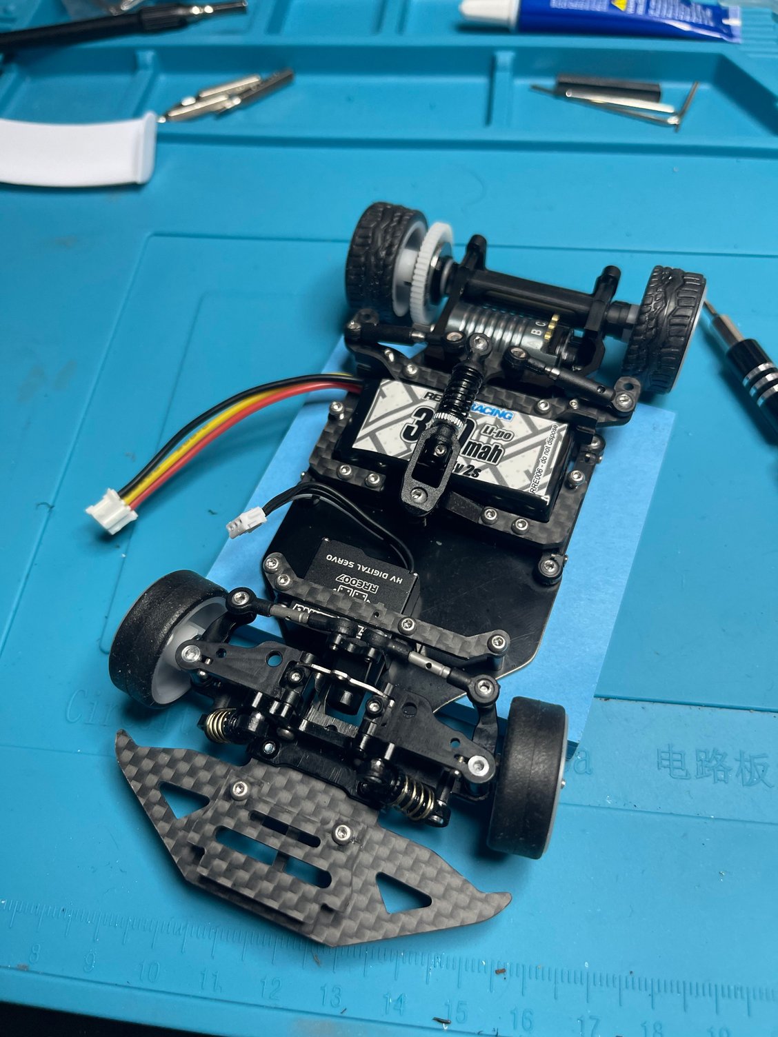

Nearing the end of my build. A few tips I wish I had before starting.
I used the rear shock shaft to run the thread for the steering linkages. The thread is the same but the shock shaft is much larger and easier to handle. Remember one of the threads on the turnbuckle is reverse so this trick won’t work there.
The set screws for the front and rear droop adjustment are small and easy to strip when there is no thread. I used one of the larger button head screw in the kit to run the thread.
I also got an assorted set of M2 hardware from Amazon. Unfortunately you don’t get much spare hardware. I only had one ball bearing, and counter sunk screw left over.
this is the first kit I’ve put together after being out the hobby for about 11 years. It was very challenging for me but now that it’s nearly done it’s totally worth it. It does take a lot of patience and a few times I had to put it down and come back the next day.
good luck
good luck
