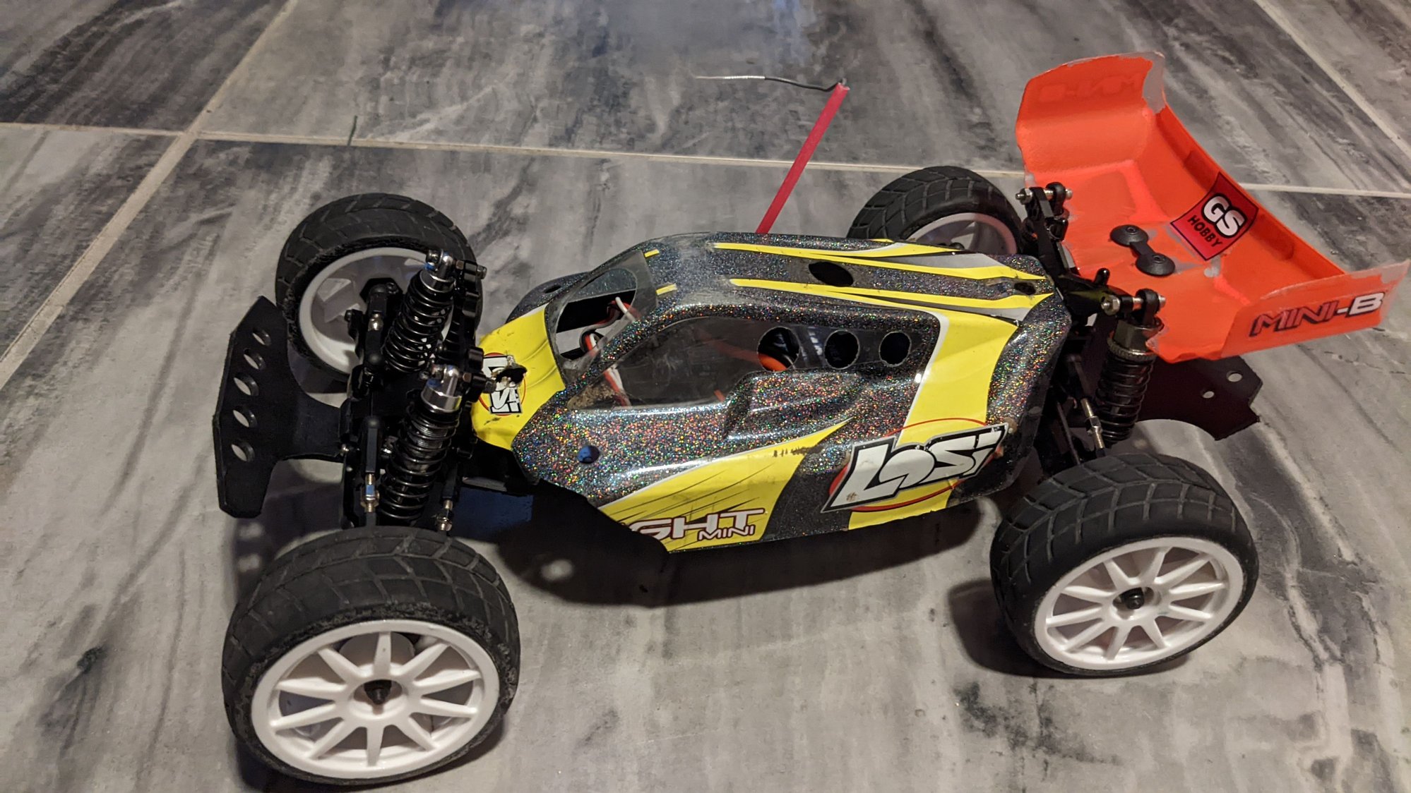

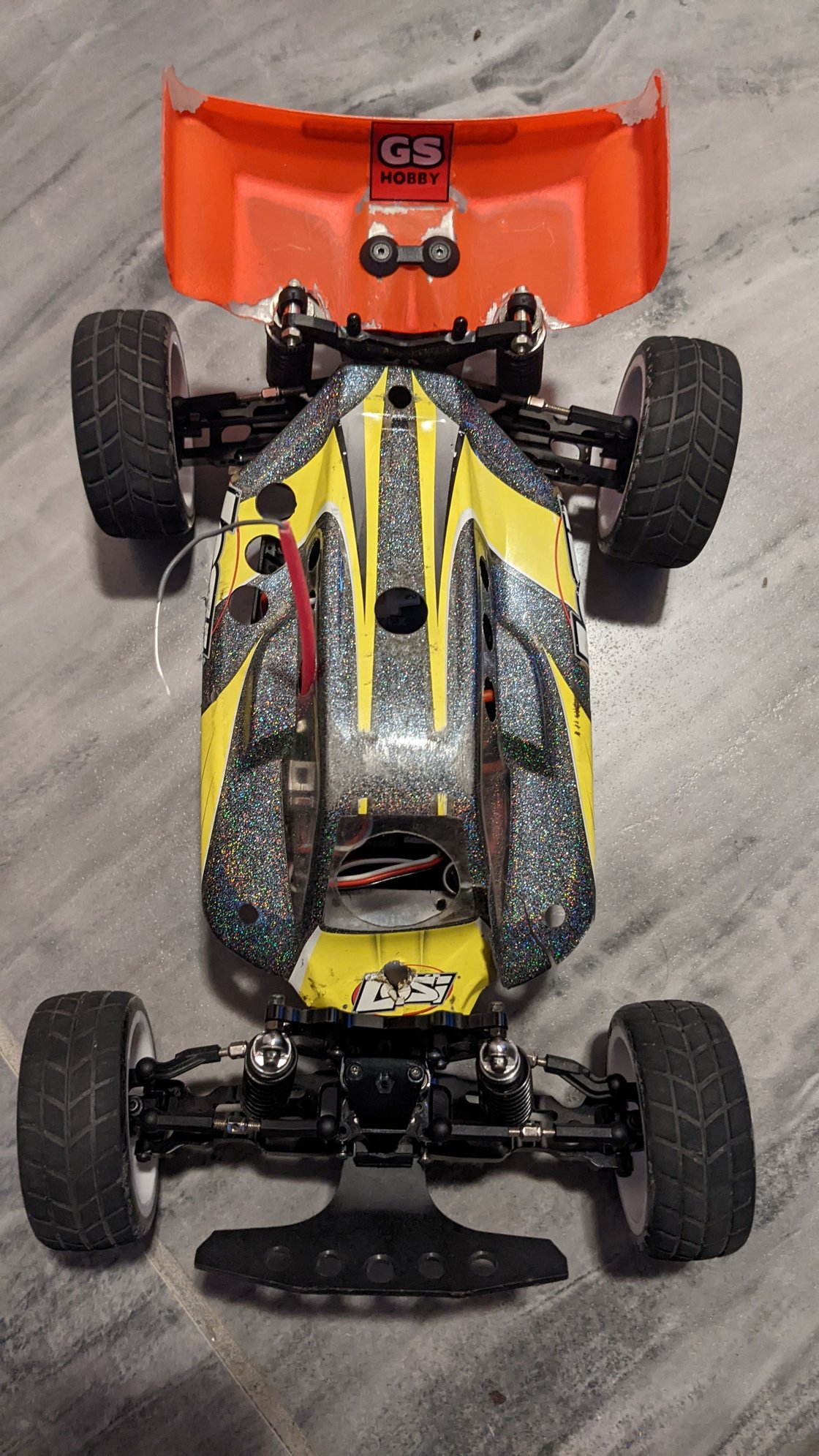

Old 06-11-2022, 03:07 PM
  #336
Join Date: Feb 2020
Location: Austin TX
Posts: 54
Originally Posted by YourConfused
I just bought a 12 scale datsun 240z body that has all the room you can imagine, but it's probably not what you are looking for. My mini 8ight buggy body might be a good fit, I'll try that tonight and see if that's an option for you.
Here ya go, mini 8 buggy body on mini b.
YourConfused is offline
Old 06-11-2022, 03:08 PM
  #337
Join Date: Feb 2020
Location: Austin TX
Posts: 54
looks like a pretty good fit actually
