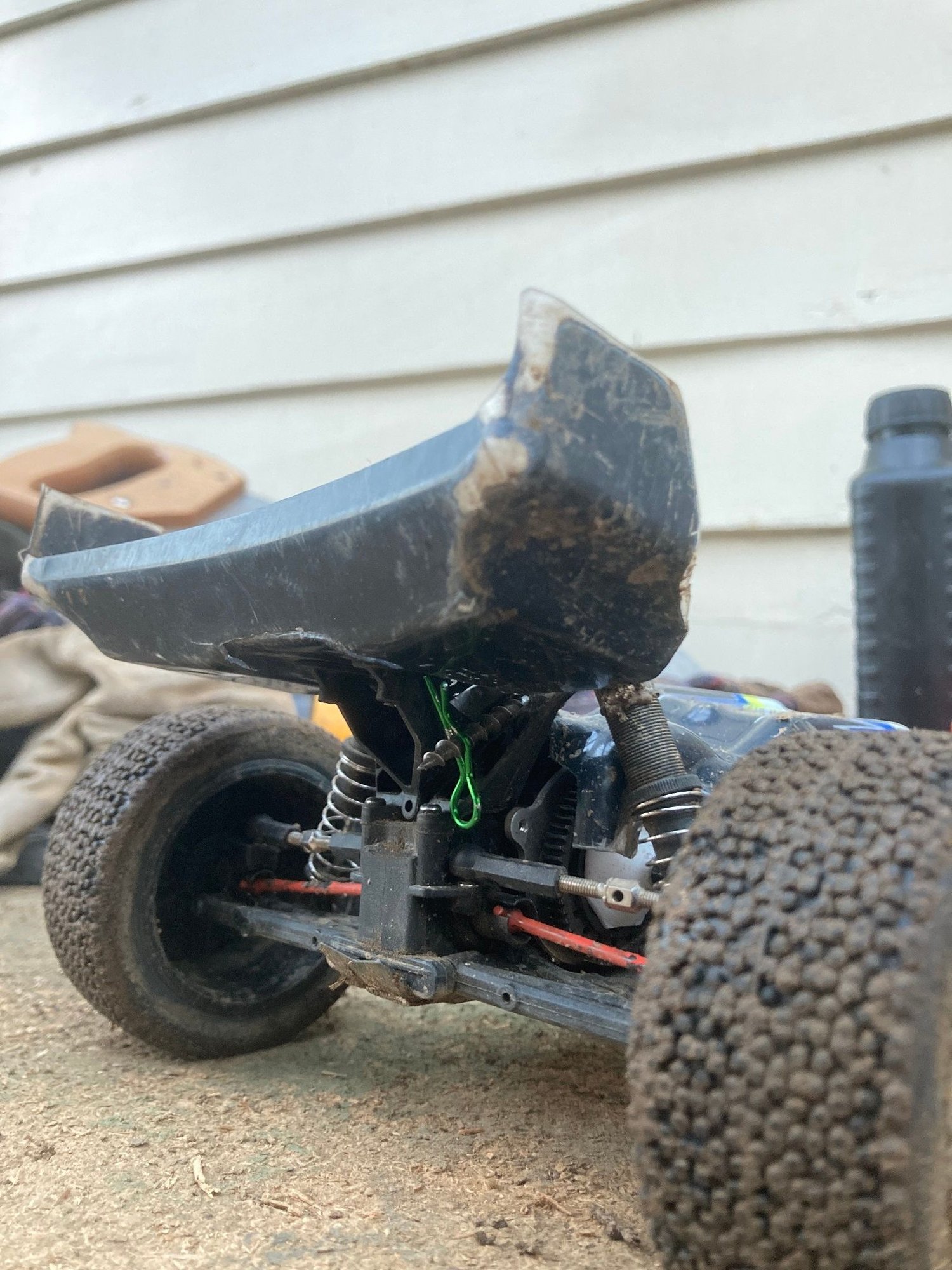

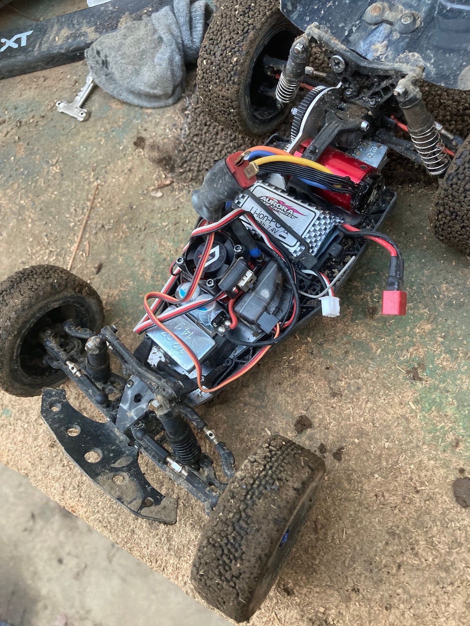

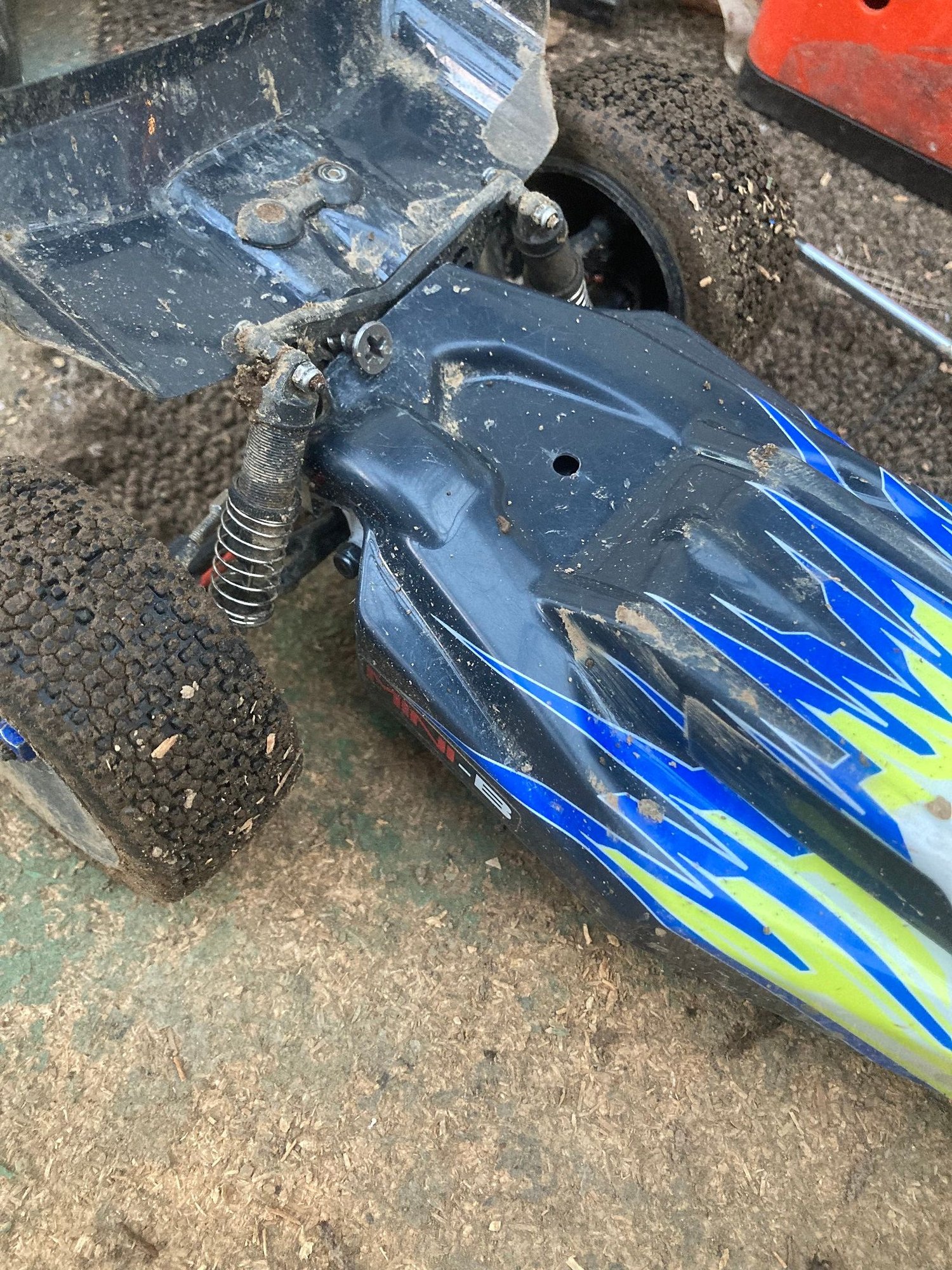

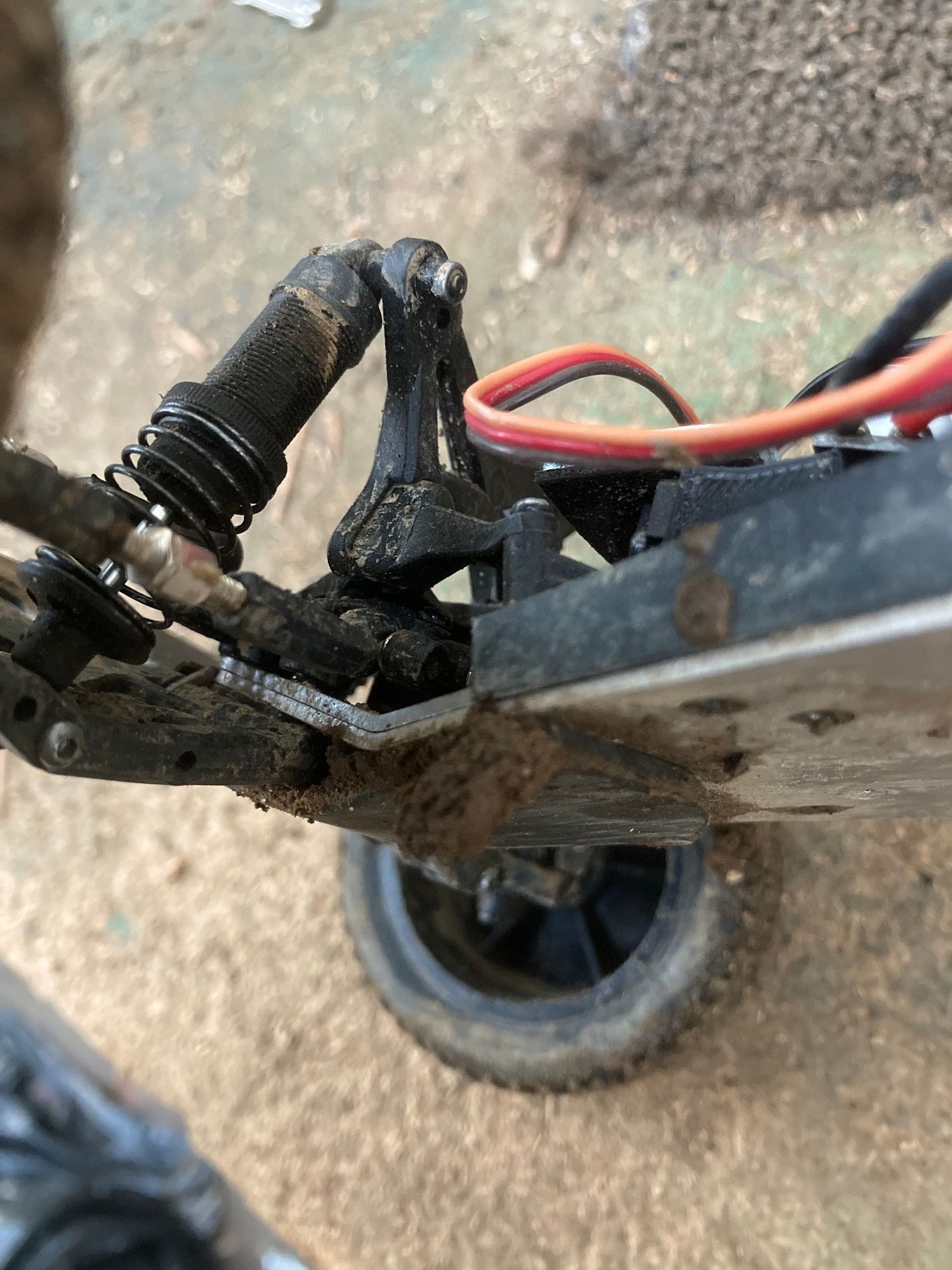

Thought I'd post my dirt setup.
Hobbywing 10BL60
Turnigy Trackstar Sensored Motor
Savox SH-0265 with the servo mounts from AJC Mods
Slipper Eliminator (requires a Losi 8ight Spur & 48p pinion) and 12mm wheel adapters from Eagles View Aerial
Sandwiched a second chassis against the other for more weight
MIP Ball Diff
WLToys Wheels/Tires
Silver Springs in the rear
Forget trying to cram the body onto the post with all this 1/10 stuff, I just use a wood screw through the rear shock tower that's secured by a body clip.
I've ran like 12 packs so far with the Slipper Eliminator & Ball Diff with no issues, works great.
I also tried the YZX 12mm hex adapters, the E.V.A. adapters give a ~2mm wider track width.
I tried LC Racing LC12B1 Wheels/Tires, the WLToys hook up better in the dirt, give 1mm less track width than the LC wheels and are larger in diameter.
