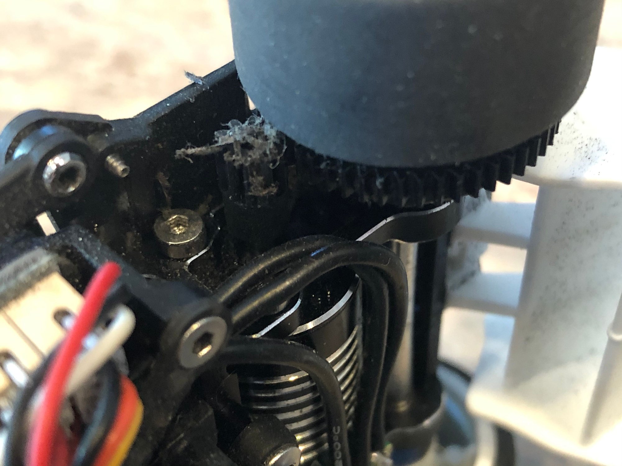

Pinion finds all the track debris. No other car I run does this.

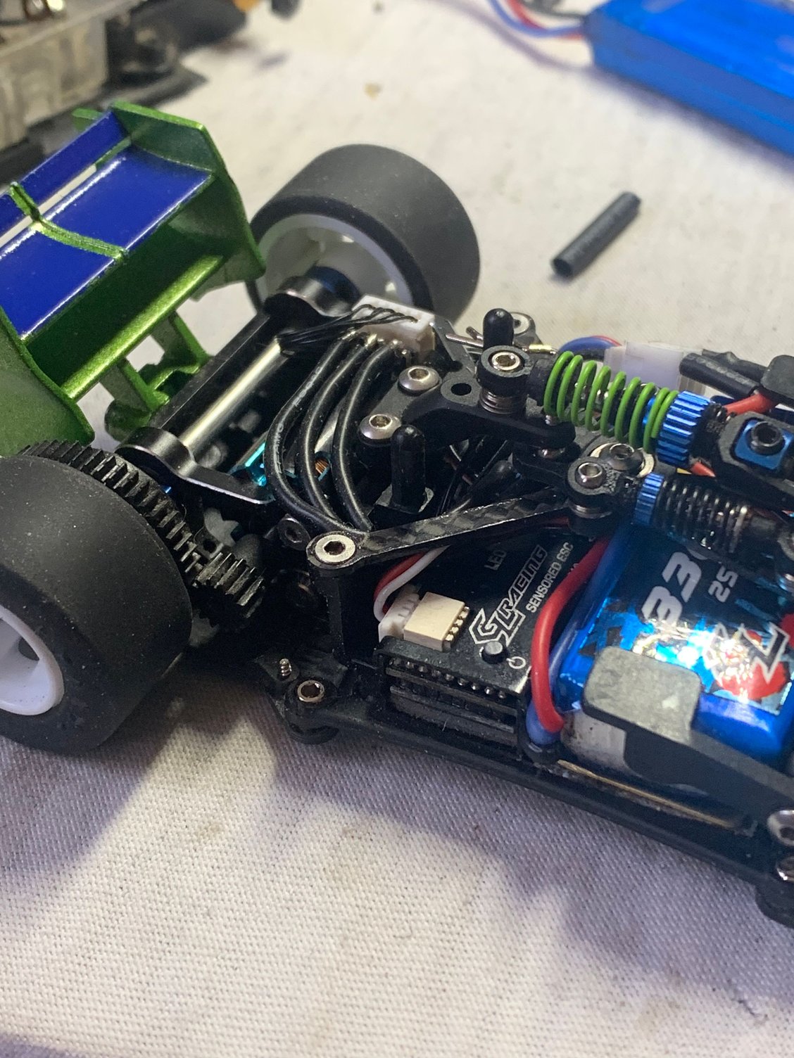

Figured it out! The GL sensored esc is much smaller than stock. I was able to remove the electronics plate and mounted the esc and receiver directly to the chassis. No interference with side links. Getting ready to calibrate and give it a go!

Routing the sensor cable was challenging. Battery plug is not built into the speedo which kinda sucks. Both manageable. Feels very smooth. Waiting for the program box to dial it in. Not sure if this one can be programmed without it. Tried all my Hobbywing boxes and my WiFi module but no luck. 😭

Hi, It cannot program without but the standard program is a good starting point.
I would turn motor with the board facing the diff for body clearance, always make sure when you swing the rear left and right that the body once install it does not touch anything or the side rod suspension will not work properly.
nice fitment of the esc.

Thank you sir. I opted to trim the body to fully clear the sensor board on the motor. Standard programming is fine except no reverse. My boards are round pvc, like a magnet sucking the front wing in! I also prefer to turn forward power down with the esc rather than TX epa. Assuming that’s an option with this esc...

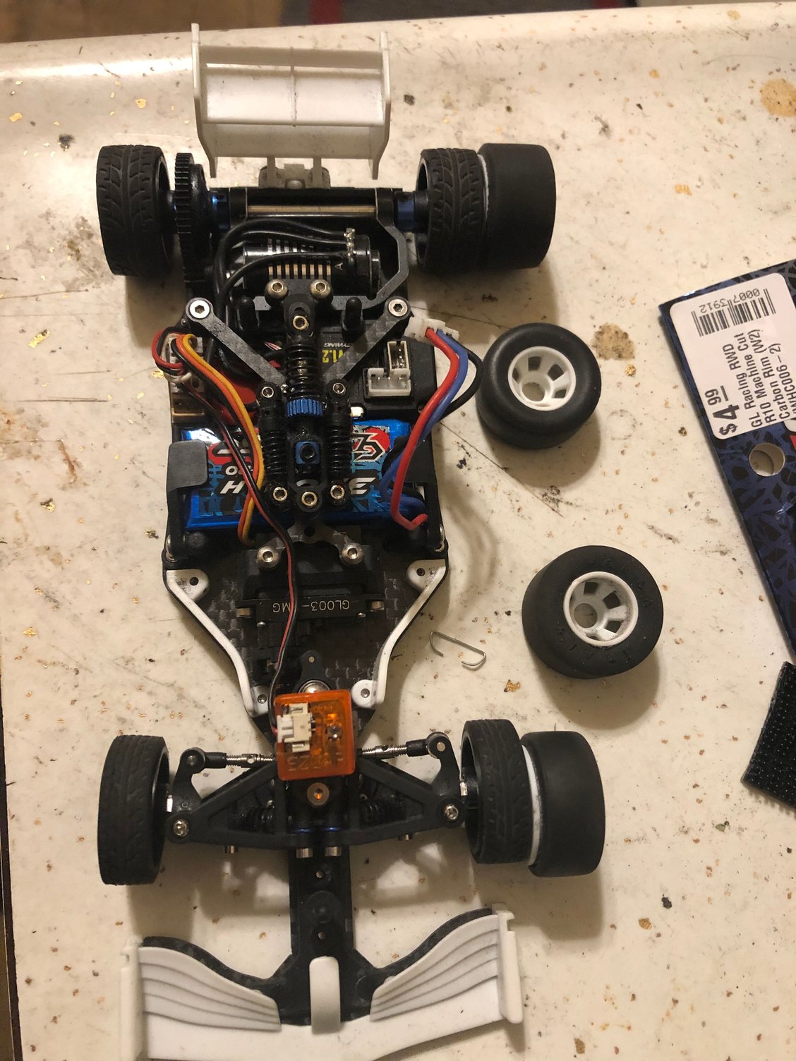

Gonna try something for home use. It will get a brand new set of tires shortly. Just couldn’t get the slicks I’ve been running to work at home.

I put 14mm PN super soft radials on the back and they were magical! Paired with 23° fronts the car was fantastic. Ordered the brass chassis hoping the car will feel even better.

I know it’s mostly my fault for not constantly cleaning my home track. Not one of mine can run slicks at home. I’m probably due for new tires when the group gets back together. They seemed fine at the last practice in March.
Now it’s a matter of readjusting all the controller settings I made trying to get it around the track.
