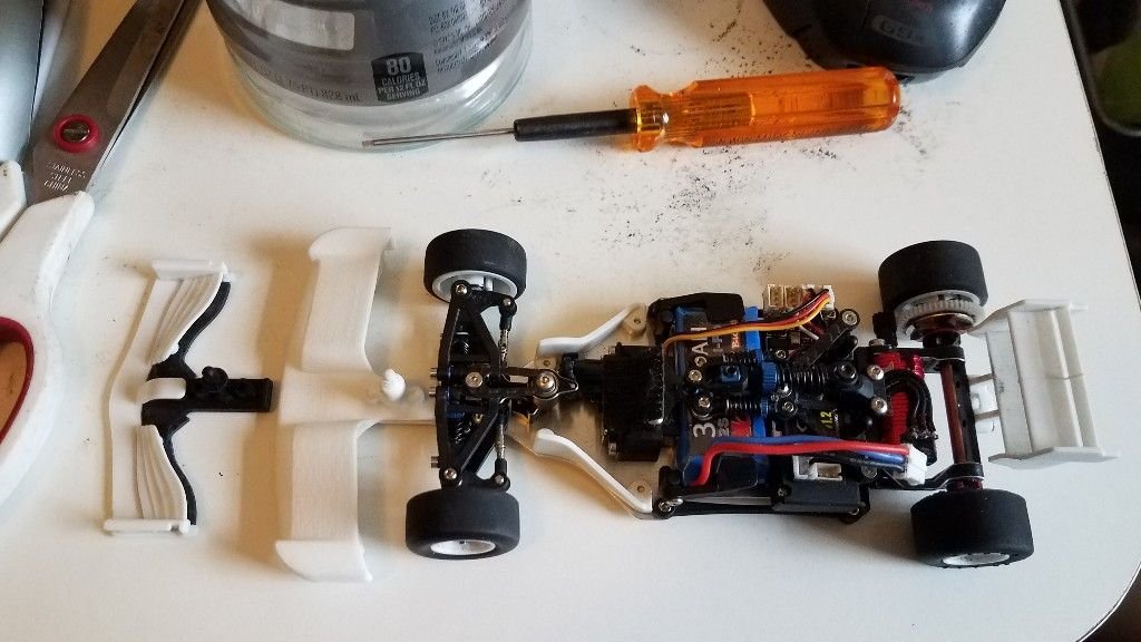

Originally Posted by art4242 View Post
Also posted this on FB, first prototype of 3D printed front wing using Tamiya mini 4WD rollers to keep from digging into or sticking on the rails. Drop in replacement.
This one's still modeled a little roughly but works well when I tested over the weekend. STL file is attached, exported units are in inches if they come out too small. I printed in PLA material on my home printer and have not had any break after multiple crashes. You do have to be careful to not over tighten the self-tapping screws compared to the molded plastic wing.
I used the smaller rollers from this Tamiya package:
https://www.amainhobbies.com/tamiya-...m15381/p734686
Hi mate, just print a few of your wings are they look really nice! But the carbon fiber part that you have to insert inside it, doesn't fit. Do you have the same problem when you print it for the first time?
Thank you!!!
Thank you!!!
Sorry to hear that. I think that the fit of the carbon into the wing depends a lot on the particular printer, material, and print settings you are using.
The exact outline of the first few layers of the material can be variable due to squishing on the build plate and if there's glue stick/tape/etc. on the build plate.
I designed them so they fit well when printed on my printer using PLA, even then I occasionally need to clean up the edges that fit near the carbon with a knife for a good fit.
The exact outline of the first few layers of the material can be variable due to squishing on the build plate and if there glue stick/tape/etc. on the build plate.
I designed them so they fit well when printed on my printer using PLA, even then I occasionally need to clean up the edges that fit near the carbon with knife for a good fit.
thanks my friend, Iíll try to print in on PLA then.

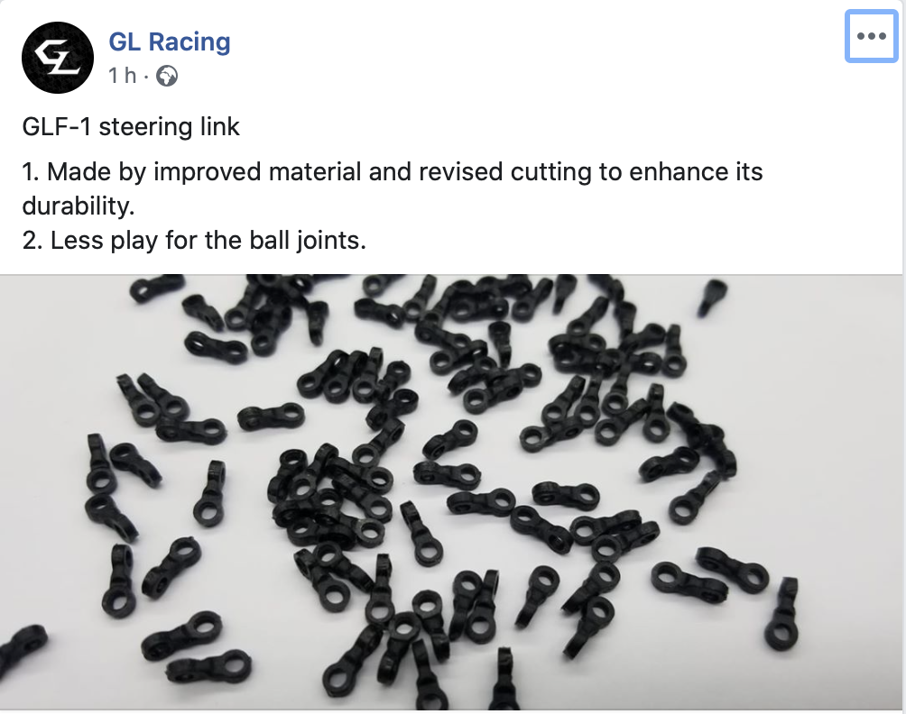

I think the car has real potential, but I just didn't have any luck with it when i was on the track in Detroit. New steering llinks are available, which should help most of the issues that I was having. My car was handling pretty good in practice, but just when I started to try to tighten the line or push the car a little is when I would bang and break.
I think if my front wing design were better, or the link held up, I would have had a different tone. Hopefully I can get more track time soon with it to work out some of the setup...
Thank you!!!
Hi, you must shave a bit the boarder of the wing a bit with a file, and it will fit.
Also the hose for the screw, i suggest to screw once first, unscrew and then install.
Follow this steps and you are good to go.
