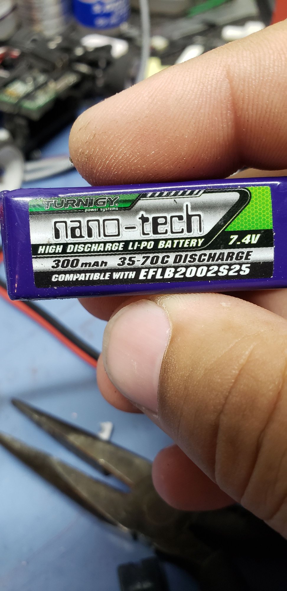

Dont know if it was mentioned or posted anywhere but this battery is a good alternative to the gl battery and only 6 bucks vs 15 for the gl and or 30mah less but it dosnt affect it much ran 15 min straight on a mini 96 track and it hit LVC at about 18 min mark. For 20 shipped I got 2 vs 30 plus shipping for the gl version

I use the Kinexsis 280's. They gave me three stints and a few warm up laps in the GLA so I would say just about 20 minutes with 10% left in the cells. These thing were like $6 each.
While I used Hobby King for years I finally got to the point where the PIA factor out weighted the cost saving......at the end more of my orders had issues then were correct and dealing with customer service was so so frustrating. With that said I happy to spend another couple dollars and not have to deal with that company.
