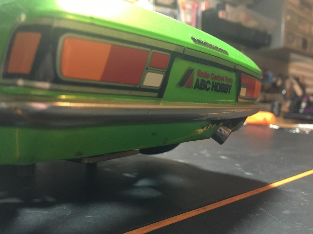

First of all, let me say I love the body shells made by ABC Hobby. They're as detailed as anything Tamiya has ever made, and in some cases the decals are better. They don't get credit for the red pinstripe running along the perimeter of the bumpers, though; that was all my doing, as I was copying a paint scheme on a real CR-X I found while searching images on Google. I spent about an hour slicing 1mm-wide strips of masking tape and sticking them to the inside of the bumpers, before masking the entire upper half of the body for the two-tone paint job. But the front isn't the best view of this body -- the rear view is:
The rear taillights and rear window are a single, full-wrap decal, and it just brings the rear of this car to life. There are even light buckets for all of the lights on this body -- headlights, taillights, foglights, corner signals, and even side signals -- though at present I don't have any lights installed. I've never installed lights on any of my nitro vehicles, because I don't run them at night anyway due to noise concerns, but this body looks so good I might make an exception. You can't see it from this angle, but the rear windshield decal has defrost-heater lines printed on it, though I cut out the left side of the rear windshield decal to make room for the rear vent hole.
Oh, and that chrome exhaust tip? It's functional.
I'm super proud of how the exhaust turned out. Every build has its challenges, and the biggest challenge with this build was figuring out how to route the exhaust in a way that didn't require cutting a hole in the middle of the rear bumper. I originally got a tuned-pipe exhaust made by Jet Racing, which had the outlet positioned over the rear-right wheel where a silicone deflector tube could route the exhaust out under the lip of the body, but that exhaust didn't work with the chassis in the short-wheelbase configuration. (as with all RS4's, the rear suspension arms are reversible to change the wheelbase length -- but unlike normal 1/10-scale RS4's, it's actually a useful feature on the RS4 Mini, because bodies for "Tamiya M" size cars are available in 210mm or 225mm lengths.) So I was stuck with the ancient airplane-style swirl-chamber exhaust. I took a trip to the auto parts store to look for tubing I could use to make a proper exhaust pipe for this car, and I settled on a package of hard-nylon fuel tubing. It came in two different diameters, which conveniently fit together so I could use the narrower diameter for the main run and the wider diameter for the end pieces. The hanger is just a piece of mild-steel wire from my local hobby shop, bent around my hex drivers to make nice round eyelets at each end. The chrome exhaust tip is actually a tire valve stem protector, which fit onto the larger-diameter fuel tubing with the assistance of a small bit of heatshrink to make it fit snugly. (every Honda Civic needs a chrome exhaust tip, right?)
