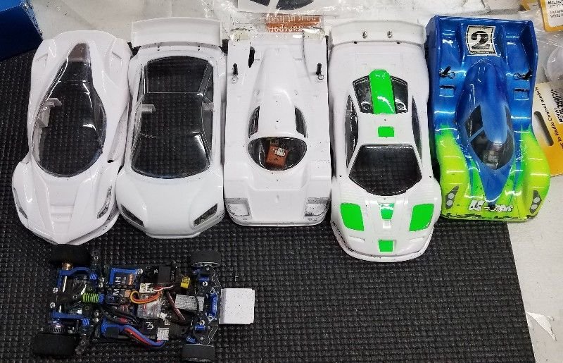

Originally Posted by ae4ever View Post
Finished with the GLR build and I should have ditched the 03 months ago. Now I'm looking for a hard body to top it with. I ran a auto scale 12c w/ lexan window on my 03 and don't have anything bad to say about it but most of the guys at the track run the jomurema GT01 body w/ lexan roof. What's the gotta have hard body now days?
Thanks,
There are a lot of variables, amount of power, traction and driving style definitely come into play with body choice. I personally like the way the 12C handles on the GLR. The jomurema is a good body, with a large setup window. It is pretty neutral with good balance, and shortish overhangs. It seems to do a lot well, but for me, I kind of prefer 12C for low to medium power with medium to high traction.
Here are a few bodies that I was testing with my last real test session... the surface was relatively low traction, so I did like the big McClaren because it tends to slow down reaction somewhat due to the overhangs.
The old R8 is also pretty good, somewhat similar in feel to the jomurema, but doesn't make as much traction.
I tend to prefer cab forward bodies, as I feel that they enhance the strengths of the GLR. I prefer to drive it on the front more than the rear, and the steering feel of the chassis I feel goes well with cab forward designs, or neutral cab.
