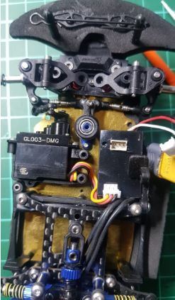

I had some issues with the DasMicro Rx as well, my theory is that it's shock sensitive. Once it takes too many hits it will start going wonky. I reinforced the PCB by encasing it with hot glue and then mounted it using foam on all sides. So far no issues after that.

Nice work there. How difficult a project was changing the connectors on the receiver? And should I get a different tip for my iron? I use the stock tip that came with my Hakko 936.
I had several glitches last night while running. So annoying. The last time my car was nosed into the track bumper with the throttle stuck open. My buddy thought I was doing it on purpose. ďJust warming the tires upĒ. Lol
The pins on the Futaba were a pain, I struggled to unsolder then neatly.
The fully decased one I just soldered directly the the pin contacts on the board.
The cased one with the jst connections I just trimmed the pins and soldered the connections to the pins.
Unless I was on competitive racer I would just solder the JST connectors onto the pins and leave it cased or just replace the jst connectors with the typical Rx plugs as itís only 1.3g heavier plus on the GLR I prefer the wide upper deck so more available room for movement to get the balance right.
Also even when you decase the R334 itís still not small enough to go onto the chassis under the top deck.

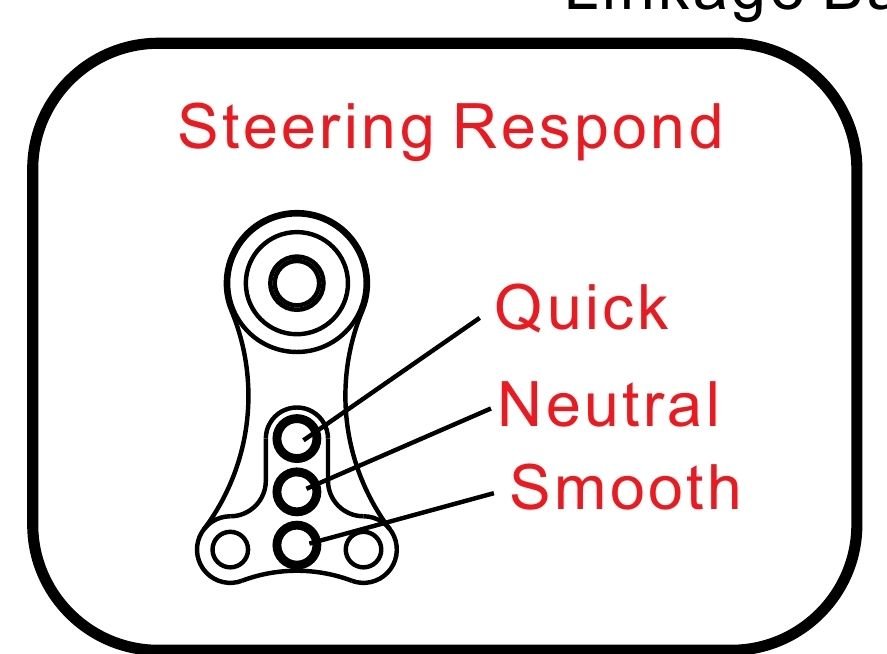

Did some more tuning on the car tonight. Ended up with a softer front and rear feeling best. Blue springs all over for now. The biggest thing Iím trying to fix is the steering on the straightaway being super twitchy. Not sure if twitchy is the best way to describe it. Seems like if Iím not pointed perfect down the straight any correction makes the car dart the way Iím turning the wheel. Iíve taken away close to all of the toe out in the front. Turned dual rate way down. Not sure about the servo saver. I built it carefully just like the manual says. Seems to function properly? Not really sure what to look for. Anyway, the car is a bullet with only a 3500kv Motor in it. Have the throttle epa at 75% and that makes it drivable on the small track I frequent. Waiting for KS super soft rear tires to come back in stock somewhere so I can try them. Running f type super softs on the rear now. Have -1* knuckles on the way also. More tuning on the way
I also feel super twichy too, I try to change the steering arm to be longer, please give it a try
b.wihardja is offline
I ended up cutting my end points way down, limiting the steering throw both directions. Night and day difference. Loving the car now. Itís so fast.
i think with the longer steering arm, will mechanicaly reduce the steering throw while add some resolution and precision
From your pictures, you have too much toe out. The car will be less twitchy with a little toe in. not much is needed
b.wihardja likes this.

Having so much fun with my GLF I grabbed a GLR! Pretty simple build, and while much tuning still needed, Iím loving how it drives. Two questions here. The manual indicates taping the esc in place, yet the esc has mounting tabs and the chassis has countersunk holes to attach it with screws. I found some appropriate screws and attached it. Seems great, perfectly aligned with zero interference.

Canít help chiming in on the longer arm topic. If you are all increasing the length of the arm on the servo itís going to do quite the opposite of what youíre expecting. It will increase, not decrease, mechanical throw requiring lower end point settings and ultimately reduce resolution. In a perfect world, at 100% epa you achieve, mechanically, the max throw you desire. Seldom achievable I know...
Well, maybe i was wrong in term of "long steering arm". What i mean is longer ball link connection on the steering crank.
Makes much more sense! My bad, didnít realize you were referring to the bell crank. Prolly should have looked closely at the pics.
