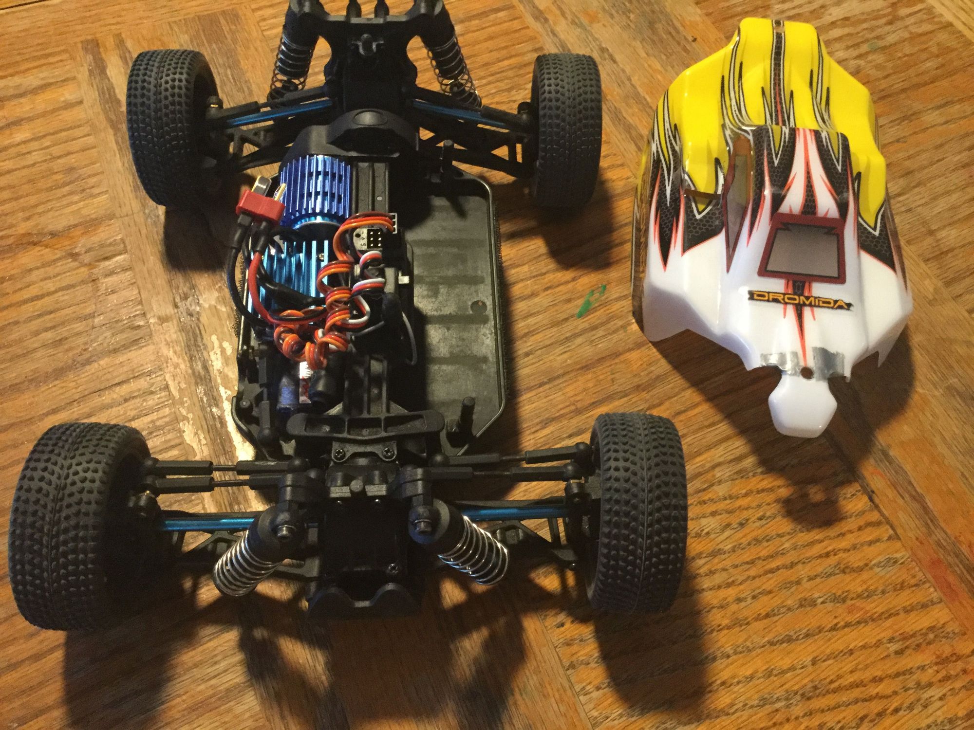

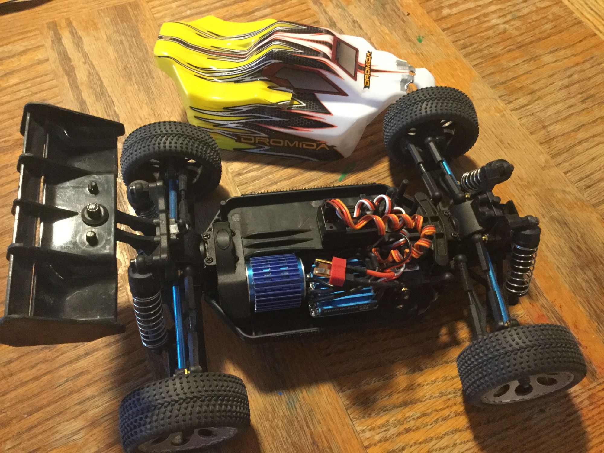

Hereís a couple pics of my BX 4.18. You can see the capacitor taped to the top of the servo. It came loose at first, but I cleaned everything with rubbing alcohol and it stuck pretty well after that.
The build is solid but nothing fancy:
Aluminum dog bones and axles
Plastic everything else
14T aluminum pinion
Generic 2430 7200kv motor
Generic 35A 2S/3S ESC
MG90D clone servo
All the mods from the mod thread

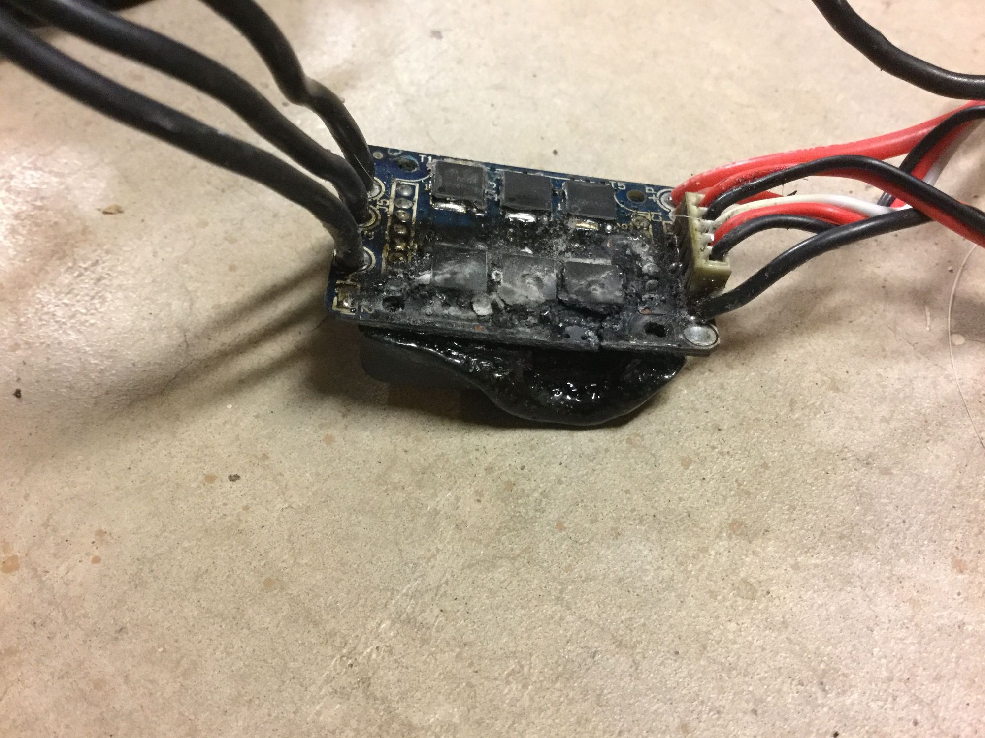

Generic 35A ESC update
The generic 35A 2s/3s ESC started on fire today, after a handful of full-throttle 3s passes up and down the block. This was after installing a smaller pinion to lower the top speed a bit and keep all 4 wheels on the ground!
Motor temperature was about 220F -- too hot for long-term health. I usually run on 2s (which is much cooler) so I'm not too worried.
ESC temperature had never been above 120F before, so I think one or more of the FETs must have failed and burned up.
Starting to look around for an affordable ESC that will handle occasional abuse running a high KV motor on 3s. Dunno if I'm going to try another one of these generic ones, or step up to something better-made.

Join Date: Jan 2018
Posts: 36
Yeah, a little piece of rubber hose on the shock shaft acts like a real stiff spring that kicks in just before the chassis slaps the ground and cushions it. On a 1:1 car theyíre set to prevent the chassis hitting the ground at all, but on the little dromida itís good to have it still able to contact the ground after compressing the rubber a bit.
Tested my motor and I think one of the windings shorted. With a good esc it just wiggled back and forth and got real hot real fast. So I think the motor went first then took the ESC with it. Going to try the Carisma sensored 5350kv motor next. Iíll post about it when it comes. :-)
