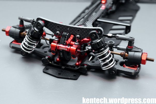

Did a build review of the D10. Check it out if you're interested:
https://kentech.wordpress.com/2017/1...edition-build/
http://www.facebook.com/blogkentech/
